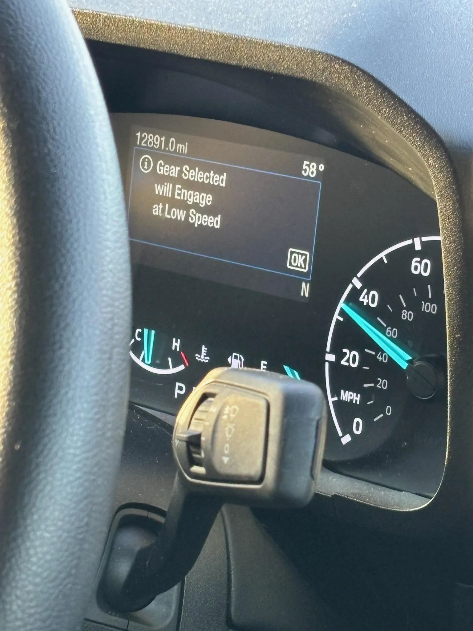

Just had three recalls done today, 24c01, 23c41 & 23e09. About an hour after leaving dealer lost power, barely got to a place to pull off highway. Shift knob was flashing, warnings started flashing, hill start assist not available, service soon, pre collision assist not available, service advance Trac, and parking brake applied automatically. Called the dealer and they were perplexed. After about 5 minutes & turning ignition on & off I got power back. A '23 XLT Hybrid, 1 year old, 7500 miles. Maybe best not to do recalls !! I see others on here with the same outcome after recall fixes. I had told service guy how much I liked my Maverick but noticed in this forum quite a few complaints. He replied if you get a good one they are great but are plenty that aren't so great. After waiting almost 2 years and now this..... Come on Ford, don't tell us to get a recall when it makes matters worse & potentially dangerous. Check engine light still on but was not able to pull any codes, leading me to believe will go out on its own, but will this continue to happen ??
