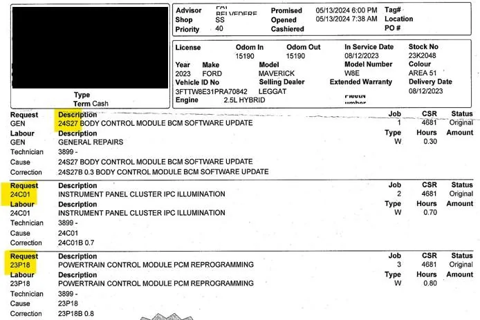

2023 Hybrid, built 1st week of July 2023. 15,000 km / 9,300 mi. Toronto, Canada.
Three updates done this morning:
24S27 - BCM Software Update (tail lamps)
24C01 - IPC Software Update (instrument cluster backlight)
23P18 - PCM Reprogramming (DTC P2282 - TB Air Leak)
Going to give it a good 150mi rip tomorrow and see how it goes. Haven't had any problems since I took delivery in Aug 2023. Fingers crossed this latest ver of the 23P18 is stable and solves the NTHSA 23V26700 "Loss of Drive Power from Undetected Low Battery" problem... although I have NOT experienced it.
(Interesting to me: Service tech warned me these updates may span days; he had seen the 23P18 PCM update take 14h... so I was prepared to leave it overnight. He called me 2h later saying it was ready to pick up. *shrug*)
As mentioned, 150mi mostly-highway today and nothing to report. Flawless... so far.
