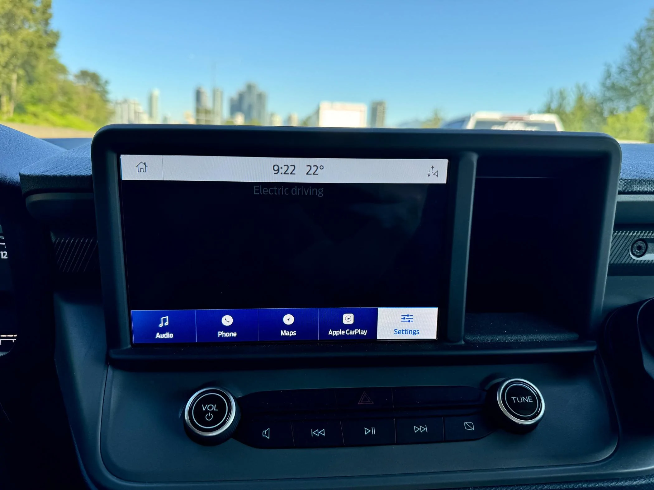

Can you confirm that your power flow screen works still or is it blank like the picture I posted?
I looked under settings and couldn’t find power flow listed. Is it up under something else?
This is interesting. I had the 2 recalls done last month without any issues. Last week, while I was driving my passenger was trying to navigate on the screen, we came upon this power-flow screen which I had never seen before. (We are both not very tech-strong) This power flow screen is a different representation of the information of the "EV Coach " screen. The latter being more helpful in actual driving anticipating using the throttle most effectively. The Power Flow does not help you here. I was really very pleased with Mav during my first encounter with HEAT in this vehicle. It has the best A/C I have had in any car. Additionally the ENGINE (ICE), only idles when necessary to keep the batteries charged. I was not anticipating this money and environment saving feature when I bought the truck :)

Hold the radio power and track skip forward at the same time to reboot the unit, see if that brings it back

To access the Power Flow feature, you can access by pressing the lightning bolt on the homepage
Not sure what the power flow page is for but I found it.
I found the page. Not sure what it’s for but it’s there.
Yeah yours works just fine so I am not sure what is causing this for some lariat owners. Maybe a reset can fix the issue.
YES no problems power flow is working great
