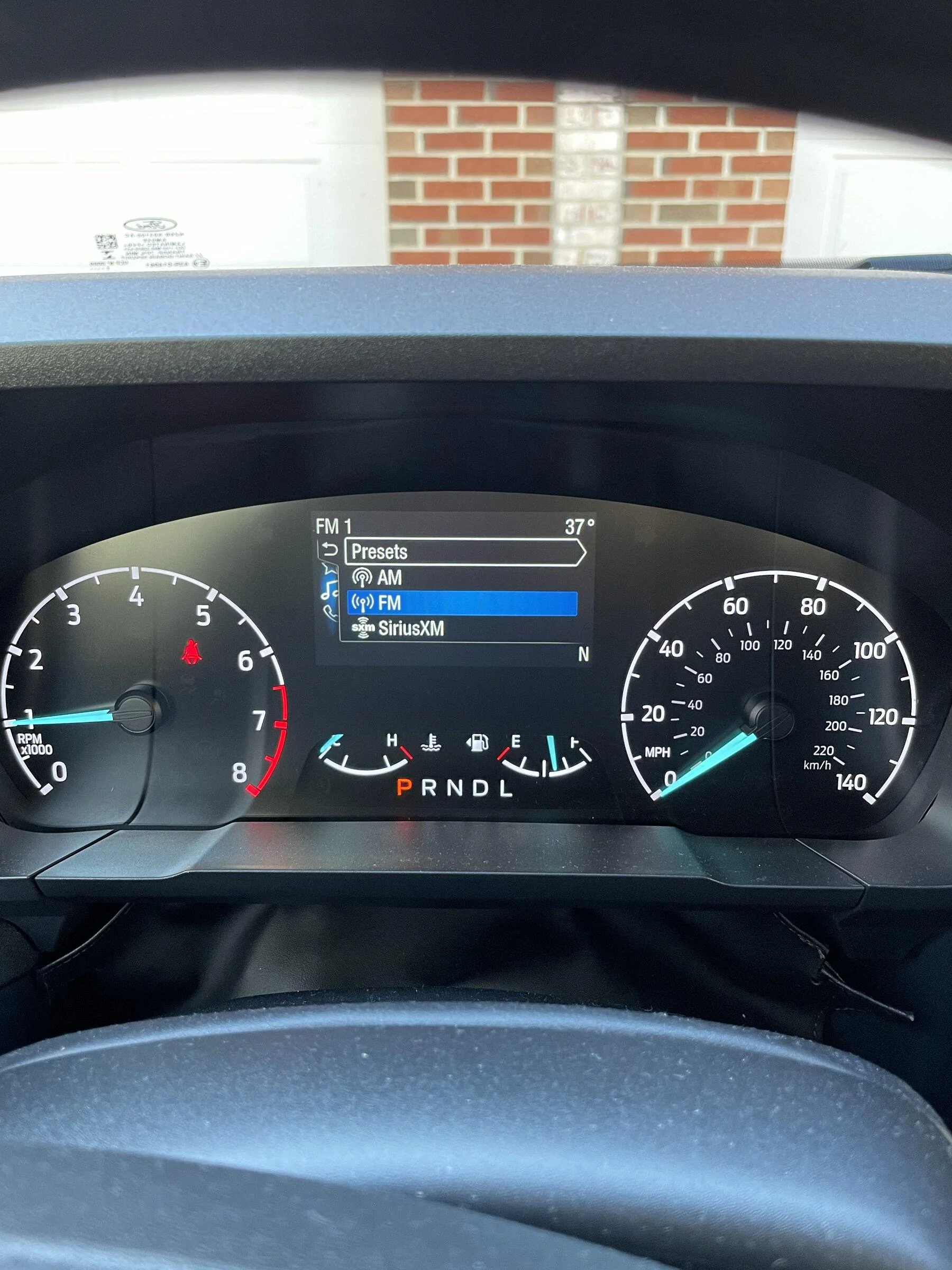

Latest update. Camera works. Sirius works. I had wireless carplay working then it just stopped for some reason. It wont let me enable to the app projection which is needed for that.
Two other issues that Im having some trouble sorting out. When using the steering wheel to scroll presets it skips the sirius channels and sirius wont display on the instrument cluster. I think both of these are related.
I ran out of time for today and Im going away for the weekend so I wont be able to work on this until monday. @zackmd1 I hope you have a little better luck than I do this weekend. Id say Im about 90-95% done and this is ready outside of the three issues I listed.

Ok latest update. I think the steering controls skipping Sirius channels is because the subscription isnt active. The reason I believe this is because when you first turn on the truck it will go through all presets no problem including sirius then it will stop. So then I tried to use the voice controls to see if it would tune to a sirius channel and it just gives me a response that my subscription is not active and just goes right back to FM.
After lunch today I am going to activate the radio. I can only call to do this so its going to take some time. I tried to enter the radio info on the website and it wont work. If the subscription being active fixes this issue then this is working as good as I need it to.
The only issue I have yet to sort is wireless carplay. I have Customer Connectivity Setting enable in the AB but it doesnt make a difference. Its weird because this worked for about two hours the other day and then just stopped and I cant figure out what worked before and what doesnt now.

My suspicions were correct. I activated the radio and it works. I can cycle through presets. The only issue is the now playing for Sirius isn’t show on the instrument cluster. CarPlay and fm do. I don’t know why. Camera works as well. This is working good enough for me at the moment. I can button up the asbuilt going forward to fix some things here and there.
I had this problem once happen on my unit (unmodified Lariat Lux Sync 3). I had to reselect something else to take its place on my instrument cluster. I then hard rebooted my stereo. Turned off the truck. Waited 30 seconds, restarted. Reselected Now Playing back in the instrument cluster. Profit.
Never had the issue again. Could be completely unrelated to what you've got going on. But worth a try. Good luck!

I hard rebooted both the cluster and the APIM and neither worked. Im not sure what setting im missing but someone will find it sooner or later if I dont. I can live without the instrument cluster since the radio is only a foot to the right.
