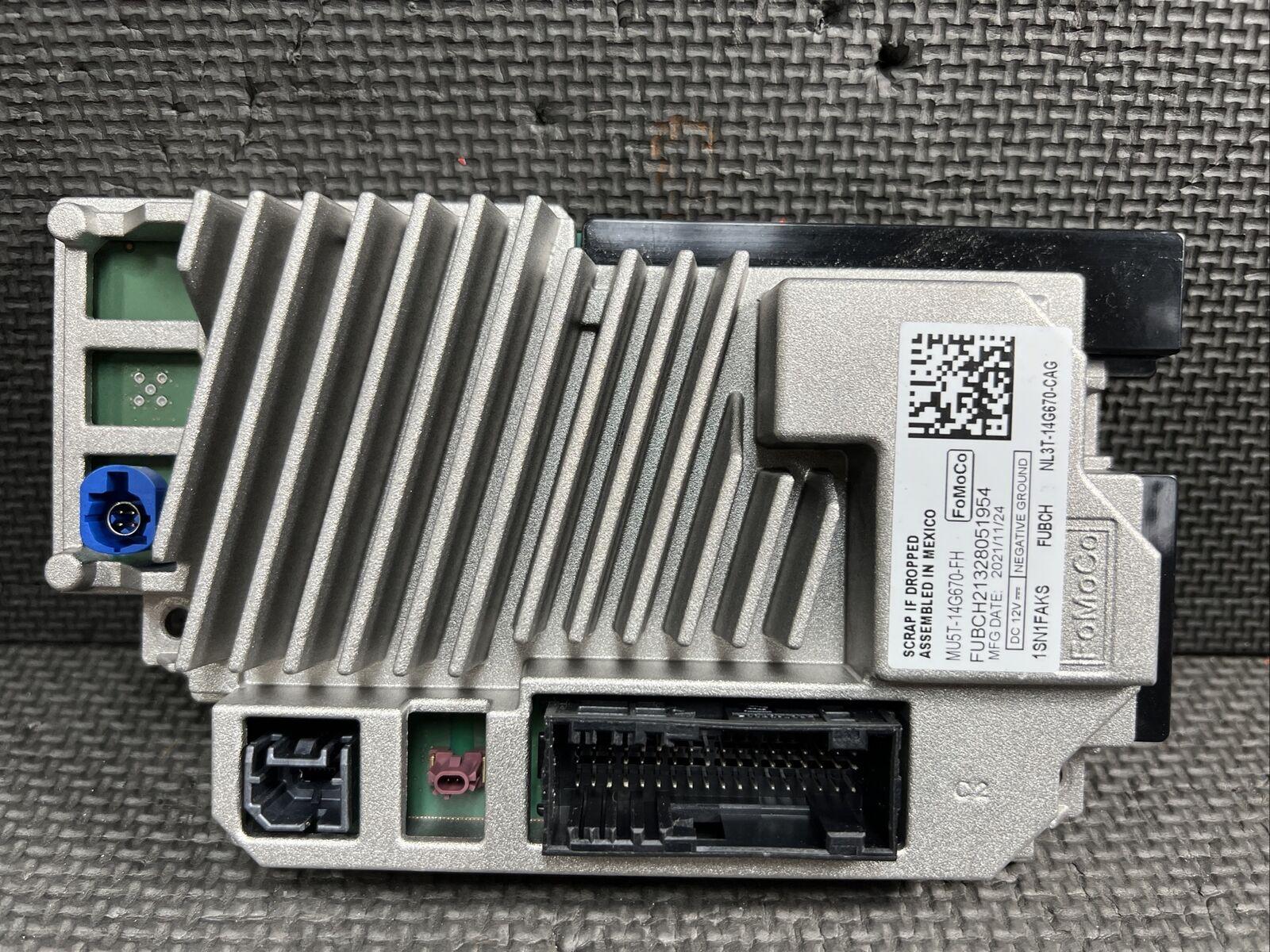

Ok, its 4+ years removed from when this was first conquered, but I too have completed the Sync-4 8" conversion in my XLT. As of last night I had corrected the last of the bothersome effects (e.g. Bronco splash screen, a handful of DTCs including lost communication to Parking Module A, no ability to change the door keypad, etc.) I can officially report only one DTCs (satellite antenna circuit open), HD radio fully working, Ford Pass app connected, Map tracking to GPS, audio content for all sources on the IPC and wireless AA working. Nice companion piece to the upgrade of the Lariat cluster with the larger screen, and the homelink enabled LED mirrored visors. Cyanide Labs' as-built database for all the modules is s huge resource.
For anyone interested I used a APIM from an F150 MU5T14G670FBN and an ACM M1PT18K810DB from a Bronco Sport. I bought the OEM+ Sync 4 conversion Harness just to save the time which was worth more to me, and the Ford APIM bracket listed in this thread (which by the way is not the correct P/N for Maverick- it's the part number for the Escape) after modifying it.
As to the lack of SXM radio, I've decided the antenna was bad out of the package, as others have mentioned issues with the one recommended in the first post of this thread had given them problems too. I've ordered the alternate listed later in the thread to see if it works better. All in I um just under $450 not counting my time and lost hair.
The last thing I need help with is someone with a 26 XLT ecoboost that is willing to share their stock APIM as-built so I can check the APIM X/Y/Z angles and other vehicle specs/dimensions stored in 05-02, 05-03, 06-01, 06-02, 07-01, 07-02, 07-03 and 07-04. I'm just not sure the as built data in the 2nd post of this thread has all of this accounted for.

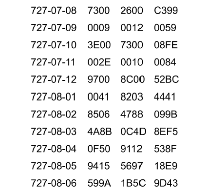

Hi, I have tremor 25 sync4 asbuilt, I used to programm my retroffited mustang apim and all is working ok. I will share asap.
Br

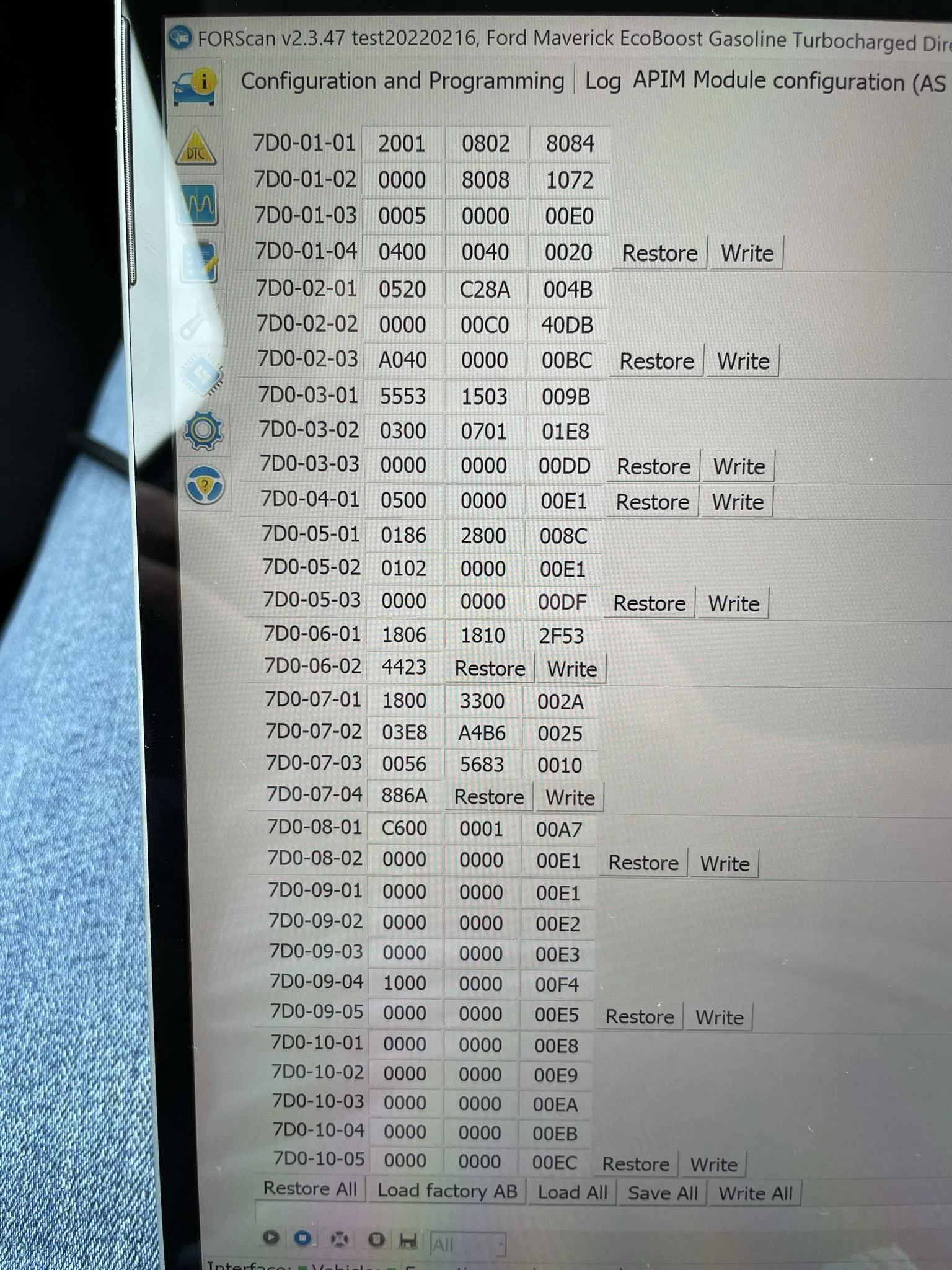

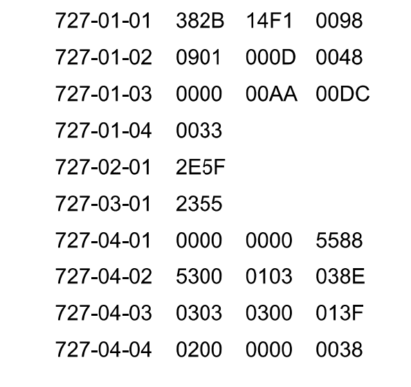

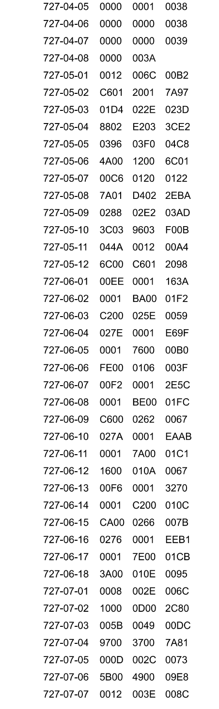

So I went lurking on auto trader and found a VIN for a 26 XLT 2.0 FWD, and made an assumption that the 22 to 26 dimensions, track, weight, tire diameter, etc. are the same. I downloaded the full as built config from the ford website. I also assumed that the APIM mounting angle in the 26 match the escape bracket I modified. Below are the mods I will make to the as built shown in the second post of this thread and test them tomorrow. I'll come back and report if I have any issues as a result.
7D0-05-02 0000 00C6 24C8 wheel tick freq GPS Mount Vehicle Lgth
7D0-05-03 442A 0000 004D Vehicle Height
7D0-06-01 1874 18C4 296F Front Track Rear Track Wheel Base Cont’d 06-02
7D0-06-02 AE8D 0000 0000 Wheel Base
7D0-07-01 1700 3300 0029 Vehicle Weight
7D0-07-02 0000 5EA1 00DF IAAPIMAX IAAPIMAY IAAPIMAZ Cont’d 07-03 (X/Y/Z angle of APIM)
7D0-07-03 0056 567F 000C WTRF WTRR Tire Circ DIP (IP to Rear Axle) Cont’d 07-04
7D0-07-04 886A 0000 0000
So 3 solid days with the above update with no adverse effects or trouble codes. I replaced the SXM antenna with the later recommended 2 piece solution, and the SXM trouble code stopped, and the error on the satellite radio screen saying antenna problem. I'm declaring this one conquered.
