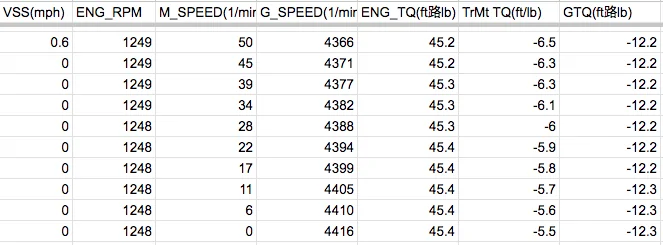

Is the RPM really constant on the ICE during those times?
During warmup, mine is jumping around 25-75 RPM, at minimum.
Now, that may sound smooth, nothing audible about it changes really.
But since the ICE is connected to eCVT - the Generator Motor has to be spun an exact ratio RPM (3.52?) to match the ICE RPM to cancel out any torque effect.
That's what it does in Neutral & Park & Reverse, and Drive stopped with brake pressed - no torque given to wheels until brake pedal is released. Traction Motor can supply that pull against the brakes for the creep.

So the trans "engaging" is all about the Generator Motor RPM matching the ICE RPM correctly.
The RPM being off by 50 the wrong way would have some ICE torque delivered to the wheels.
I'd guess the safe direction is if it's going to be off some RPM, make sure it's the correct way.
If stopped and brake held the Traction Motor shouldn't be involved - if it is receiving signal to spin that's a big problem - and should be easily seen in logs.
TCM logic telling the GM how fast to spin could indeed have had an update - should be interesting to observe.
The only other thing between ICE and eCVT is a damper to smooth things out - which I'm sure should make it easier for the GM to nail the correct RPM range.
We've had posts about that getting replaced under warranty.
Had a post about a driver running thru a seating process for it from his old car days. Worked IIRC.
Good point about them testing it in warm garage bay when it needs cold to be more apparent.
