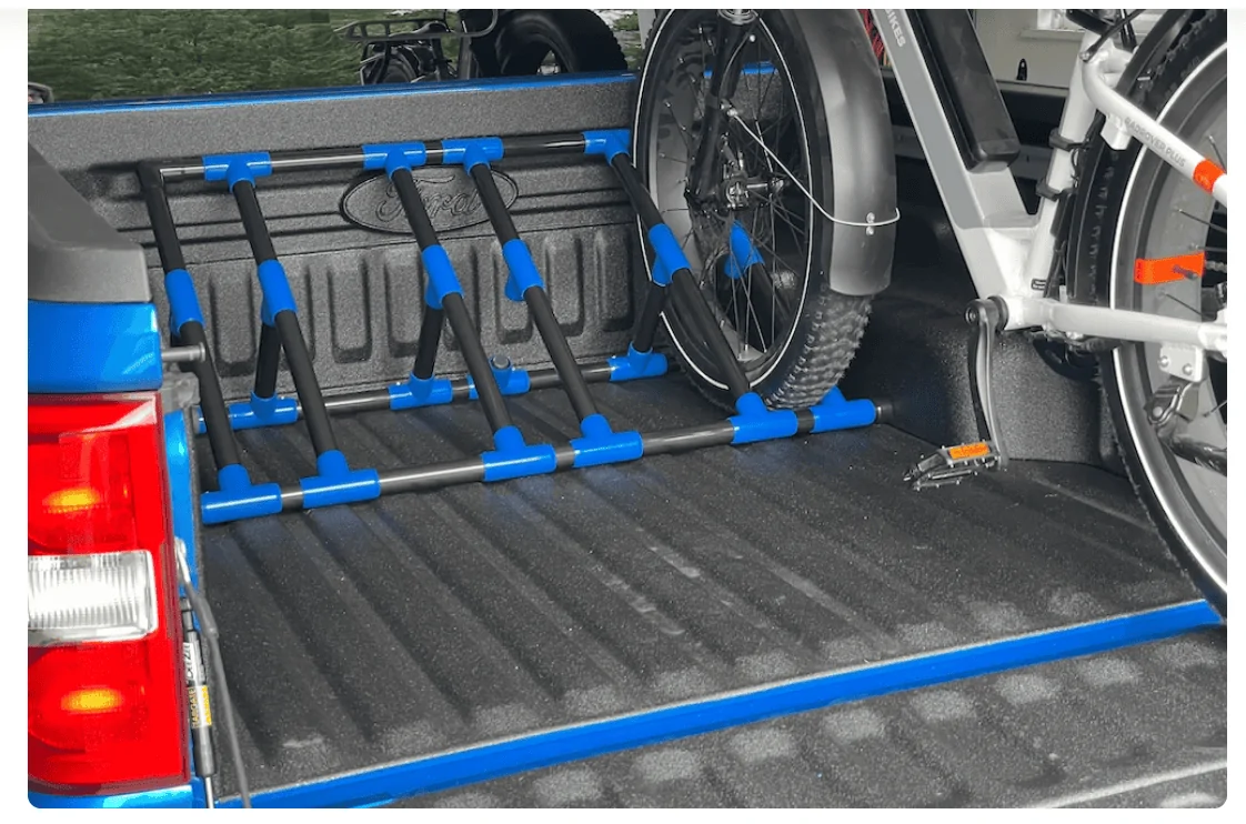

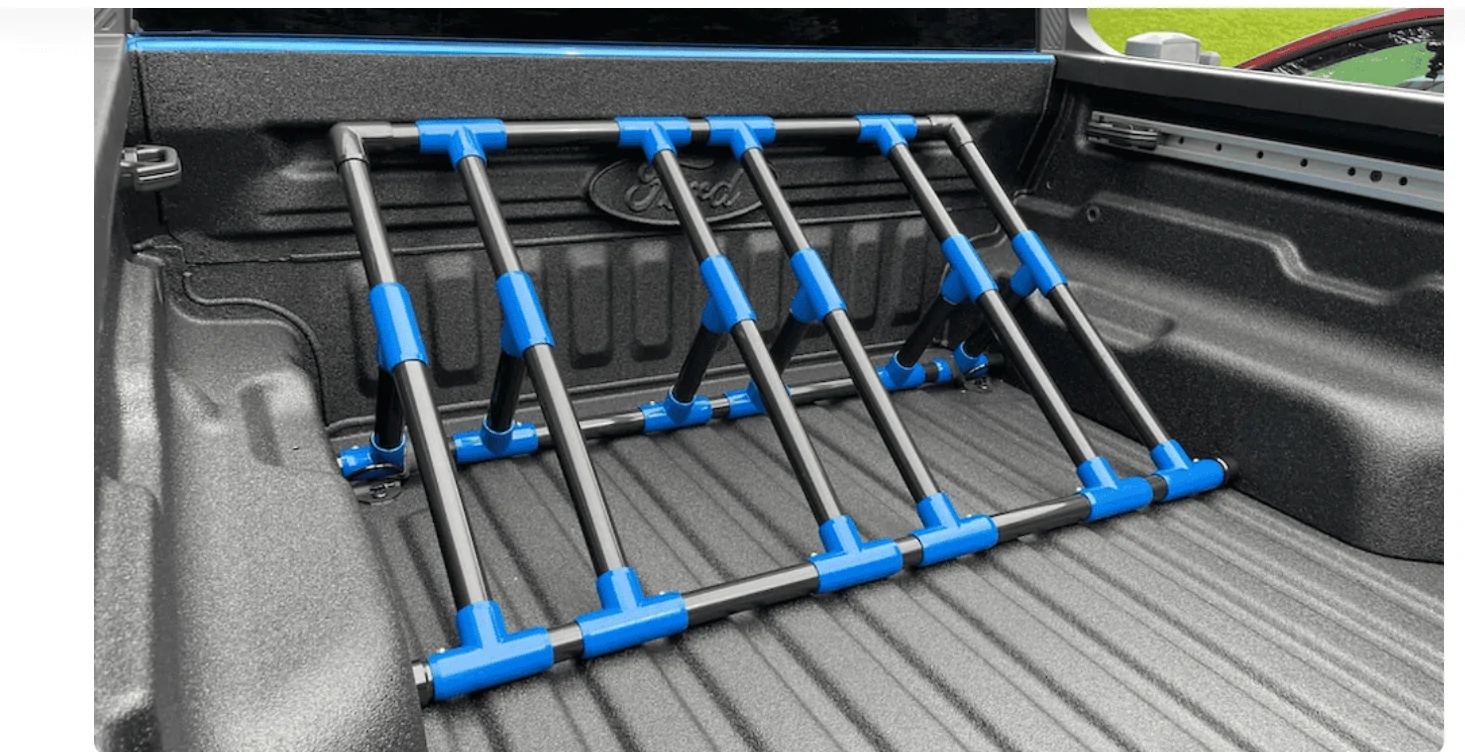

I like this idea myself.
https://formufit.com/blogs/news/build-a-pvc-truck-bed-rack-ebikes

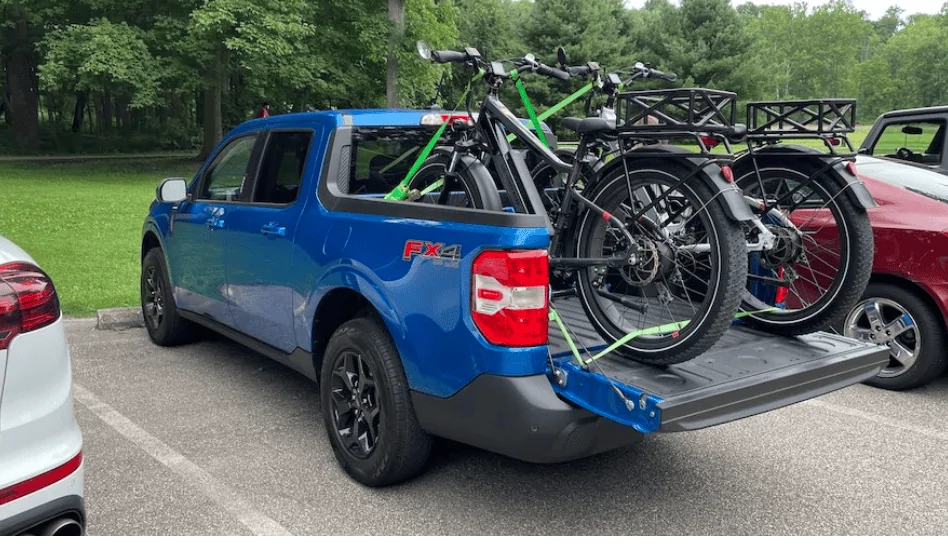

85 pounds is an extremely heavy e-bike so I assume you're going to want a ramp like you would need for a dirtbike and to load them directly in the bed. I am not aware of any bicycling hitch racks that are rated for that kind of weight. (I have seen single dirtbike hitch racks like that, so it's possible I am wrong and something does exist.)
At that point then, yes, a front tire rack like picture above is very helpful and you will want to use ratchet straps. Use at least 2 per bike, and going back to my MX days I would feel a lot better about 4 per bike.
