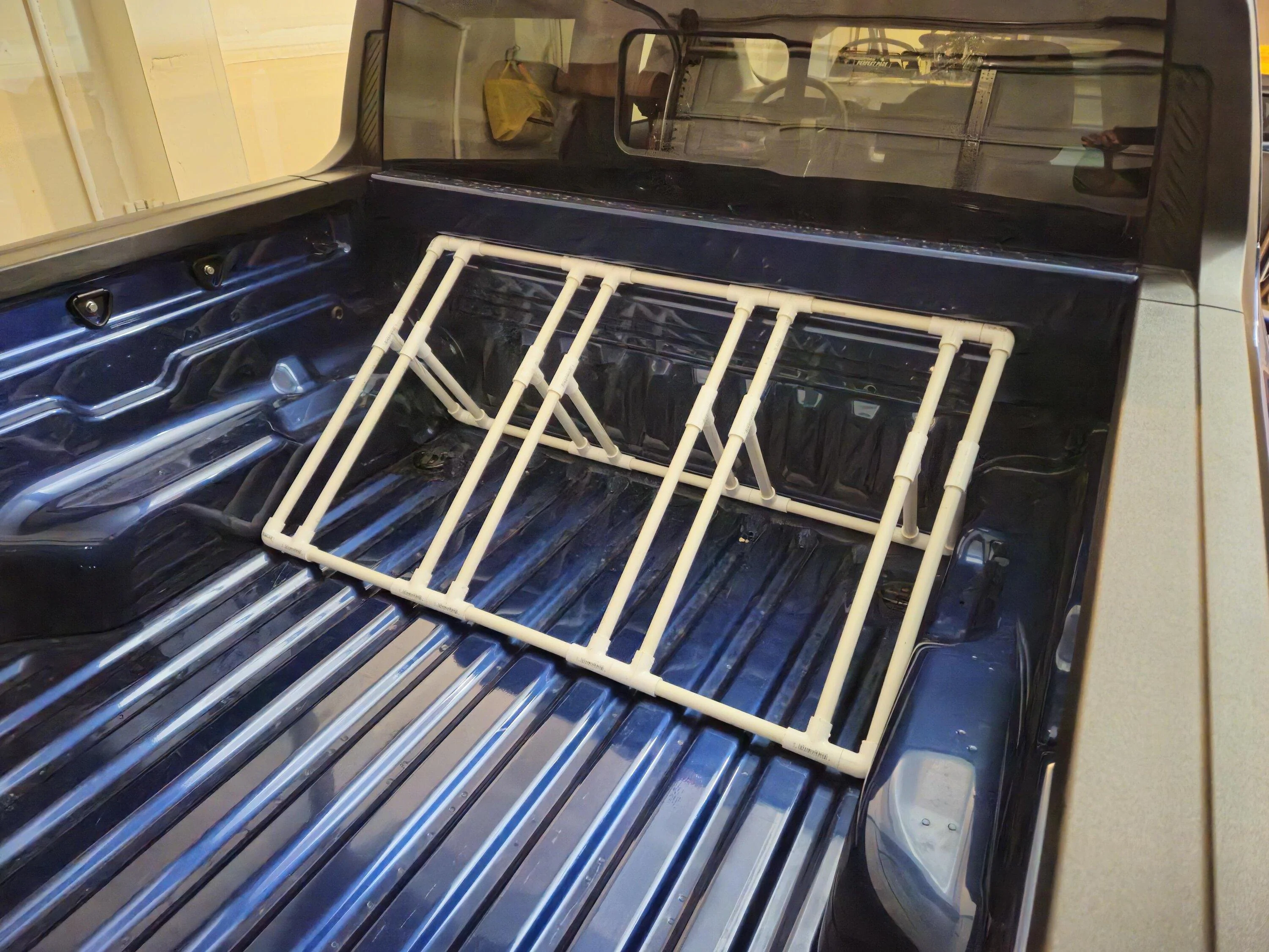

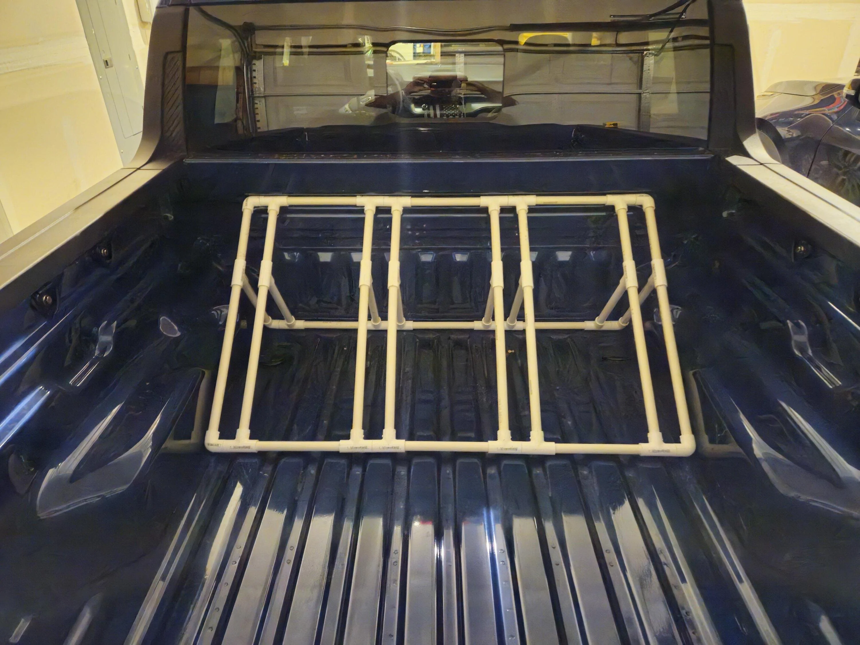

Nicely done! How did you make the bike rack and what's holding it to the front of the maverick?
Thanks.
I used 1/2" PVC pipe with slip fit 90° and "Tee" fittings. Glued it all together once I got the proper fit.
No need to secure the bike rack to the bed. It's only there to hold the bikes upright. When I secured the bikes down with straps, the downward force on the bikes holds the rack down as well. I take it out and put it in the back seat while we're riding, that way it doesn't get stolen.

Any pictures of the rack without the bikes? I'm trying to figure out if you have vertical braces on the back side. From the pictures, I can't see them and it just look like the tops are plugged and rest against the top rear corner.
Hope this helps.

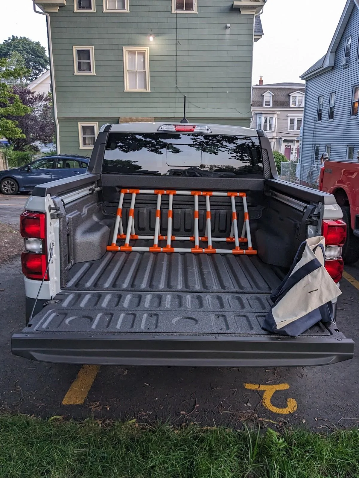

I built a very similar 4-bike rack for my Maverick's truck bed as well, also using PVC! I just took it for its maiden voyage fully loaded this past weekend for a bikepacking trip in New Hampshire. We were even able to keep the majority of the bike bags on which was very convenient. Bikes definitely had to be staggered front to back but I was pleasantly surprised at how well they all fit.
If anyone else wants to build their own, I based my build off these plans I found online, made specifically for a Ford Maverick: https://formufit.com/blogs/news/build-a-pvc-truck-bed-rack-ebikes
I made adjustments to those plans and 1) used smaller diameter pipe and 2) built 4 tire slots instead of 3 slots, since the person who made those original plans built them around much thicker tires than I'll ever transport in my truck. It was pretty straightforward, the most time-consuming part was gluing everything together once it was all measured and cut and test fit.

Looks great! Pretty much exactly the same. I used 90° elbows on the 4 bottom corners so it would fit flush against the side, but same same..
I really like how when the tail gate is in the half-up position, it pushes the bikes forward into the rack. and holds them in better.

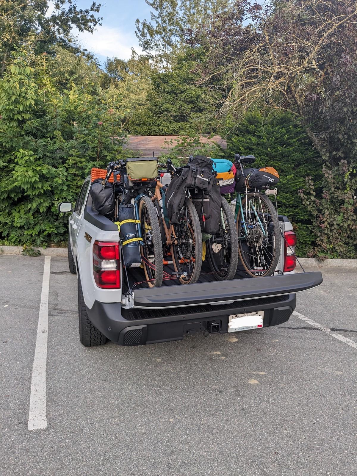

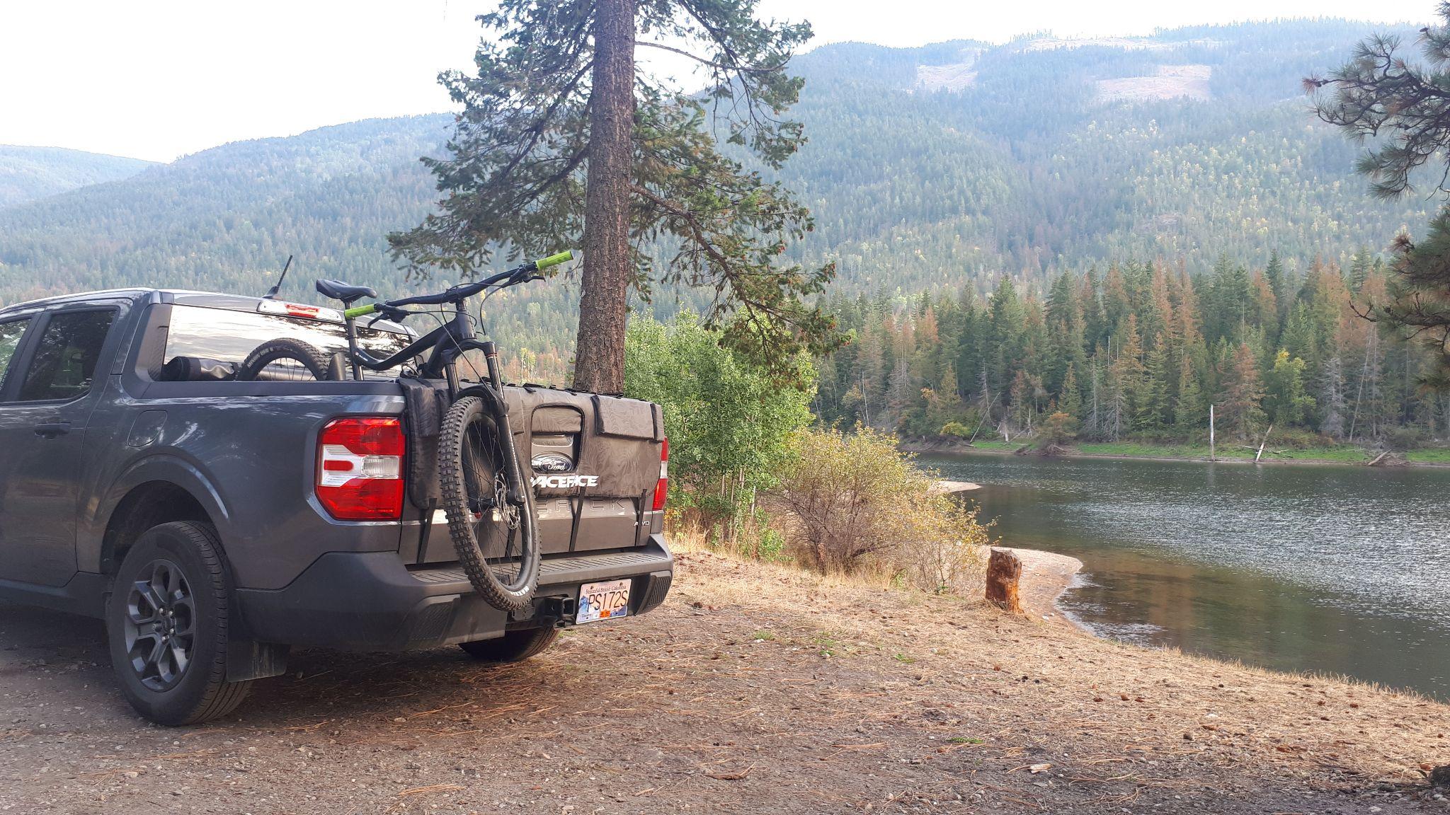

I have the Raceface T2 with a Truxedo X15, works fantastic.

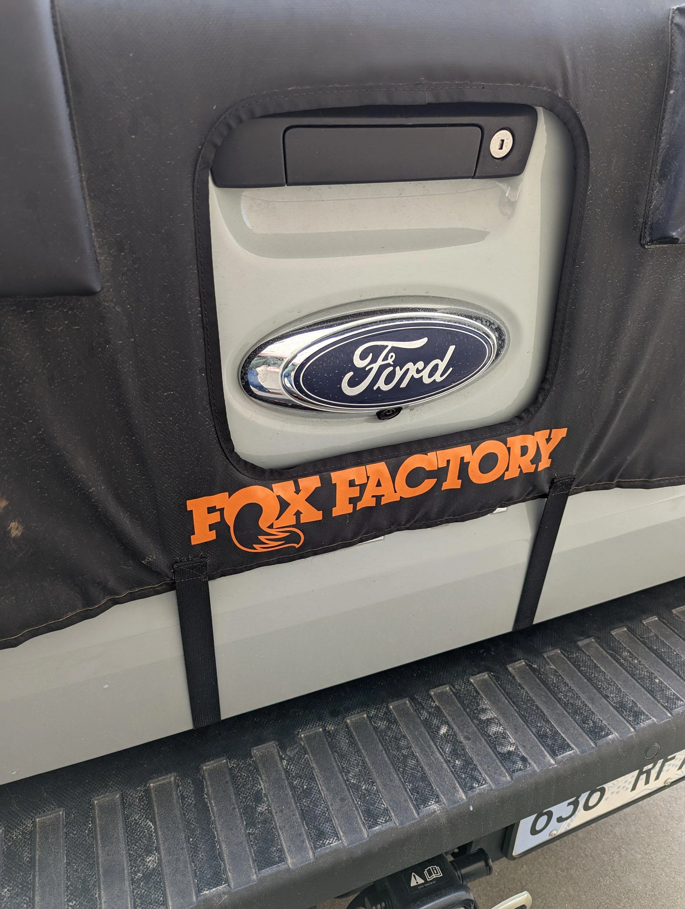

looks like you're blocking the rear view camera? my fox has inserts to fill the gap where the tailgate handle and camera are, but I don't use them. if I pull the pad down a little bit, just rearward of perfectly centered on top of the tailgate, I can see out of the backup camera normally with no bikes, and fairly well with 1-2 bikes if I angle the tires outward like you have done. (passenger side pointing the other way.)
