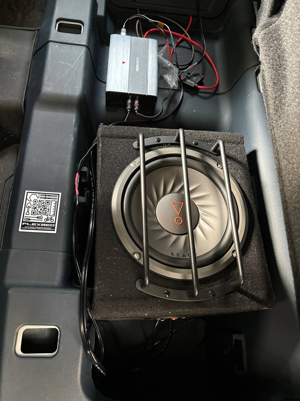

@DrNoobNStein hooked my subwoofer up pretty much like you tapping into the rear pillar speakers. But not much sound coming out of the subwoofer. Any suggestions?
Ford Maverick Subwoofer install using rear speaker wires, no cutting or speaker panel removal IMG_1869
