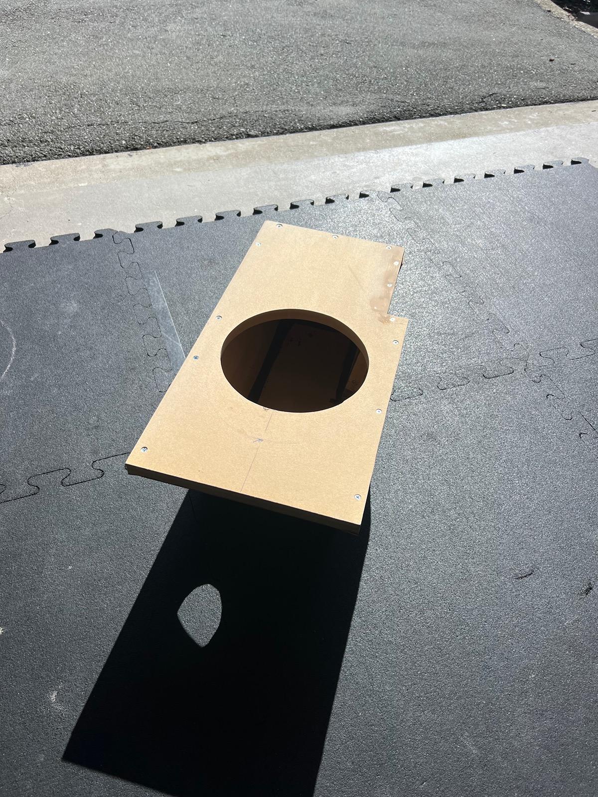

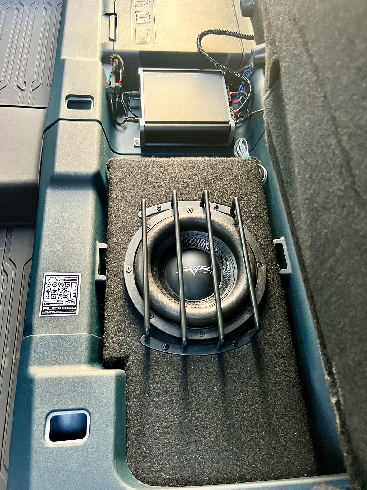

I couldn’t justify purchasing a custom subwoofer box for $250 through ground-shaker.com. Instead, I built this for around $60.
The angles were a bit of a pain, but in the end it was well worth the time and effort.
Roughly 40 cu. ft. with an 8” Skar VD-8 D2 subwoofer and Kicker cxa400.1. Wire harness was from plugnplaykits.com (kit 28) and I wired the REM by way of taping into fuse #3.

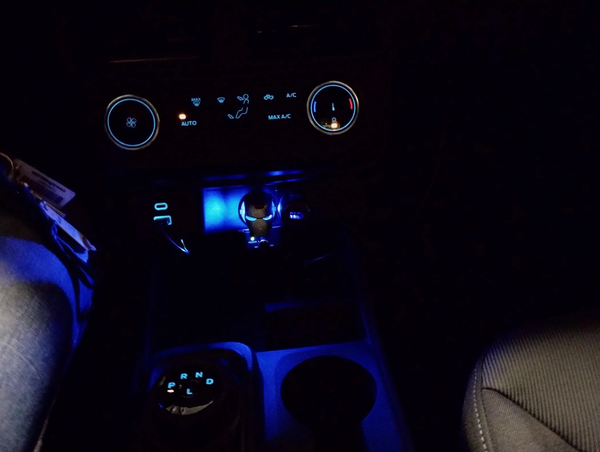

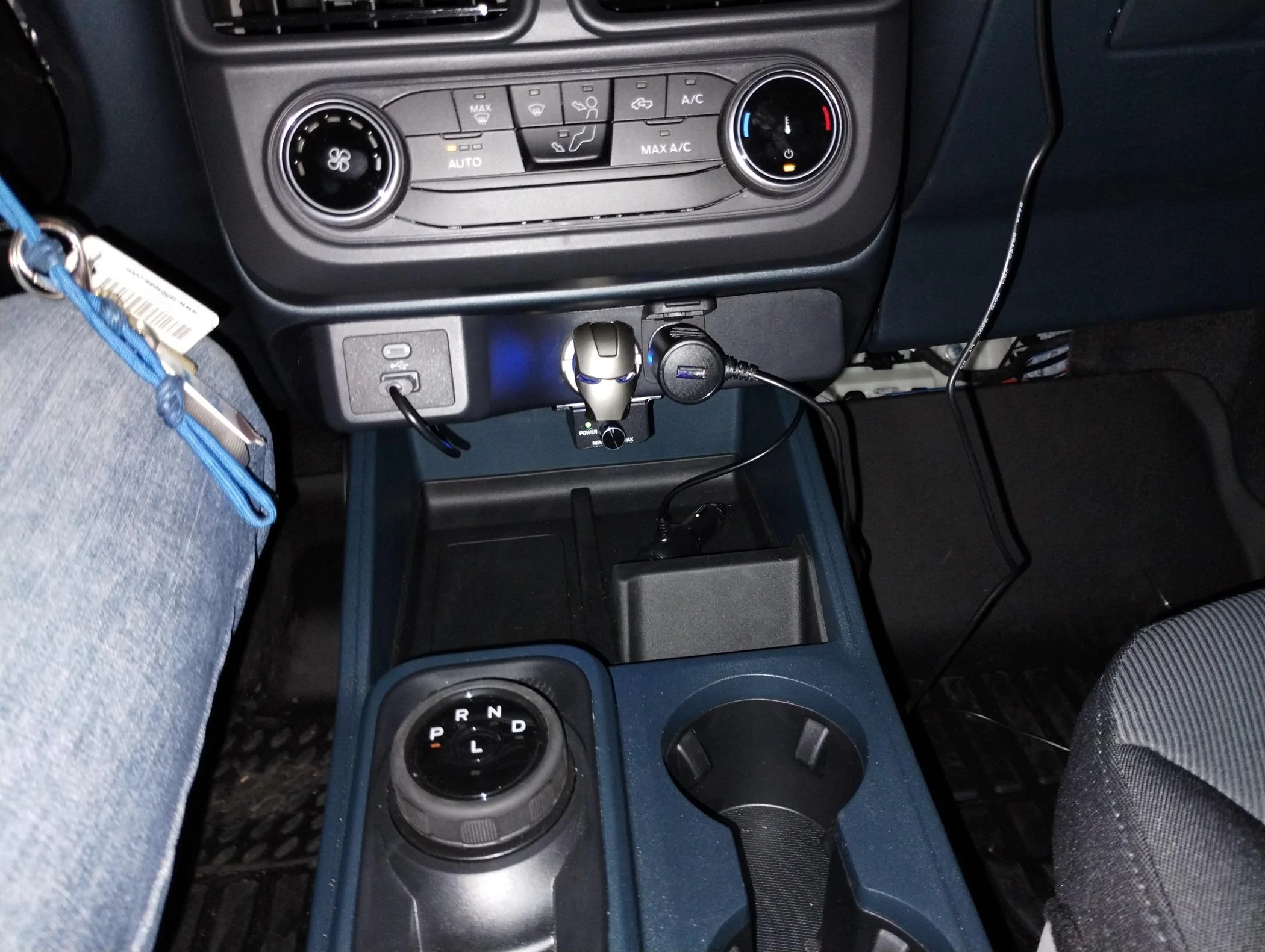

I used 3m command strips to hold a 3/4" stiff foam pad to the plastic. Then the same strips to hold the sub to the foam. Strong yet removable and insulates the plastic storage area from vibration. No rattles, well from the sub anyway 🤣. Plenty of noises at highway speed but I've never had a fancy car. The sub takes care of the rattles 😉, thump drowns out the rattles and wind noise.
I wired the remote to the aux cigarette lighter power but also added a cutoff. Found the cutoff to be too bright at night and then added a button cover my kids find even cooler than the blue button.
