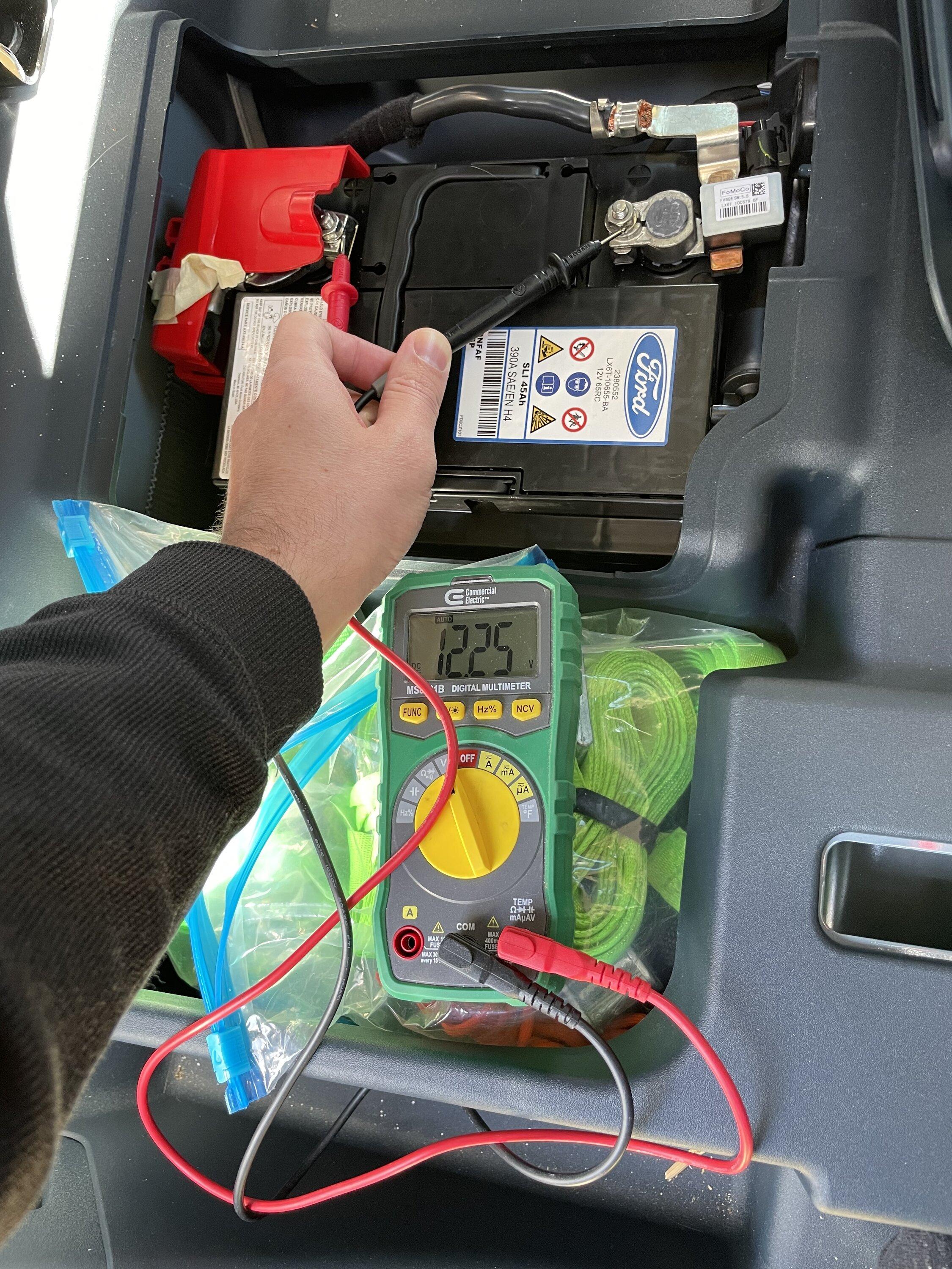

clavicus
clavicus
Jun 21, 2021
1,483
2,050
Looks like your battery is low, you might have to charge it then try the reset.
Its frustrating, I know..............................................
I have a multimeter and battery minder, I’ll see what the resting battery voltage is at.

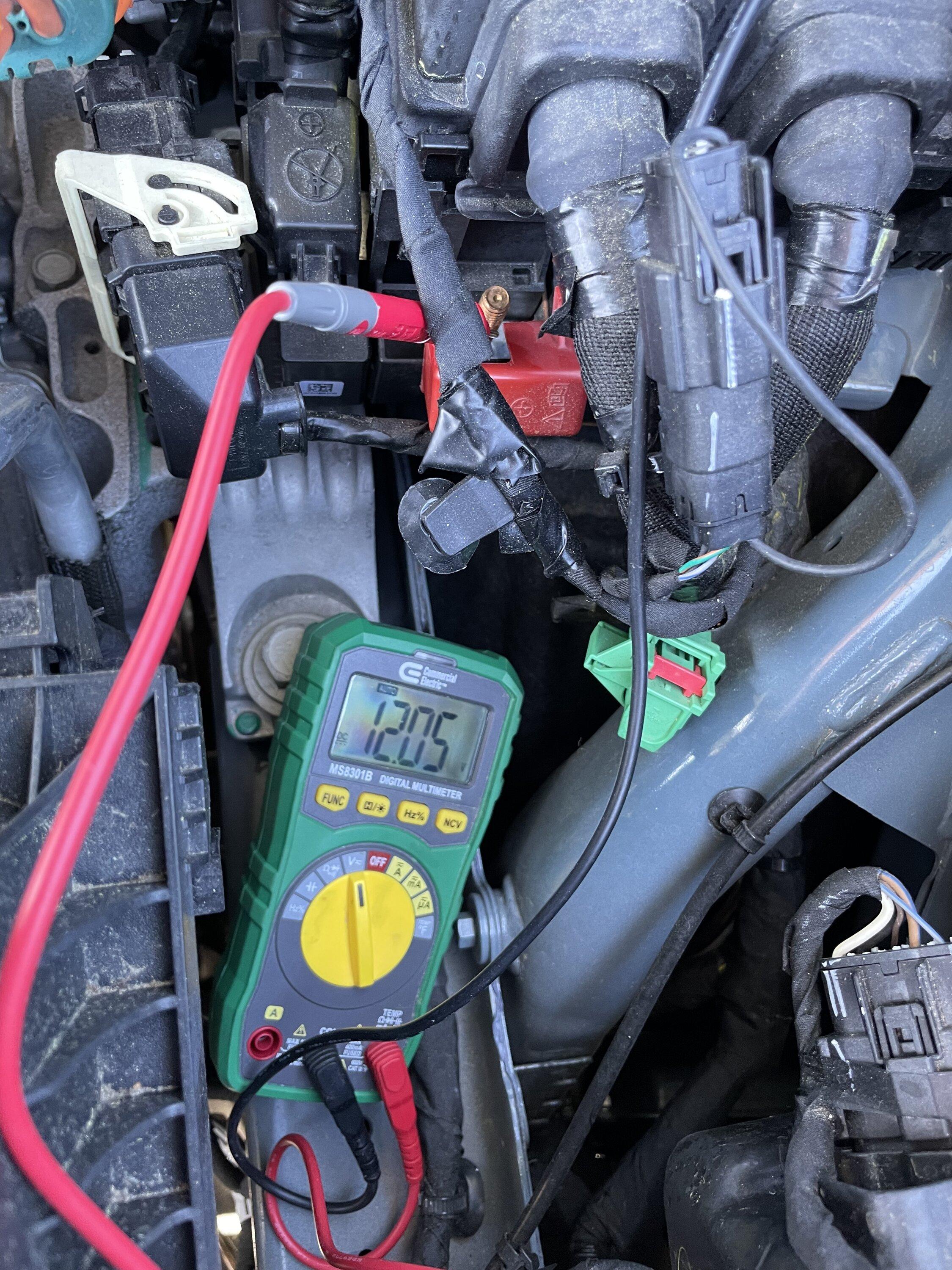

clavicus
clavicus
Jun 21, 2021
1,483
2,050
12.25on batt, 12.05 in the engine bay
