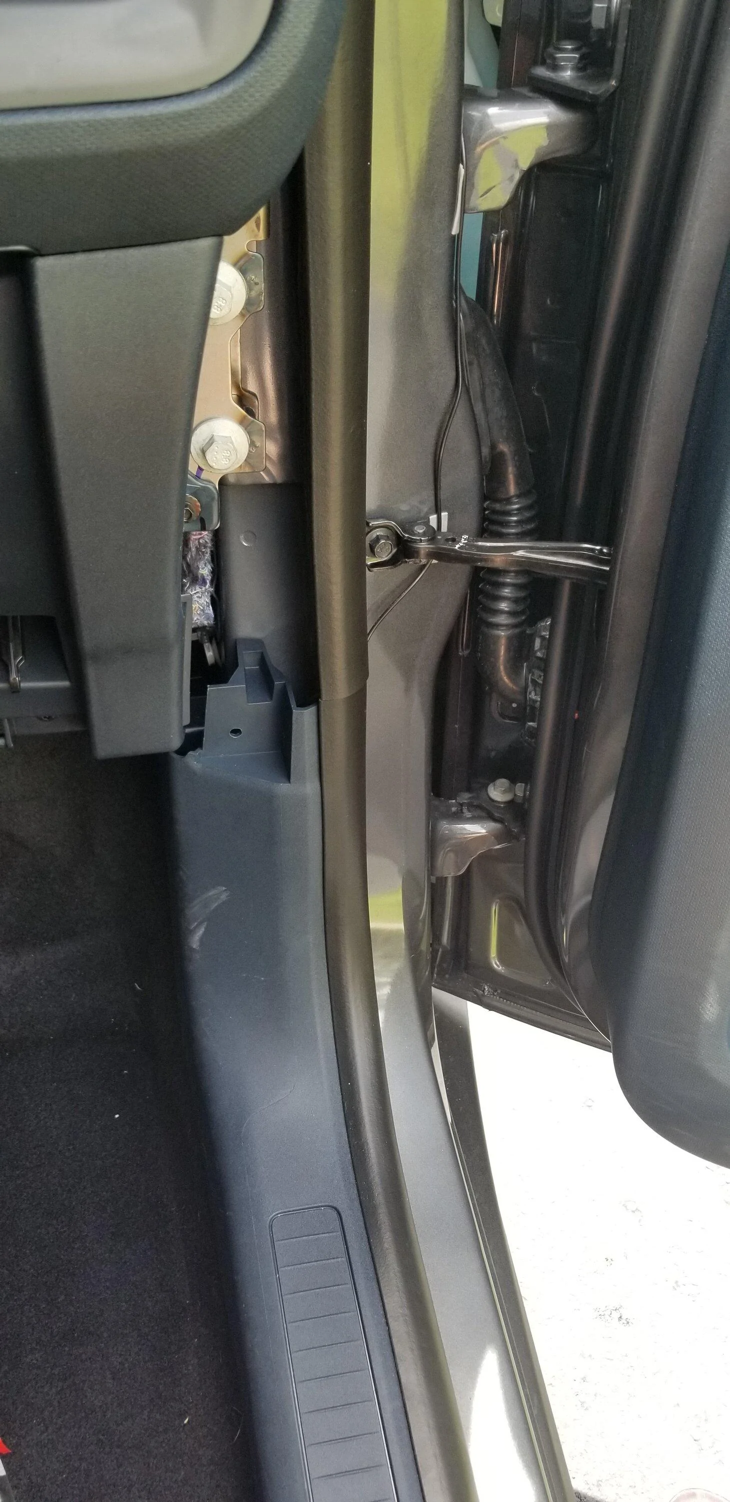

Wow. Very detailed. Thank you. Could the antenna wire be routed under the carpeting and the antenna be put inside the rear window?
I would assume you could lift the doorsill trim along the floor and run the wire to the back.

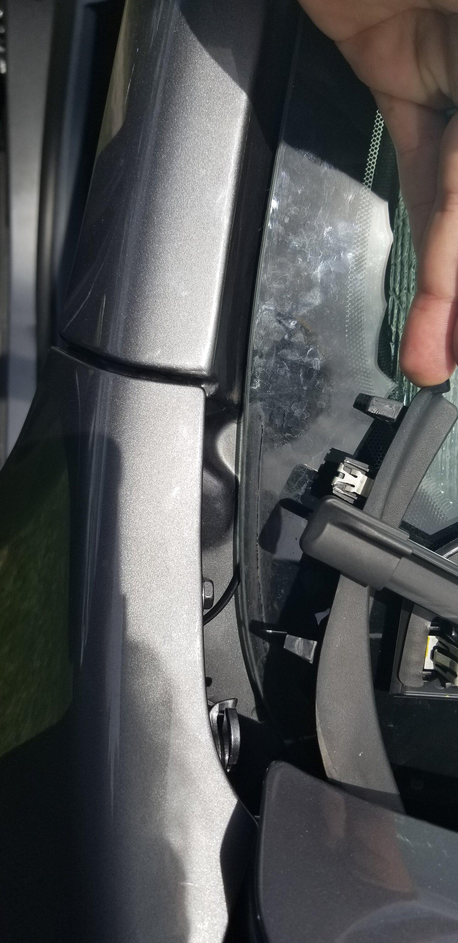

That is how I routed my antenna wire from the back of the cab. Through the 3rd brake light, under the headliner, down inside the "C" pillar trim, under the rear door sill trim, under the "B" pillar trim, under the right front door sill trim, under the "A" pillar trim to the fuse box area. Easy Peezy, andI think it took me about 30 minutes.
