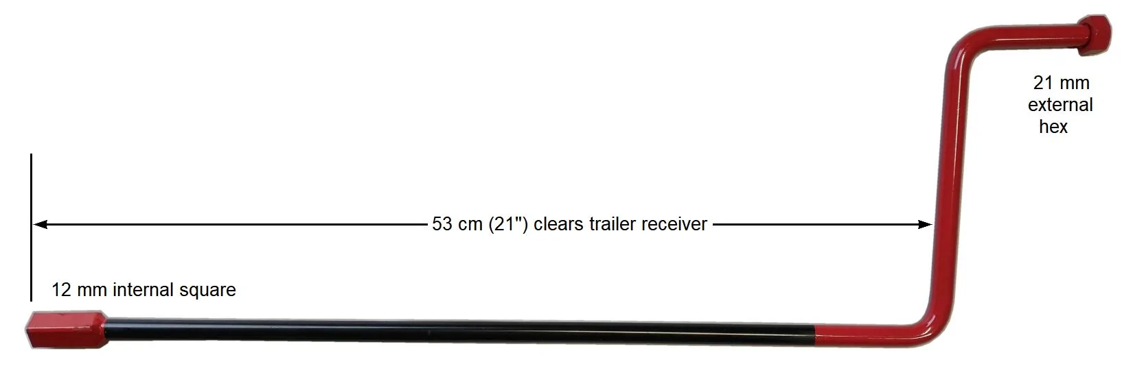

Ford Maverick Spare Tire Access Tool (Upgrade) 160253-5cce2030dfaebb8e64de42087291bc50

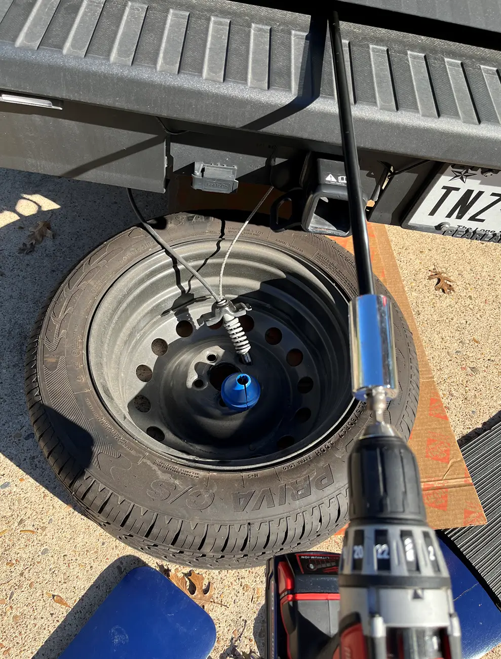

I used the Steelman 96095 Standard Square Head Tire Tool for Early Model Ford + cordless drill to lower my spare when rotating tires today. Made lowering & raising the spare easier than the Ford jack tool.
Ford Maverick Spare Tire Access Tool (Upgrade) 1766193226515-g
That does make quick work of it,,,,,
