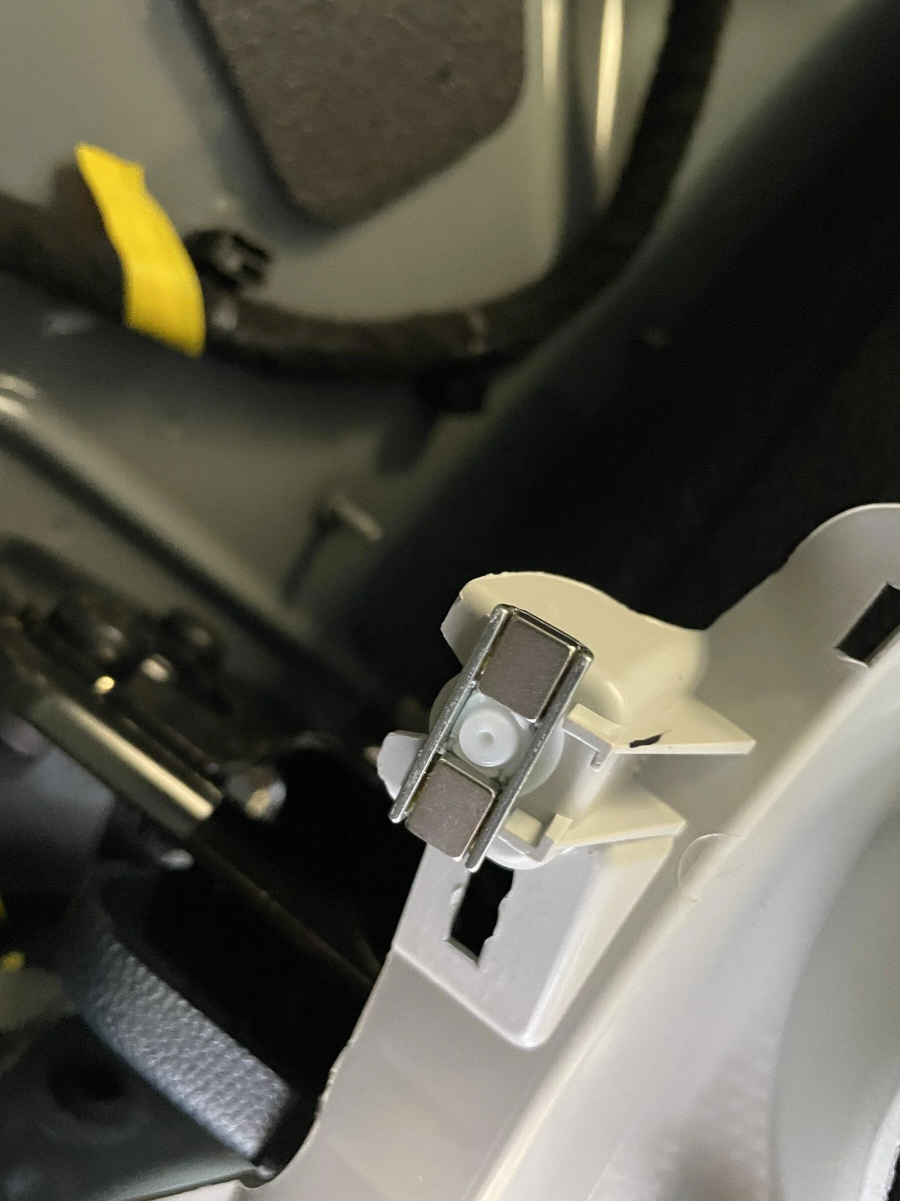

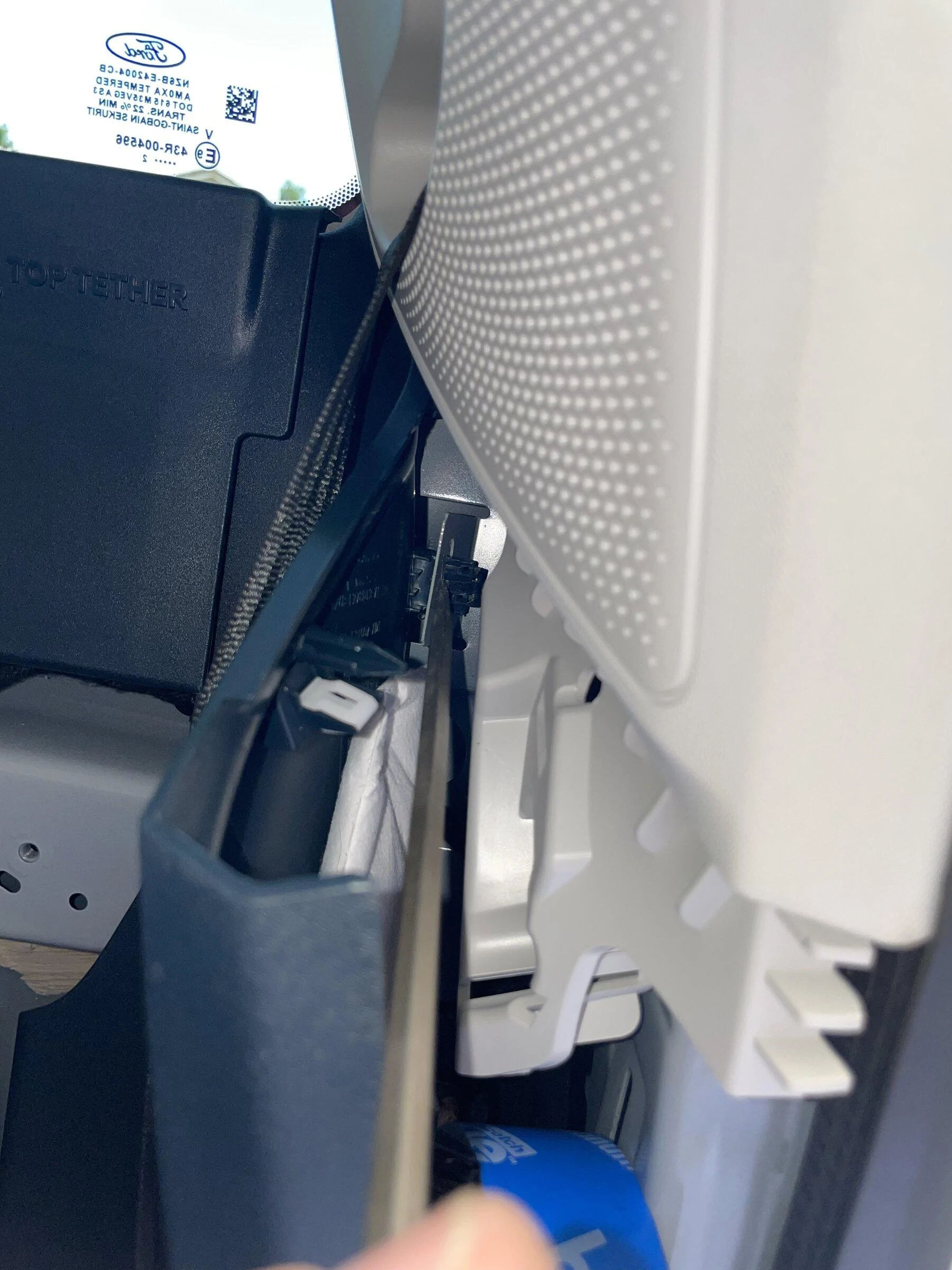

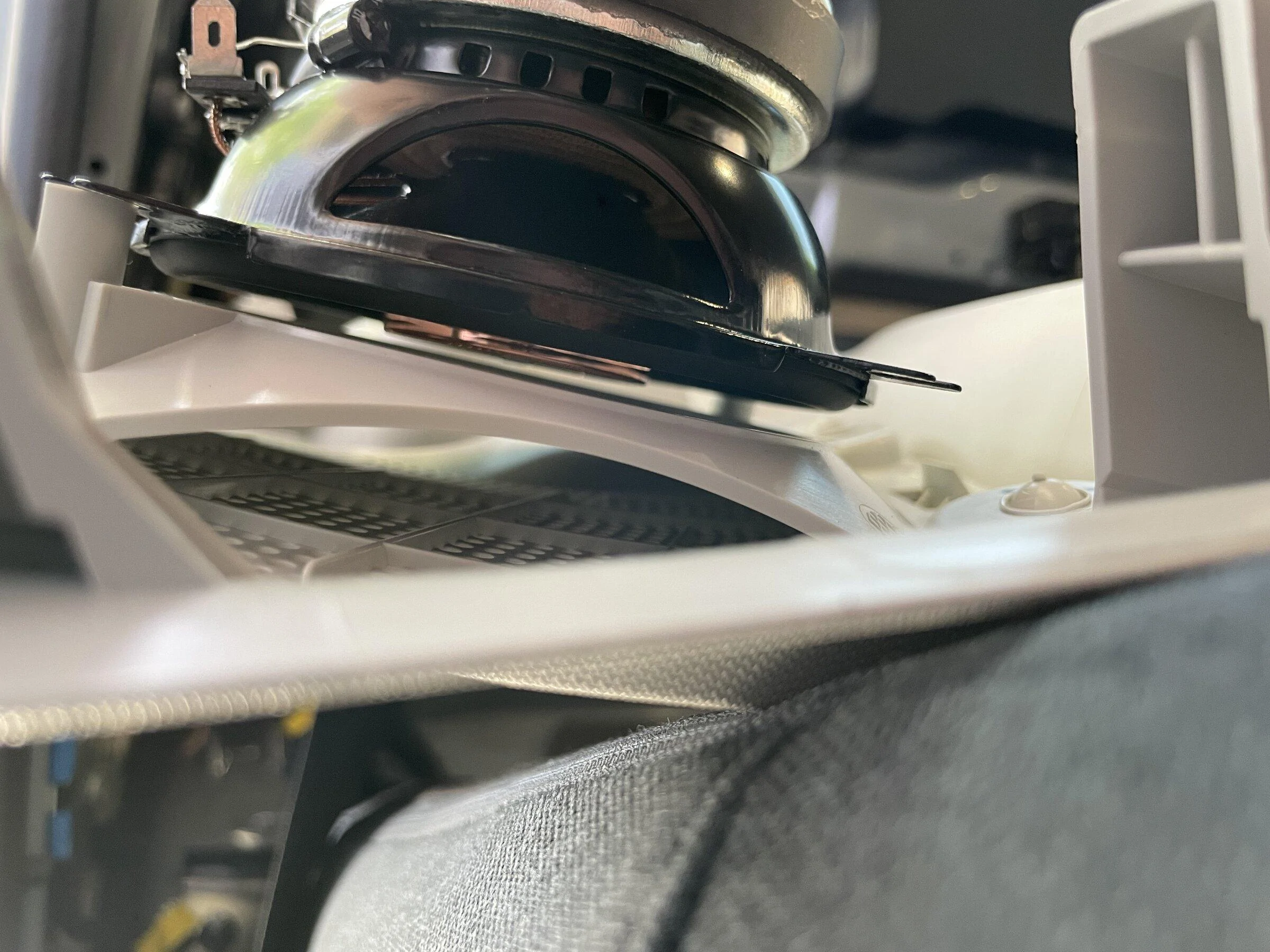

For those going into the back for speakers. The rear mounts are unique and may need foam to fill the space. I’d also like to point out that tricky metal clip on the side of the seat trim just needs a poke to release. I used a long screwdriver to press the tab. BTW- how neato is the little magnet tab. Pretty strong for such a small magnet. The Infinity reference I used over powered the fronts and I to move the fader up to balance. Much more range, including bass!!
Thanks for the info and photos. Seeing things in a photo eliminate misunderstandings and how they work, especially when we take things apart that may not be intuitive for some of us.
