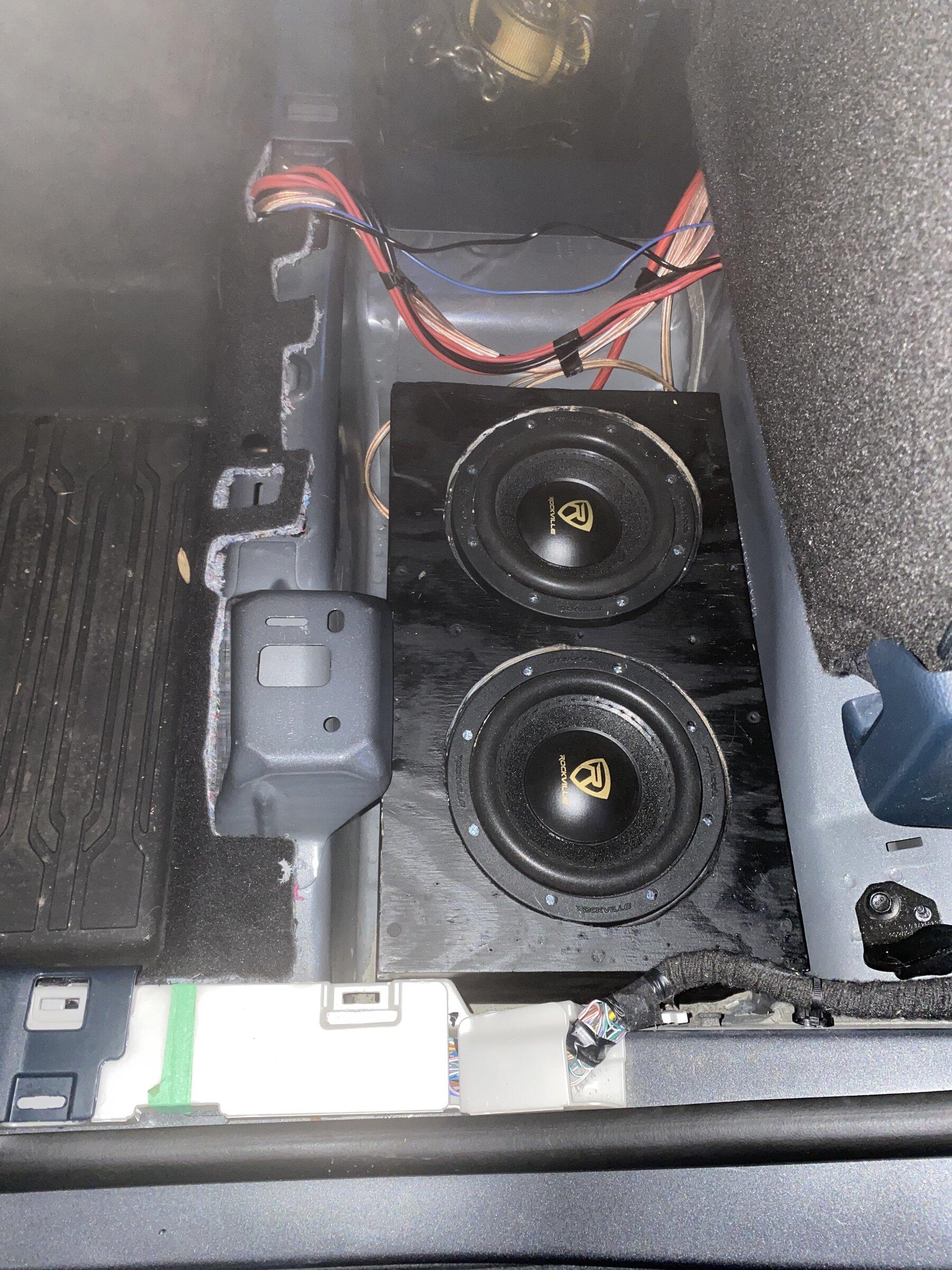

Sorry for the delayed response. I am using the Rockville 2 ohm dual voice coil 6.5 woofers. They sound amazing. Not going to rattle the car next to me crazy, but clean low bass that sound great inside the truck. If I had to do it over I might step up to the eights, but I am very happy with what I have including the boss amps.
