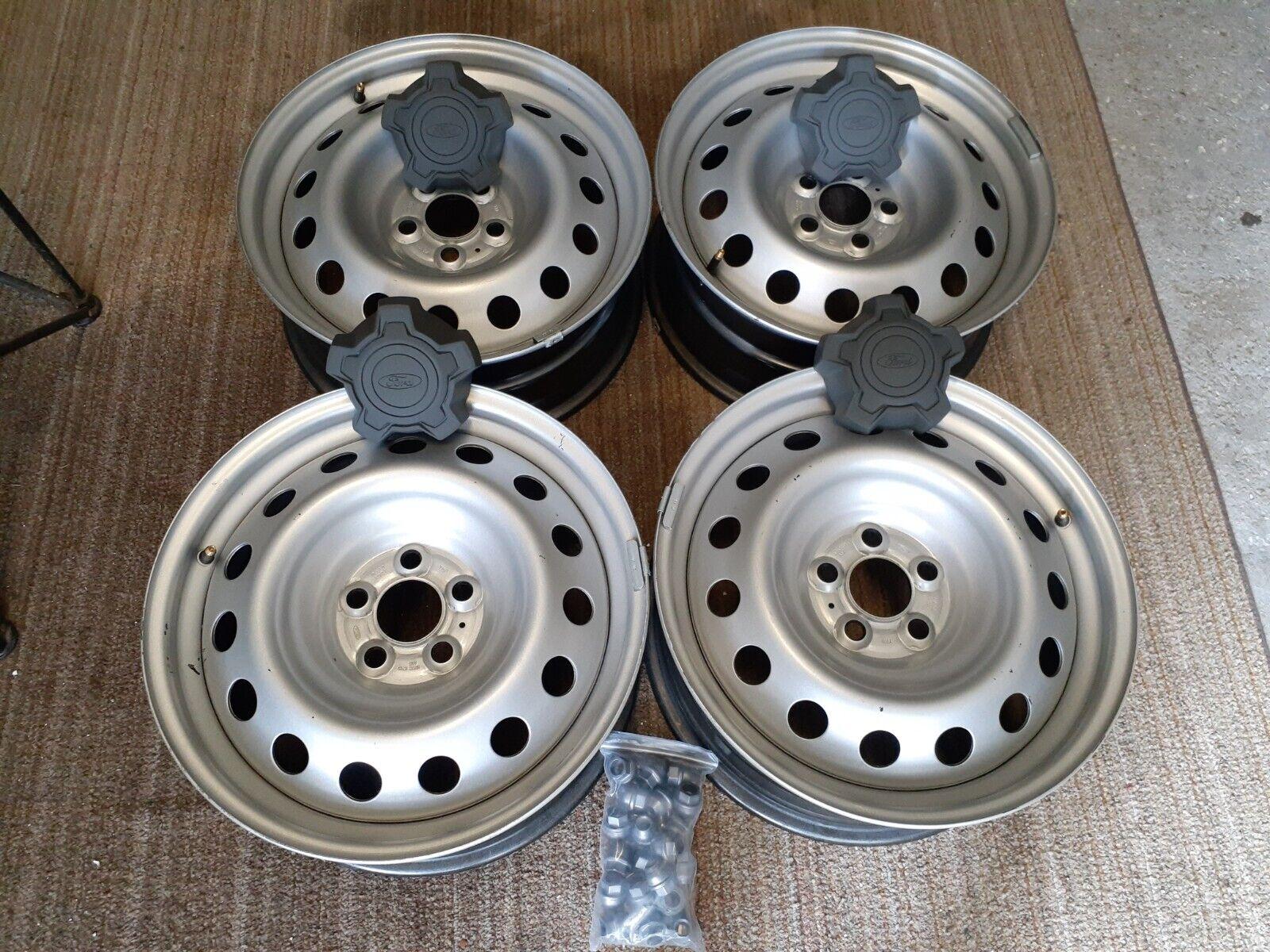

Been lurking since last July . Finally signed up. Here’s my Area51 XL Fwd .H&R Escape springs , trimmed bump stops. Blacked out wheels with interceptor hub caps. Roll up hard cover. Steeda bov mod . Added non xl factory things, Bed cubbies, tailgate lock actuator, cruise control.

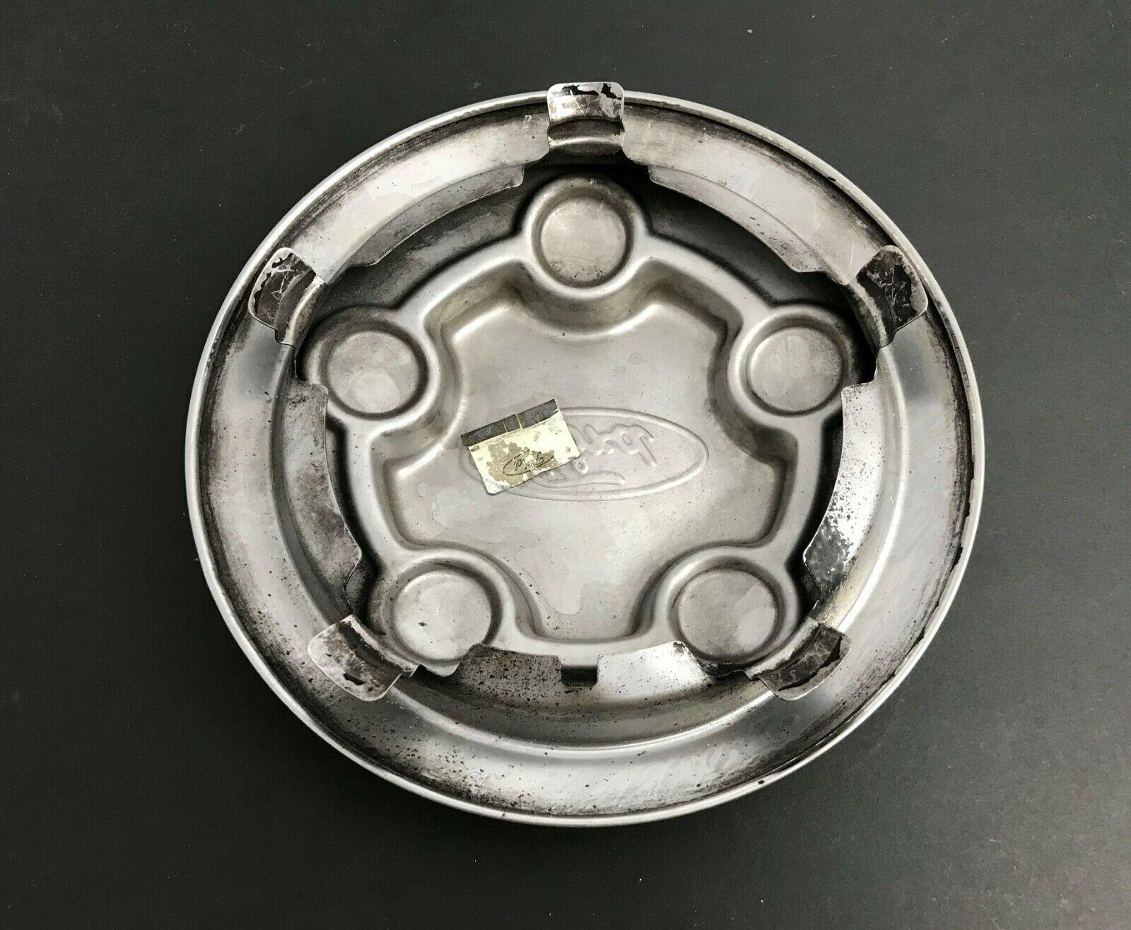

Curious how you bent the tabs to make them work. I have been thinking about doing this but had a hard time figuring out how the center caps would stay on. Can you offer some insight?
The tabs grab onto the circumference of the lug nuts. Since the Maverick's lug nut circle is smaller than the 4.5" they're normally used on they need to be bent inwards a little.
