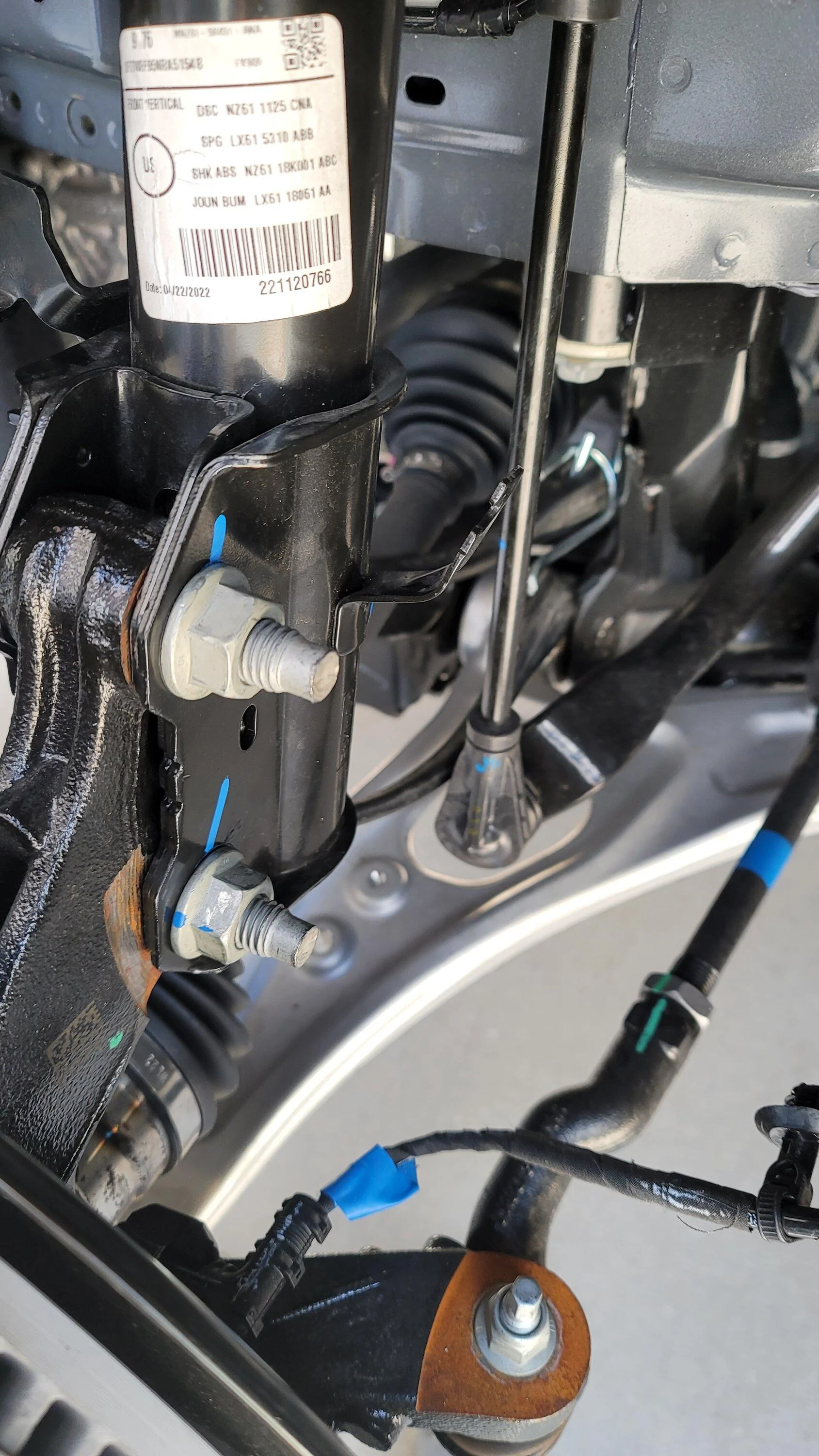

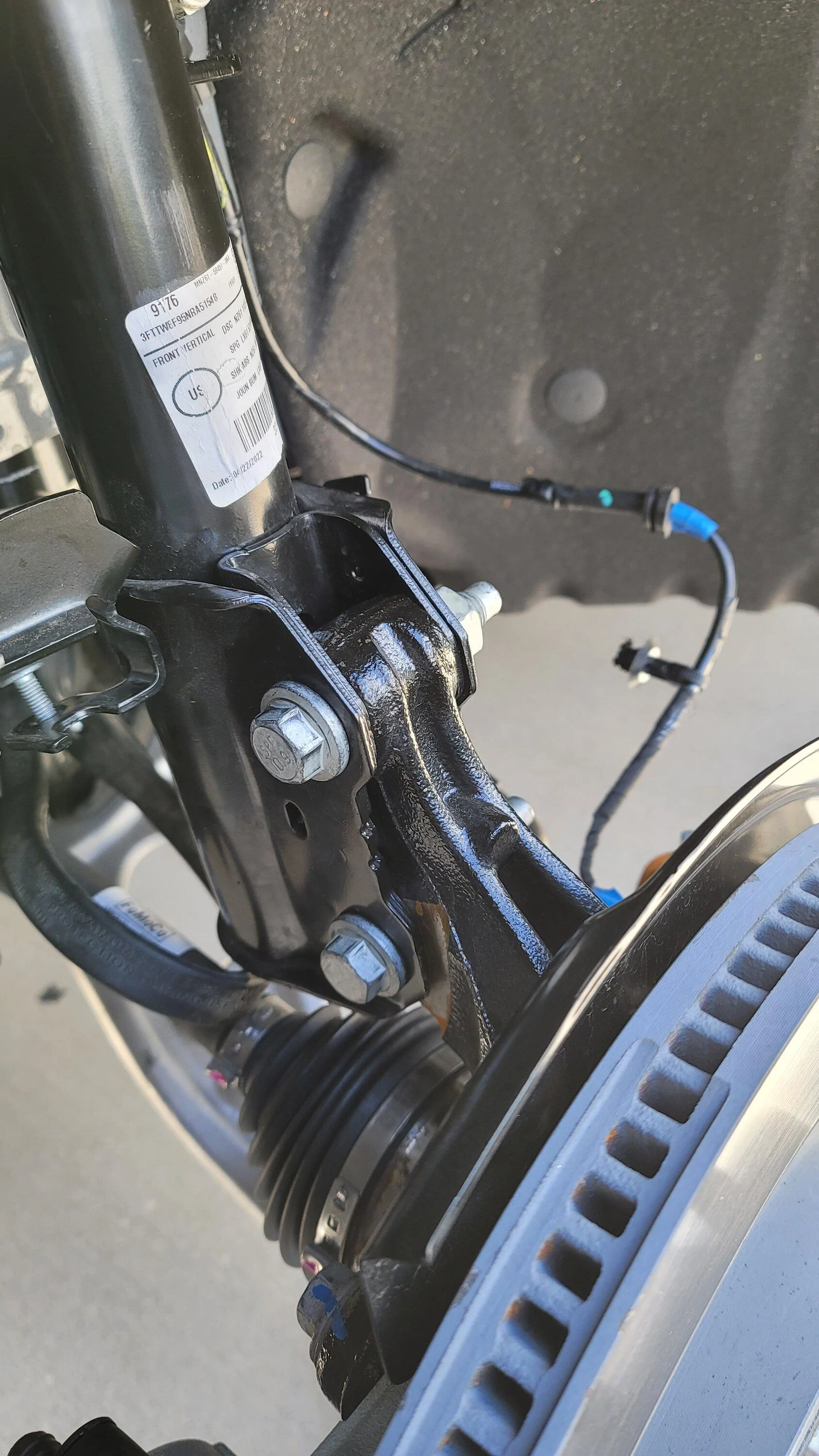

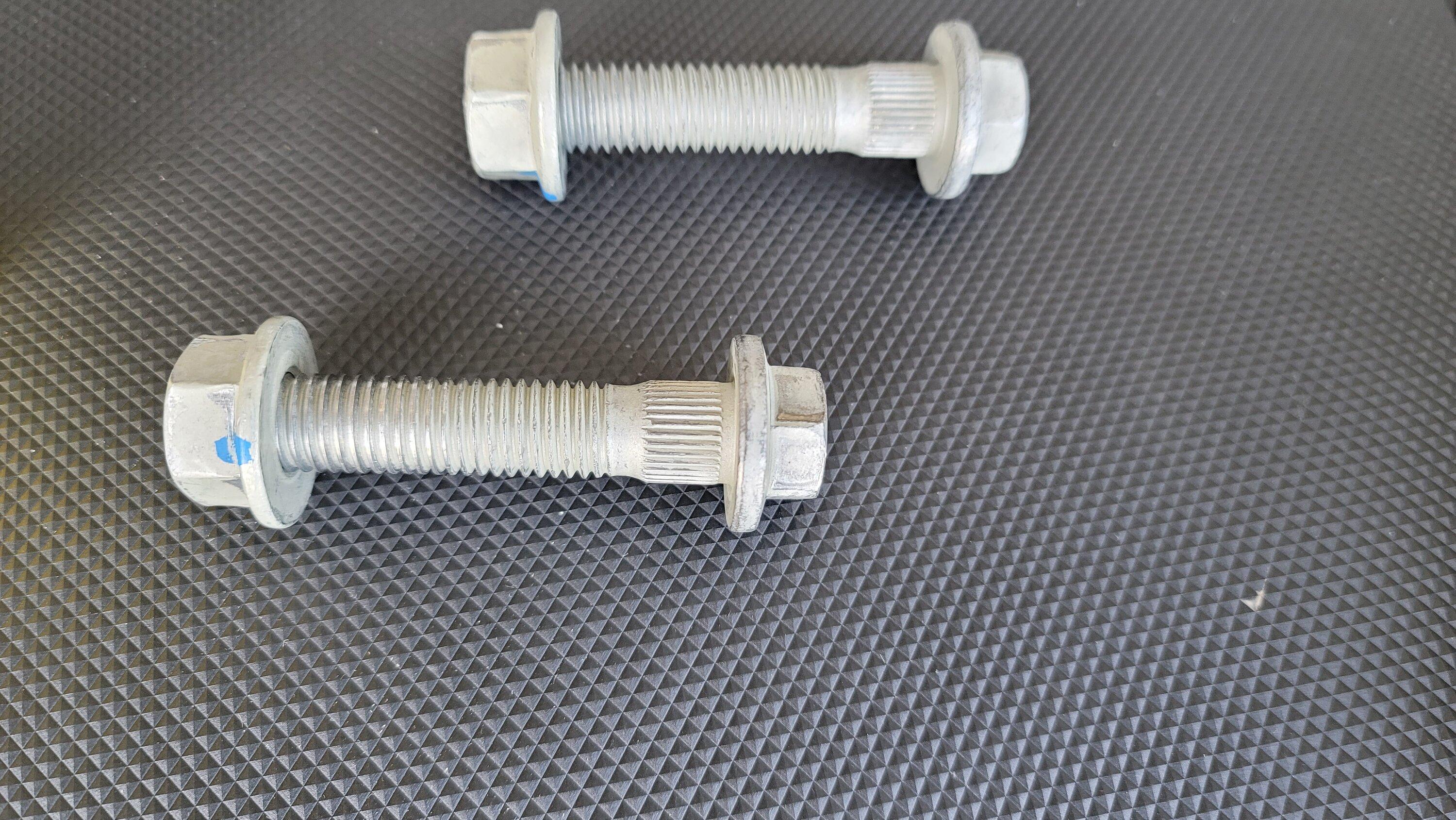

Got around to lowering my Maverick over the weekend. Waiting on wheels and tires to arrive hopefully soon. Like the look and the ride is good. Still, I think another 3/4"-1" in the front will be perfect. Waiting to see if anyone offers front coilovers soon. Easy install but be aware..front strut to knuckle bolts are splined and will need to be knocked out once the nuts are removed.

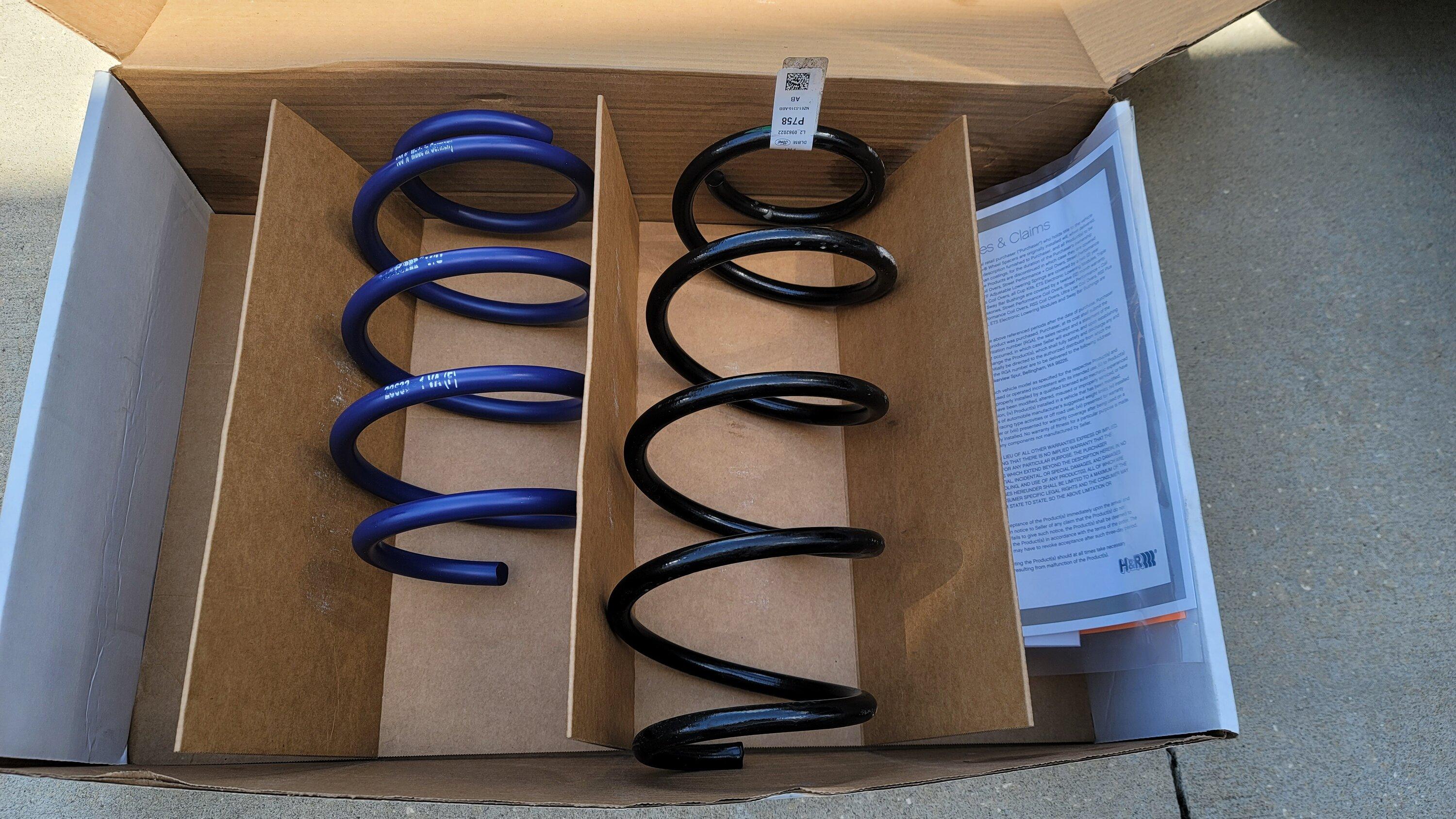

Also included a pic of the stock front spring and the H&R front spring. You would think that with this big of difference it would have lowered the front a tad more. I'm sure it will settle a little.
