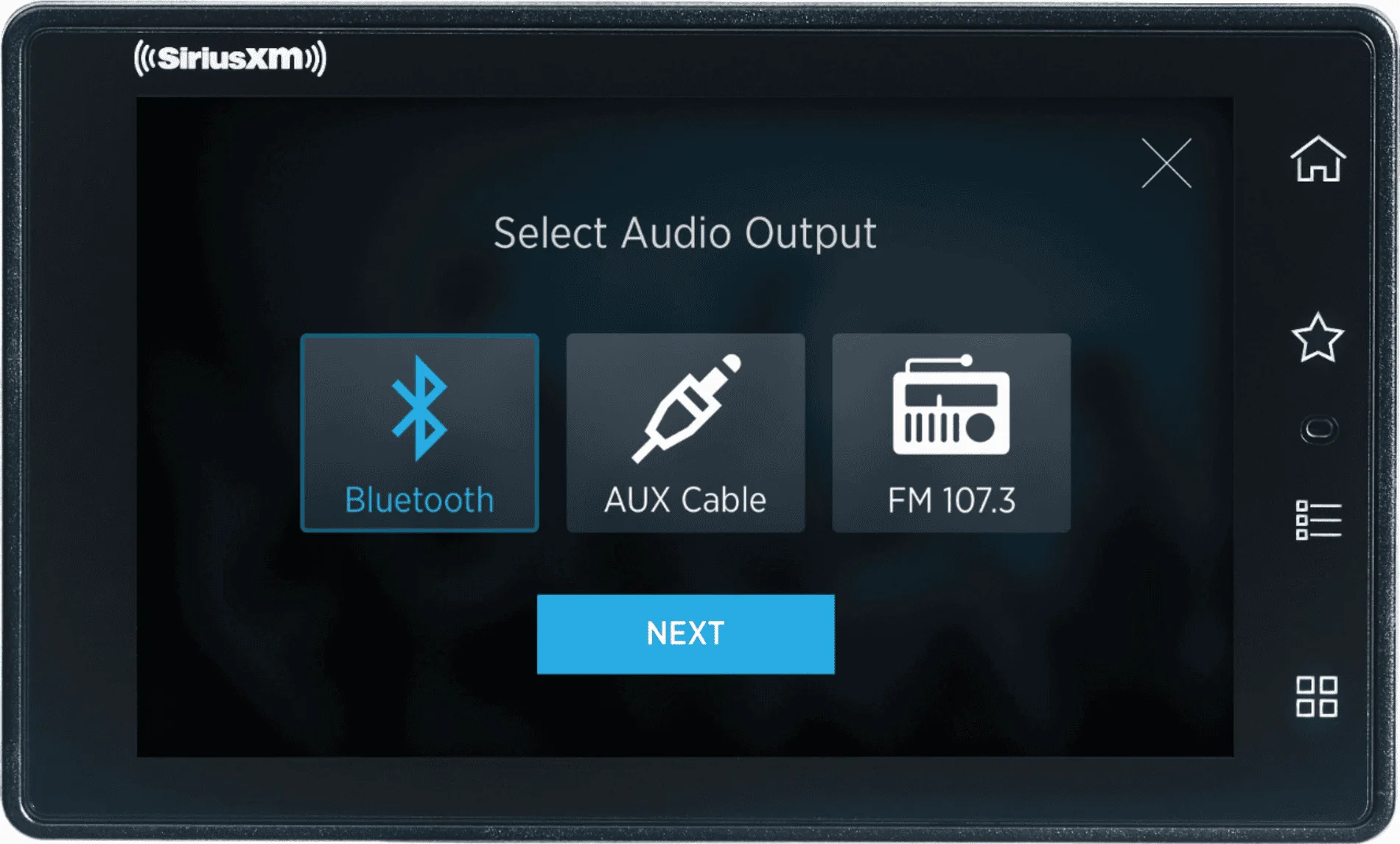

Here is a photo of Tour 360 output formats. By the way, it is 4.7" Wide x 2.9" high x .7" deep without the vehicle doc.

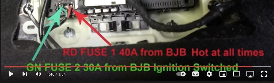

Yesterday (Saturday 17th), I wired in the tune module to the fuse panel located at the top right floorboard. Easy access even for my old arthritic body.
Ford Maverick Sirius XM options 1639858116613-jpeg
Ford Maverick Sirius XM options 1639855860559-jpeg
Connected the illumination wire and the accessory wire to the green accessory wire at the bottom of the fuse box. The fused yellow battery wire I connected to the red wire feeding the fuse box from the battery. It's hot at all times. I connected the ground wire to the bolt and nut conveniently located just below the accessory and battery wired connection.

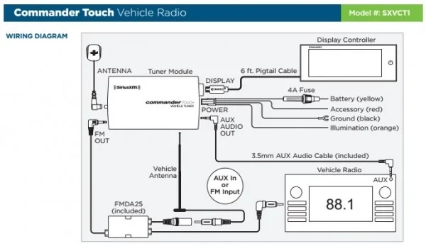

I then connected the FM module wire, the satellite antenna, display connection, power connection, and the aux cable to the tuner module.

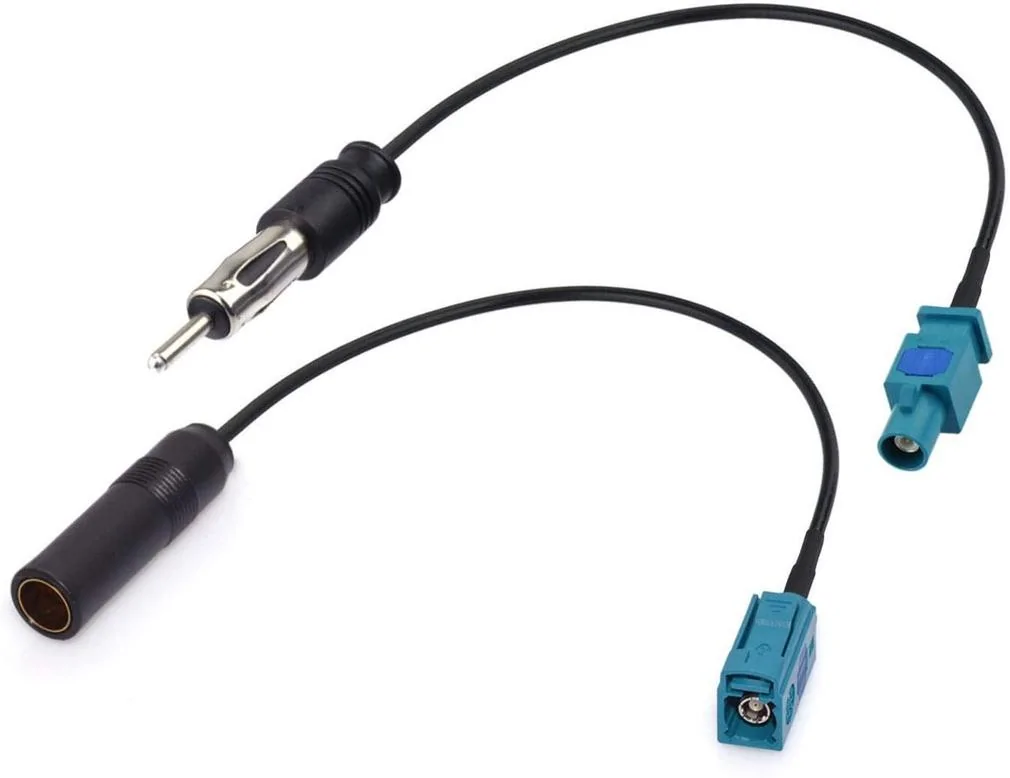

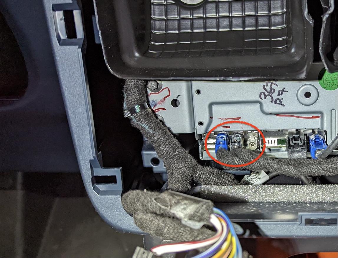

While trying to connect the FMDA25 module I discovered I needed Fakra Z Male & Female adapters to transition to the Ford antenna connection. The FM antenna connection is the blue one shown in the photo below.
Ford Maverick Sirius XM options 1639856835177-jpe
Note: the black connector farthest right, next to the blue connection on the right in the above photo is the USB input to the Radio. I did not find a 3.5 mm auxiliary input on the radio, but then I did not take it complete out. If I feel like it when I'm installing the FM antenna adapters, I'll slide it out to check. No photos I've seen of the APIM shows an 3.5 mm stereo auxiliary input.
So I ordered the adapters shown below from Amazon at .
Ford Maverick Sirius XM options 1639856915421-jpeg
These are universal type Fakra connectors and will fit several manufacturers various types. I based my order on the following rating from an Amazon customer.

The adapters are due in Monday afternoon. I'll get back to installing those Tuesday and finish finding where I want to locate the touch screen.

After I found the FM Module would not work without the two Fakra antenna adapters, I buttoned everything back up and reinstalled my old 2003/2005 XACT XM Radio.
I'll add to this post when I get the Fakra antenna adapters installed and everything working.
