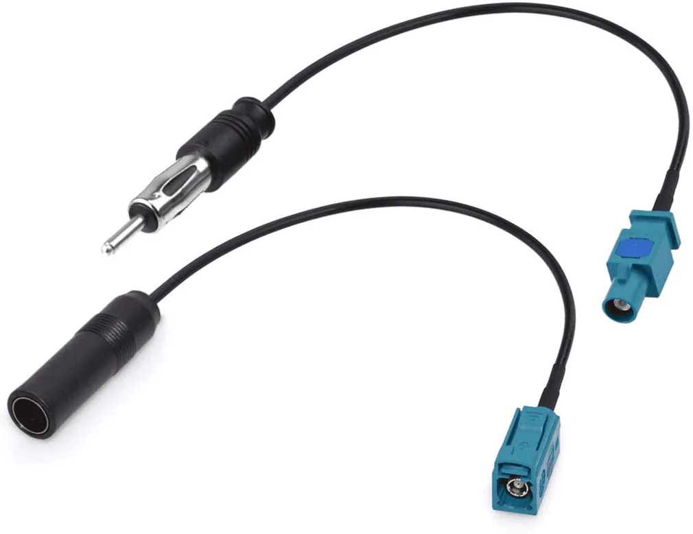

I finally received the fuse taps and the Fakra to FM antenna cable adapters on Monday and Tuesday. So yesterday I took the afternoon to install. The plastic bezel around the center console vents and AC controls comes off easily, just popping four tabs.
Ford Maverick Sirius XM options 1640285766274-png
I removed the blue Ford Fakra type blue onnector shown on the left within the red eclipse in the above photo. The female Fakra to FM cable adapter plugged easily on the Ford male connector. The Ford female connector on the loose cable plugged easily on to the Fakra to FM adapter with the male connector. This left me with only two FM cable ends on the purchased adapters not connected.
Ford Maverick Sirius XM options 1640286046009-png
This leaves the obvious connection of the FM cable ends of the FMDA25 inline FM relay to the FM cable connectors of the Fakra to FM adapters. Pretty logical and obvious. I ran the FMDA25 connection cable to the Commander Touch Module down the right side of the open center console out bottom to the fuse box area for connection to the Commander Touch Module.

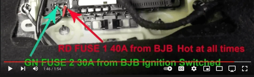

After removing the right floor board fuse box cover, I spent 1-1/2 hours trying to find a fuse slot that was not hot when the key was off and out of the ignition. I didn't find one. I don't know if they just were staying on for a few minutes after the ignition was turned off or not. I just didn't find a fuse slot controlled by the accessory which was necessary for the Commander Touch module to work properly. See the photo below that shows the power connections with the yellow wire connecting to the battery or a connection that remains hot. The red wire connects to an ignition control accessory connection, the orange wire connects to the cars illumination control which is not necessary for use. I don't care if the Commander Touch display dims with cabin lighting, or not, so I did not connect this wire.
Ford Maverick Sirius XM options 1640286108611-png
Obviously the black wire is the ground and is connected to the stud with a nut and washer just below the red battery wire and the green accessory wire feeding the fuse box. Instead of a fuse adapter, I tapped the fused yellow wire of the Commander Touch power connection wire to the red battery wire feeding the fuse box shown below. The red accessory Commander Touch power connection I tapped into the green wire shown below controlled by the ignition. Unfortunately, the first time I made the connection I mistakenly connected both the red accessory wire and the yellow battery wire of the power harness to the red always hot wire feeding the fuse box. So, naturally, when I turned the ignition off the Commander Touch display remained on. So, I had to remove the accessory red wire connection and make the tap on Ford's green accessory wire.
Ford Maverick Sirius XM options 1640287034396-png

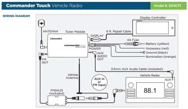

I then connected the Display, the FMDA25 relay, the antenna, and power harness to the Commander Touch Module. I did not use the auxiliary cable since it will not work with the auxiliary input of the Ford Radio.
So with everything connected, I started the truck and turned on the Commander Touch display and activated the SiriusXM radio and set it up. The Commander Touch display is bright and easy to see with great resolution and relieved my concerns about the small size of the display. Touch controls on the display work without lag and are intuitive to use. Finding an unused FM channel was difficult but finally I found one and tuned the Commander Touch to the appropriate channel.
I was going to put the display above Ford's display, but it seemed to interfere with the FM signal. So, I have notmounted it in a permanent position yet. I'm not real happy with the FM signal from the FMDA25 adapter and location seems to be important. The FMDA25 adapter is supposed to be a relay and block all FM over the air signals only to broadcast the FM channel chosen. It doesn't seem to work as I can change FM channels and they come through fine.
I'm going to try a few different places within the center console or fuse box area to locate the FMDA25 adapter. On the road it seems to perform a little better but I still notice some occasional FM static. I'm going to try and get some support help with SiriusXM to alleviate static through the FMDA25 relay and see why it will not cut out the FM broadcast signals. My old school 2003/2005 XACT radio FM signal had no static, so other than controls the Commander Touch did not improve the Satellite radio performance.
It's still a work in progress and I'll update when I can.

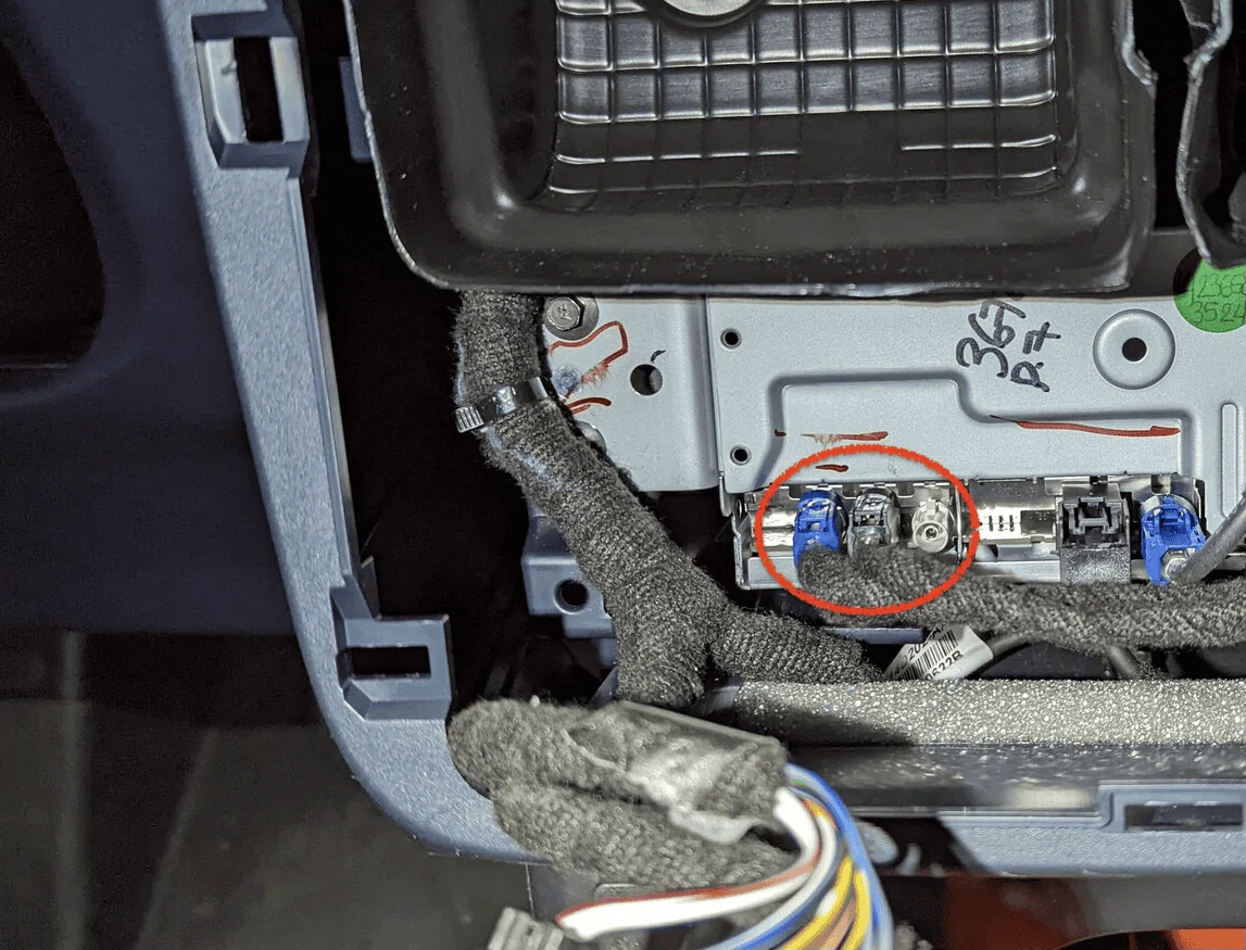

After going though a holiday trip trying to use the Commander Touch where the interference through FM was unbearable, I had to come up with a fix. Or, send the unit back.
The idea of the FMDA25 module is to block out other FM signals leaving only the FM output signal of the Commander Touch module for a fairly clear audio. It wasn't working, period. I tried every FM channel and none of them were good. I checked the SiriusXM, Best Buy, & Crutchfield websites for information and nothing they offered rang a bell for me.
So, yesterday afternoon, I opened up the center stack where the radio module is located (the bezel surrounding the AC vents and HVAC controls) and started looking around. I checked all the connections and they were tight. I verified the connections of the FMDA25 module against the wiring diagram and also the main Commander Touch module. All were correct and tight.
It finally dawned on me. There are three antenna inputs into the Radio Module, as the red circle in the below photo shows.
I had chosen the blue connector on the left. Why? I don't know since I never found any information about which is the FM antenna input. We all know what happens when we assume something, which is exactly what I had accomplished. So I removed the FMDA25 connections from the blue input and put them inline with the center gray Fakra connection. I don't know what the third empty antenna input, located on the right, is used for. Is it a GPS input? Maybe a Satellite antenna input? I don't know. Because the results of changing the FMDA25 to the center antenna input produced great results I forgot about checking the third input. Now I'm curious—just because it's my nature, I guess.
I've mentioned before, the Commander Touch screen is high resolution, brilliant, and a pleasure to use. I have played with many locations around the center dash and now without all the static, I could mount it on top of the 8" radio screen. I just did not like the looks. So I compromised somewhat. Since I had the HVAC bezel off I located the Commander Touch screen right in front of the AC vents, using the trim piece that SiriusXM provides. It is a matte black so it blends in with the dash materials better than the piano black Commander Touch display.
I like the looks, the location is not obtrusive, and it is easy to operate located in the middle of the center stack. It does not block enough of the AC vents to render them useless. Plenty of air comes through. I mounted the display using hook & loop Velcro so, if I decide I like another location, it's easy enough to move. Although the Commander Touch screen is easy to use and responsive, I like using the remote control.
Now if I want to listen to regular FM (almost never), all I have to do is turn the Commander Touch off. When I turn the Commander Touch on, then the rest of the FM signals are blocked out. It's working as intended.
Anyway, the Commander Touch works great now and the sound on the chosen FM channel is without outside FM static. Again, the signal is FM, so the sound is not audiophile quality, but it is pretty decent and clear now. But again the XL cabin is not a super quiet, so the sound doesn't need to be perfect.
