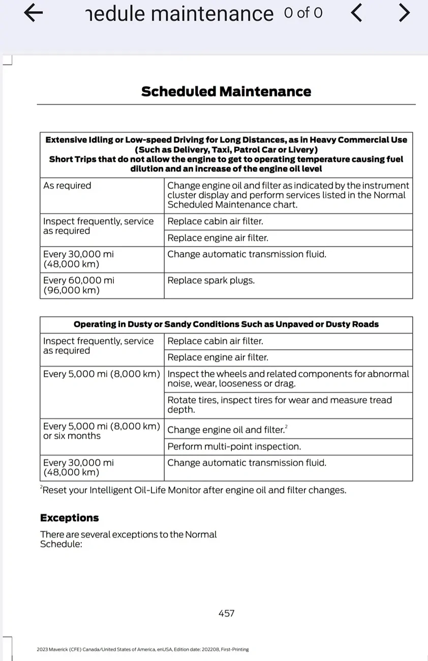

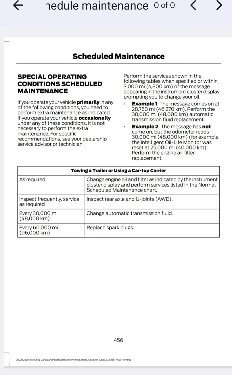

Here you go 2023 owner's manual online.
Ford Maverick Shocking Hybrid Transmission Fluid Change at 65k miles IMG_20260728_105737
Ford Maverick Shocking Hybrid Transmission Fluid Change at 65k miles IMG_20260728_105757
Having it downloaded on the phone is handy

No.
2025MY online manual.
Other Maintenance Items 1​
Every 20,000 mi (32,000 km) Replace the cabin air filter.
Every 30,000 mi (48,000 km) Replace the engine air filter. For severe service, Change the automatic transmission fluid.

I think it has been established that towing and hauling 25% of the time on dry pavement in mild 40° to 100°F weather is not severe duty.
