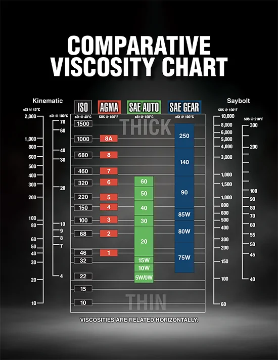

Gear oils are rated on a completely different scale and standard than engine oil by SAE. 75W-85 gear oil is about the same viscosity as a 20-30 grade engine oil, so, similar to that 5w-20 estimate.

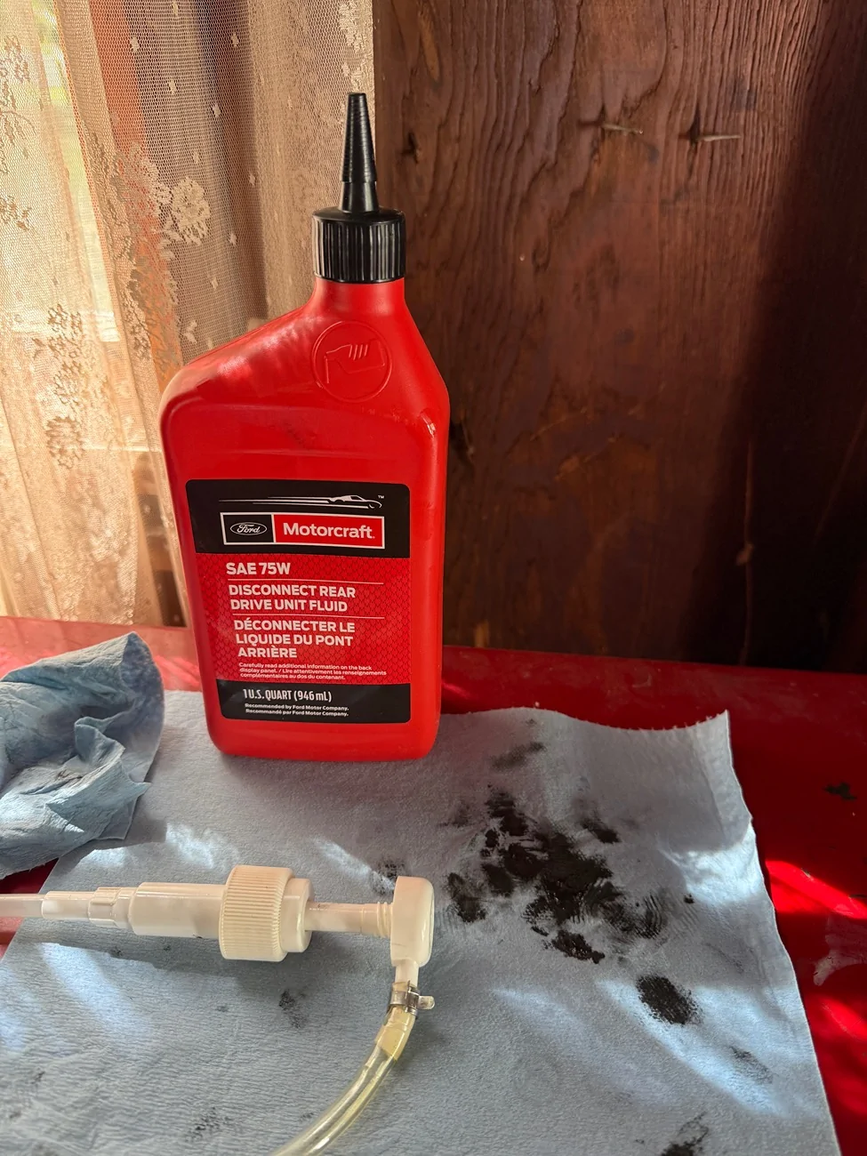

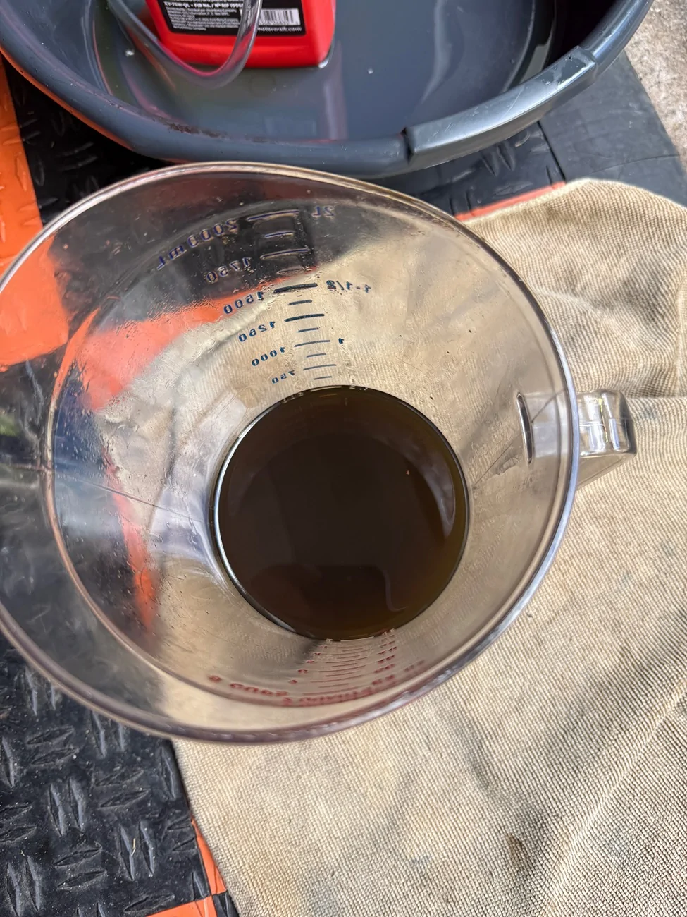

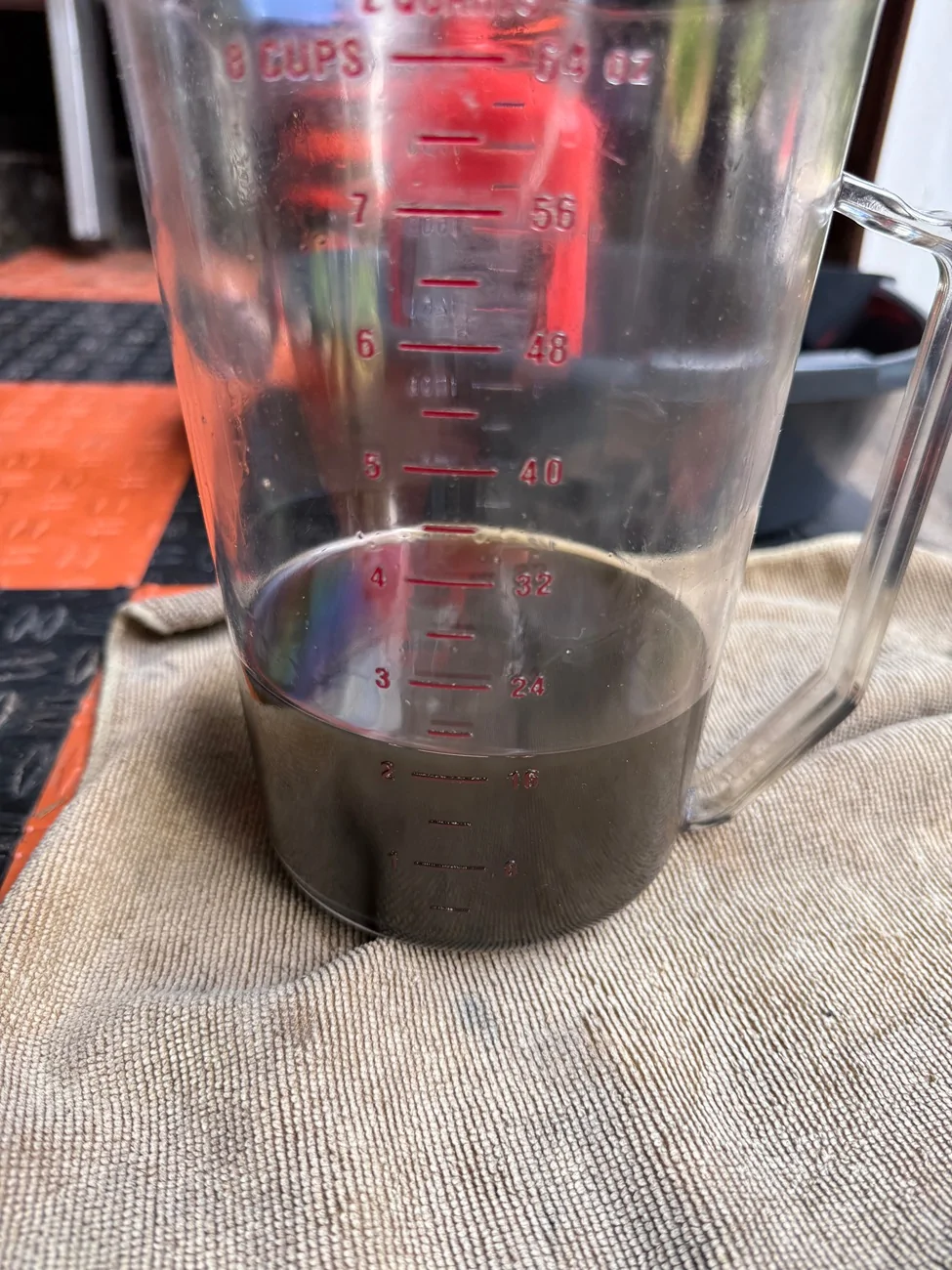

I posted the results of the PTU oil change last week so I figured I post the RDU oil change. Pretty much the same results: It was properly filled at the factory (About half a quart and and half out), old fluid was cloudy, and there was sludge on the magnet. The RDU is slightly easier since there is no cover to remove and the fill plug is easier to get to.

Phimosis said:
(reports says that it is similar viscosity to 5W-20)
I have changed the RDU fluid in my Maverick, and it appears to me to be similar viscosity to 5w-20 motor oil. Maybe 5w-30, but they're pretty close. Comparative viscosity charts agree with that for 75W gear oil at the same temperature.
Changed my RDU & PTU yesterday at 4,100 miles on 2025 Lariet Hybrid AWD. Backed onto ramps for RDU, pulled onto ramps for PTU. RDU was underfilled, oil not really bad looking, magnetic drain plug had lots of metal shavings. My experience similar to others, no surprises. Fill & drain plugs not leaking, but not tightened to specs. PTU - Fill plug was Very tight, drain plug about same tightness as I found on RDU plugs. PTU also underfilled, no noticeable metal shavings, but old fluid had a peculiar smell. Refilling PTU awkward but doable. My Takeway - Both fluids needed changing early on, glad to have done, will likely not repeat until 30k or more miles. I'm 79 next month, hope I can still do it by then when I'm 80+ Lol.
