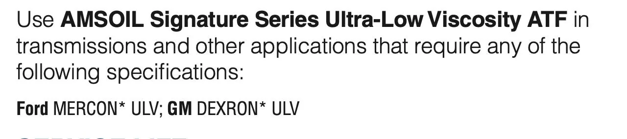

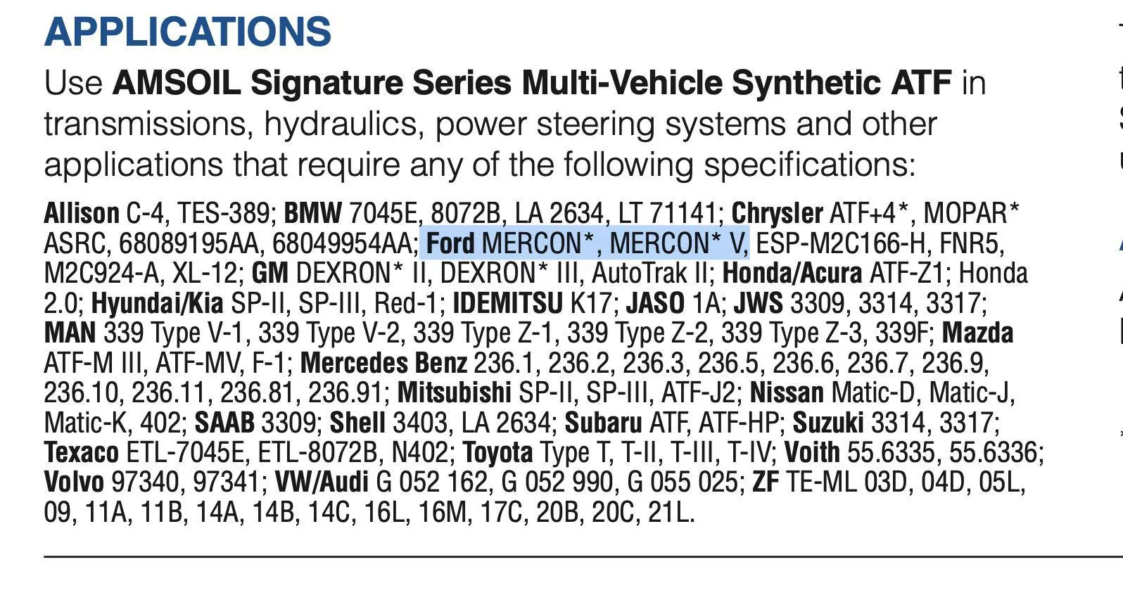

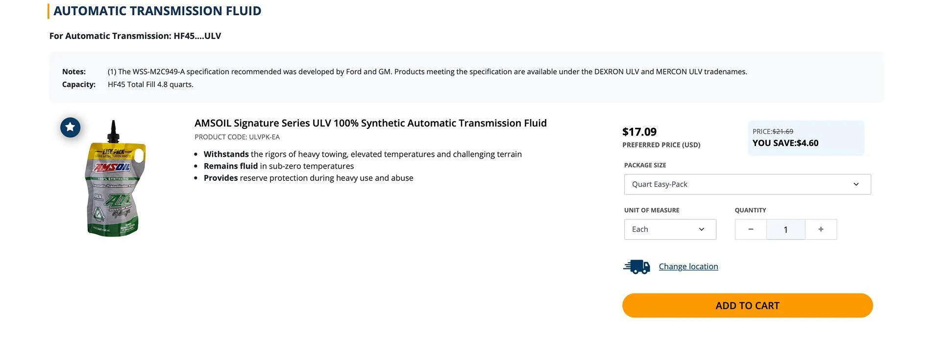

Why use Amsoil? Ford ULV is $6/qt at Rock Auto. Ford has a history of using extremely good fluids.
dunno. I have a 15 year membership, so yearly I just order everything at once, mowers, motorcycles, cars, backup generators, just convenience. I think it's still good for another 6 years or so before membership expires
Ford Maverick Maverick Hybrid transmission fluid change at 150,000 miles? Screenshot 2025-01-21 at 1.44.04 PM
back when used to ride motorcycles on the track with a big group, I was the amsoil supplier/dealer. so I made $$$$ off the orders. now im just a consumer account. but still got a long lasting account lol.
