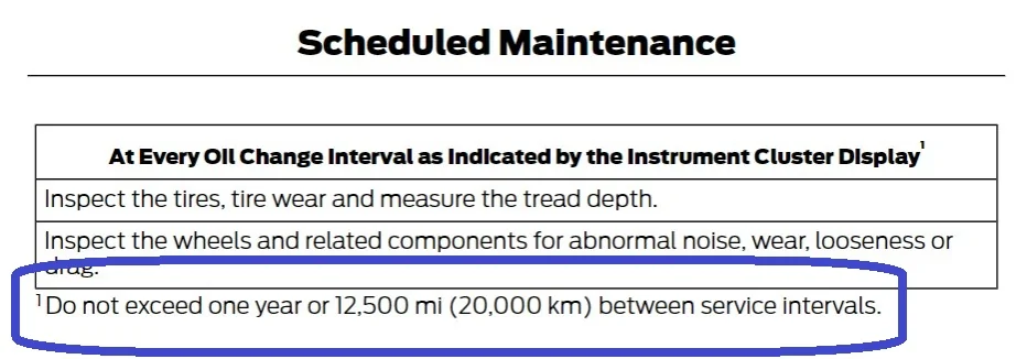

Methinks the dealer is overselling you on service, yes lower miles = longer intervals (up to one year is specified in my '26 owners manual). So with your low mileage it should be once a year! You can always do it more frequently but it's not usually necessary with modern vehicles and lubricants.
So what does your owners manual say? If you take a lot of short trips, follow the "severe service" schedule, for example for my model year (2026) it mentions to changed the air filter every 30k miles and the spark plugs every 60k miles for "severe service" but does not mention severe service items for things like oil changes.
The manual also mentions that 1 year is the maximum between oil changes, otherwise to follow the oil minder when it comes up on the dashboard.
This is for a 2026, you have to check your own owners manual (you can find it online in your Ford Owner account).
"Intelligent Oil-Life Monitor™
Your vehicle has an Intelligent Oil-Life Monitor that determines when you should change the engine oil based on how you use your vehicle.
By using several important factors in its calculations, the monitor helps reduce the cost of owning your vehicle and reduces environmental waste at the same time.
This means you do not have to remember to change the oil on a mileage-based schedule. Your vehicle lets you know when an oil change is due by displaying a message in the instrument cluster display.
The following table provides examples of vehicle use and its impact on oil change intervals. It is a guideline only. Actual oil change intervals depend on several factors and generally decrease with severity of use."
