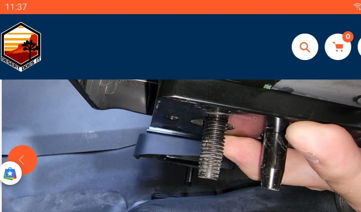

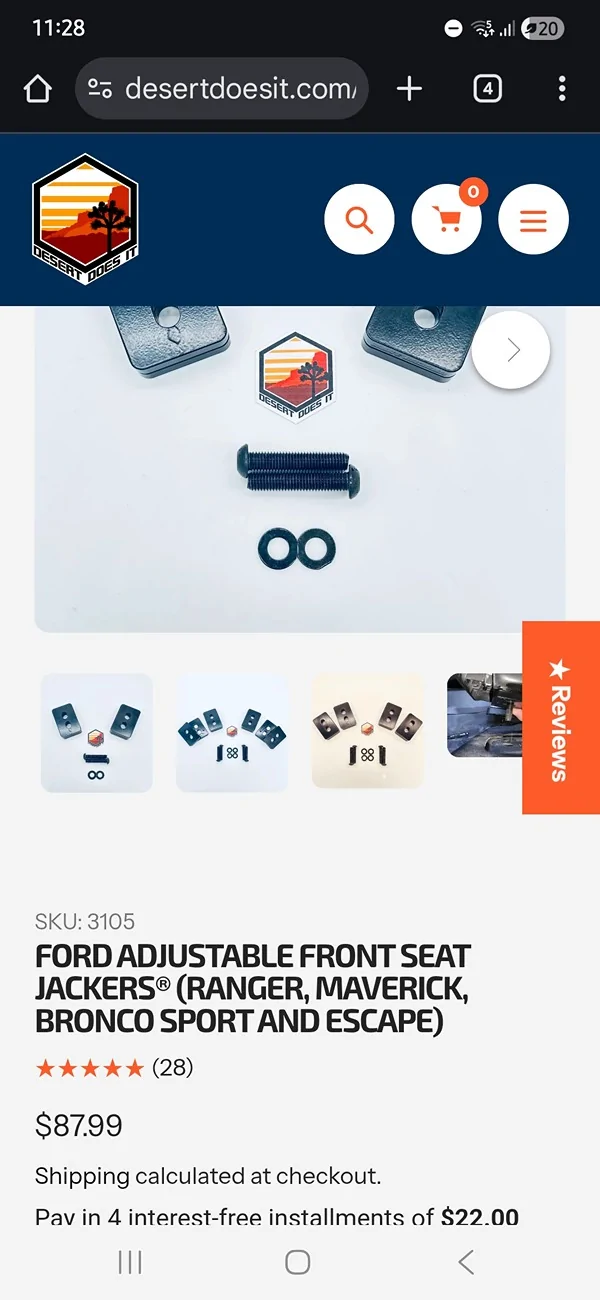

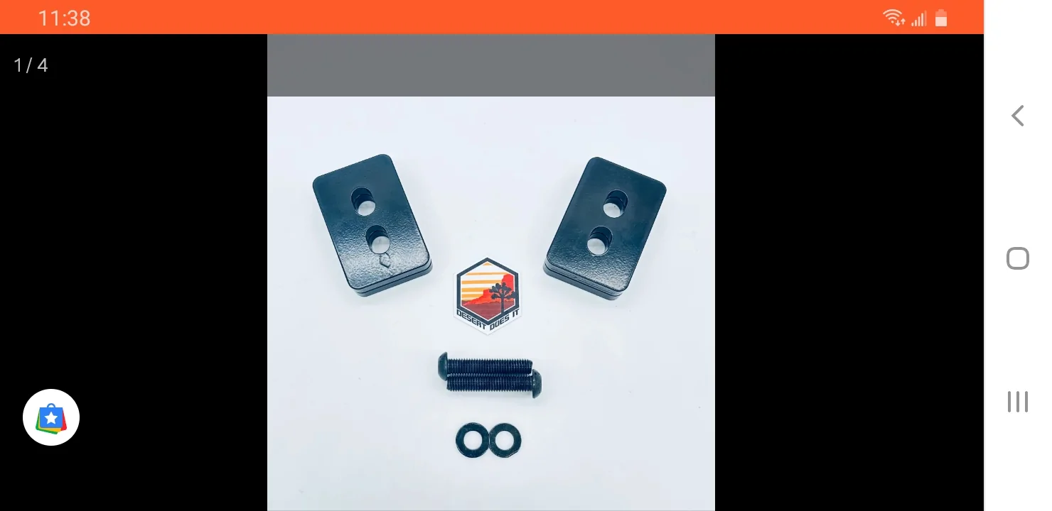

While I do not have experience with this product. I do like the idea that it is specifically made for the purpose of raising the front of the seat. It also looks like it has a hole for the positioning stud that comes down from the seat track.
Ford Maverick Front Seat Jackers/Risers Screenshot_20260112-113853_Chrom
Ford Maverick Front Seat Jackers/Risers 20260112_113819
VS
Rigging something with washers that can slide and a hardware store bolt of questionable quality.
How secure do you want your seat to be in the event of an accident??
Good luck
