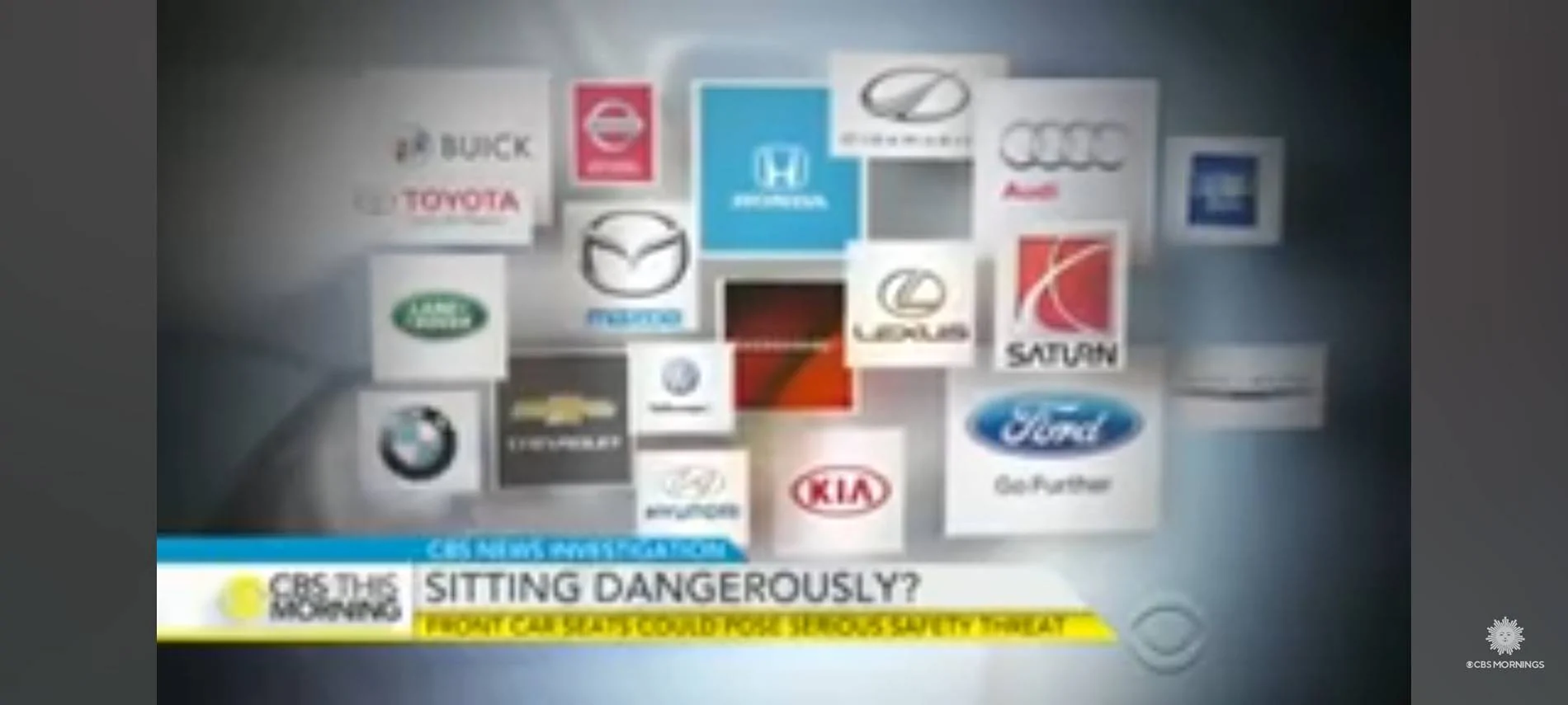

This is a known issue, in all vehicles, due to an outdated NHTSA safety standard. You can read about it here and here, and about the act introduced to correct the issue (which I believe has not gone into effect) here. Also a video from CBS here. Wild to think a long-running issue that's killing children isn't a big enough deal for car manufacturers to invest in correcting.
