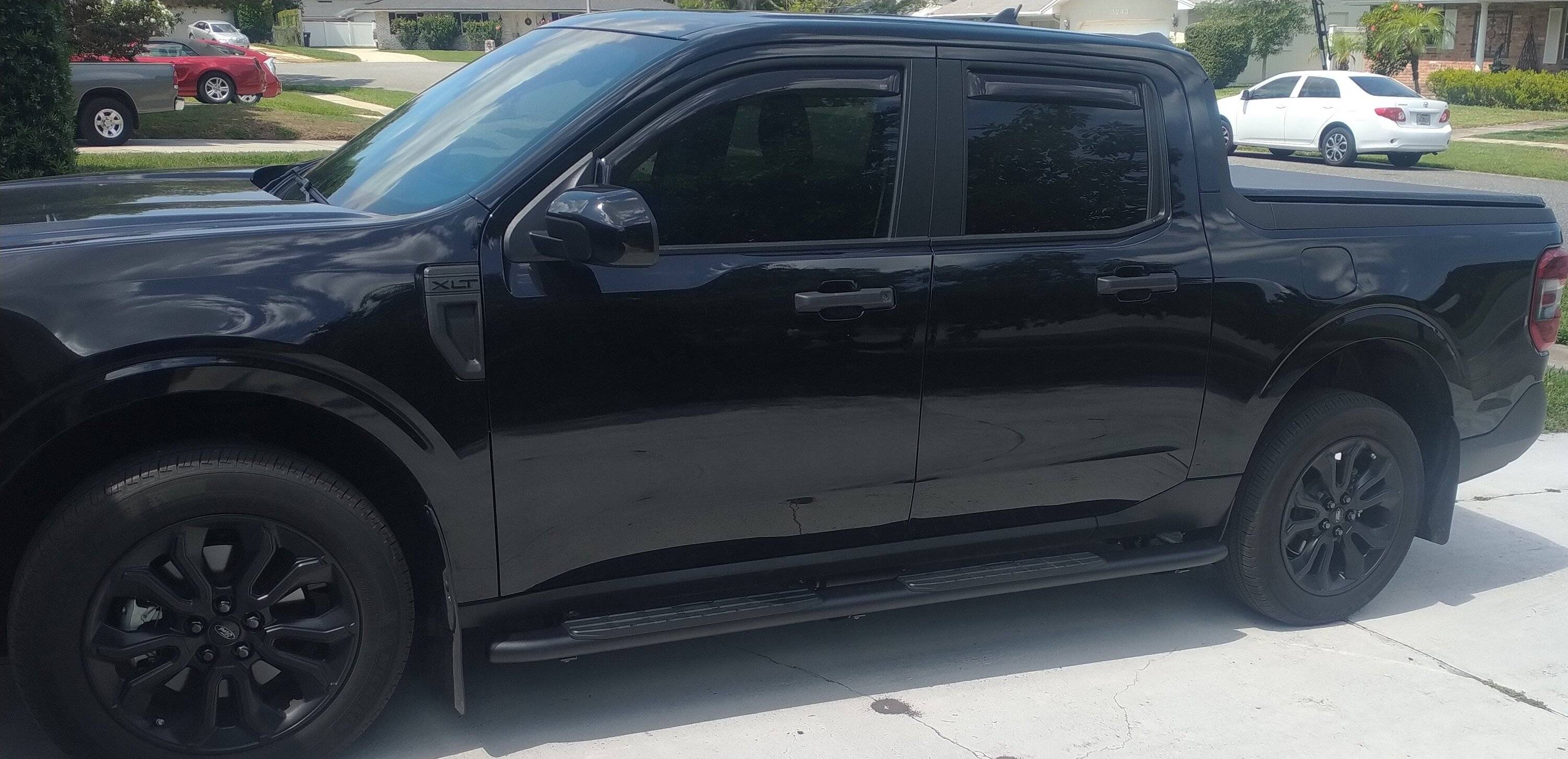

Running boards installed. I know ,I know.
Ponyprez
Kevin
Mar 25, 2022
302
266
Southern New Mexico
1965 Mustang 2+2, 2023 Mach E, 1990 Mustang 7UP Convertible, 2023 Maverick,
Just installed these bars from Realtruck. Amber gave me a nice discount, and got them yesterday.
I had the same issue as others with the 'nut plates' for the right side bars for the Hybrid, but was able to make them work.
I love the look, and they are very steady/strong feeling.
The directions are pretty wonky. I've been a mechanic forever, so I was able to solve the issues with the directions.
I know a lot don't like them on the Mav, but they will help my wife getting in, and the dogs will use them also.
They do not hang much lower than the side of the truck, so not worried about clearance issues.
Looks more and more like my 2003 Explorer Sport trac.:clap:
Just much better fuel mileage

Was looking at them, my dog is 9 and has leg and hip issues and my back is BAD, the install video looks easy and says will fit maverick what was WONKY !

WJOHNM, the video I saw was installing them on a Bronco, which has threaded holes from the factory just for installing running boards.
The Maverick does not have any threaded holes, so they invented some 's' bolts and 'nut plates' to install them on the Mav.
I wondered how they were going to work, and several people have had trouble getting them mounted.
I must say though, once installed they look and feel solid.

Thanks for info, it looked too easy having second thoughts now. called real truck of course they said they fit fine look at install video, so what do they bolt to if theres no holes like video. thanks

WJOHNM,
Like I said in a previous post, they invented some s hook bolts and these nut plates that you slide into the bottom of the truck.
Not impossible, but it takes a bit of head scratching to get them installed. And they sure look good when installed.
