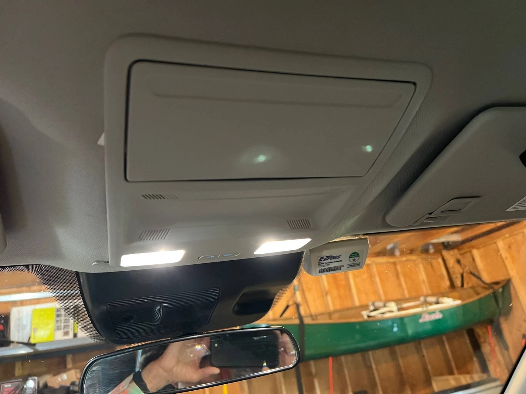

I am getting a light plastic on plastic buzz when the road gets bumpy. I have tracked it down to the overhead console. When I put pressure on the console either by pushing it into the headliner or pulling it down at the sunglass holder it quiets or goes away completely. I would like to remove or at least pull down the console and see what the issue is and try to correct it. Does anyone know how to do this. thanks

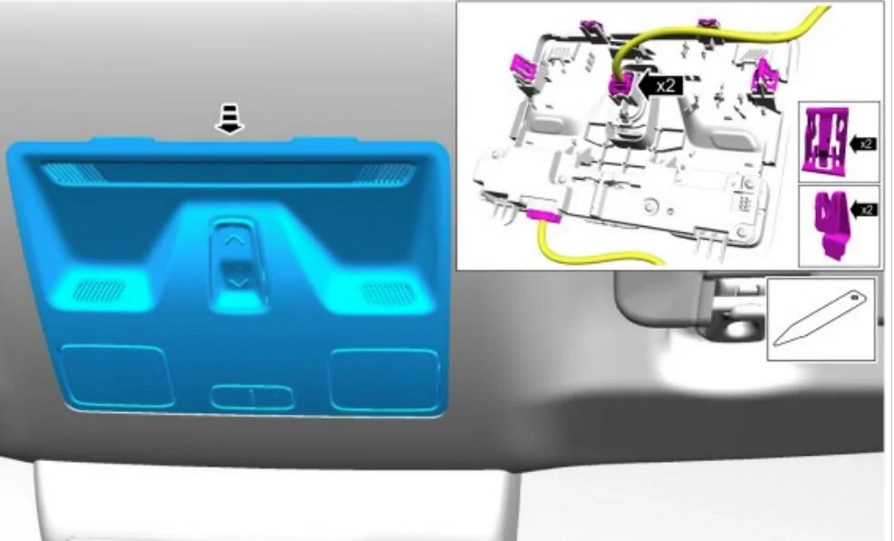

If you could show a picture of what you want to access that would be helpful, help us help you 👍

The Illustration seems clear enough. I tried releasing the clips, but Ford must have a special tool because it was impossible for me to leverage enough to free up the console Without damaging it. The last thing I want to do is to snap the plastic trim so I guess I have to live with this irritating plastic on plastic noise. It only occurs on poor pavement so it’s not like it’s a constant problem. I may have the dealer look at it when I bring the truck in for service.

This is how I have taken mine off:
  1. Open up the sunglasses holder
  2. Then put fingers inside, with thumbs on headliner
  3. pull hard, so it swings down
  4. then slide away from windshield
I have done this a few times.

It's not terribly difficult to remove but it does take some time and patience. You should definitely pick up some trim removal tools if you don't already have some because that makes it a lot easier. There are some good videos on Youtube that show to remove it.
