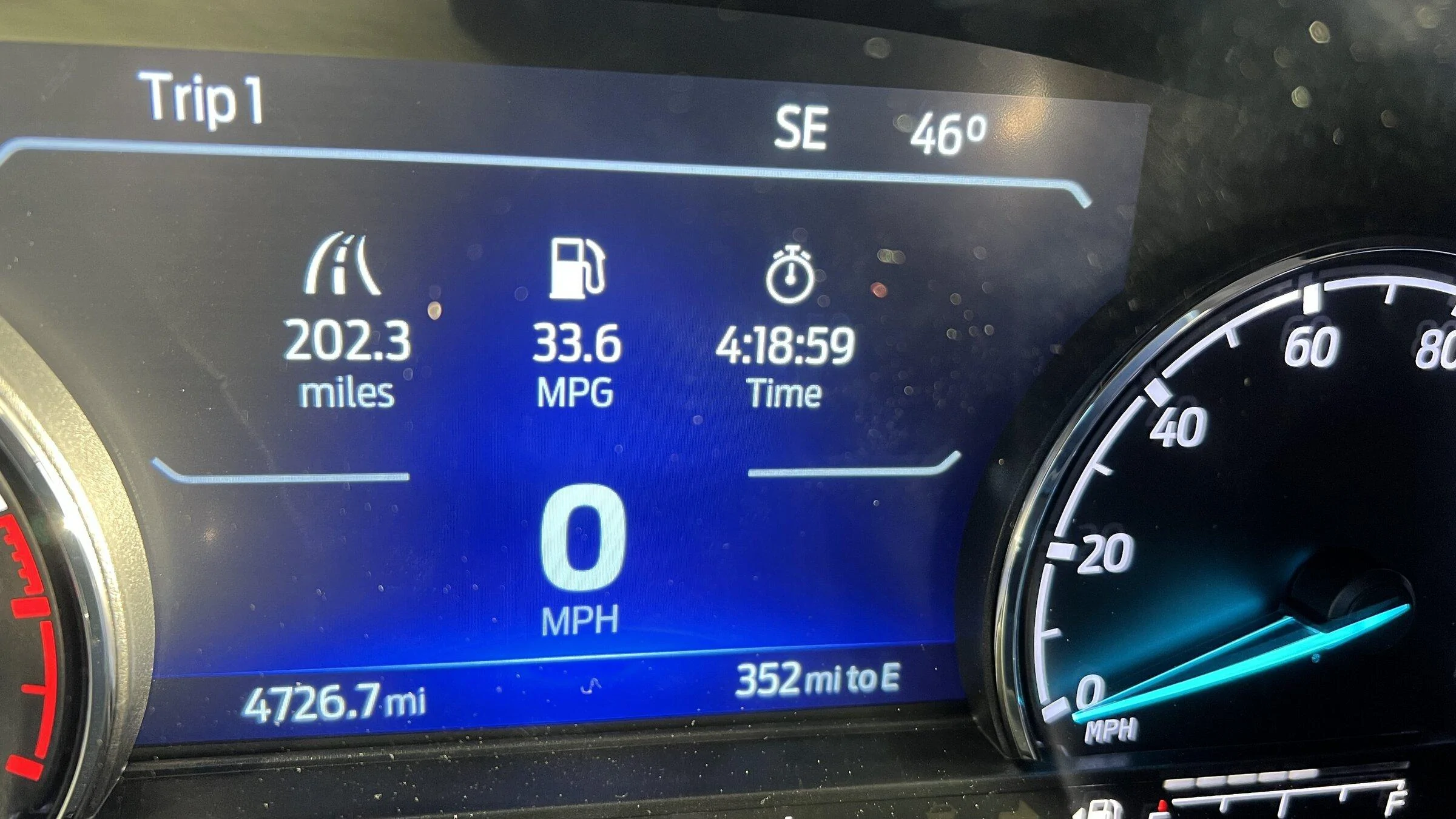

Just out of curiousity, how do you have 8.5 hrs of engine time for 191.4 miles? Seems there may be a lot of idle time there.
That is what I was thinking too. It is easy to sit idling for long periods playing with it when new. I did but I have yet to see under 28 mpg on the eco boost so I don’t know! I am anywhere between 29 and 35 in normal mode

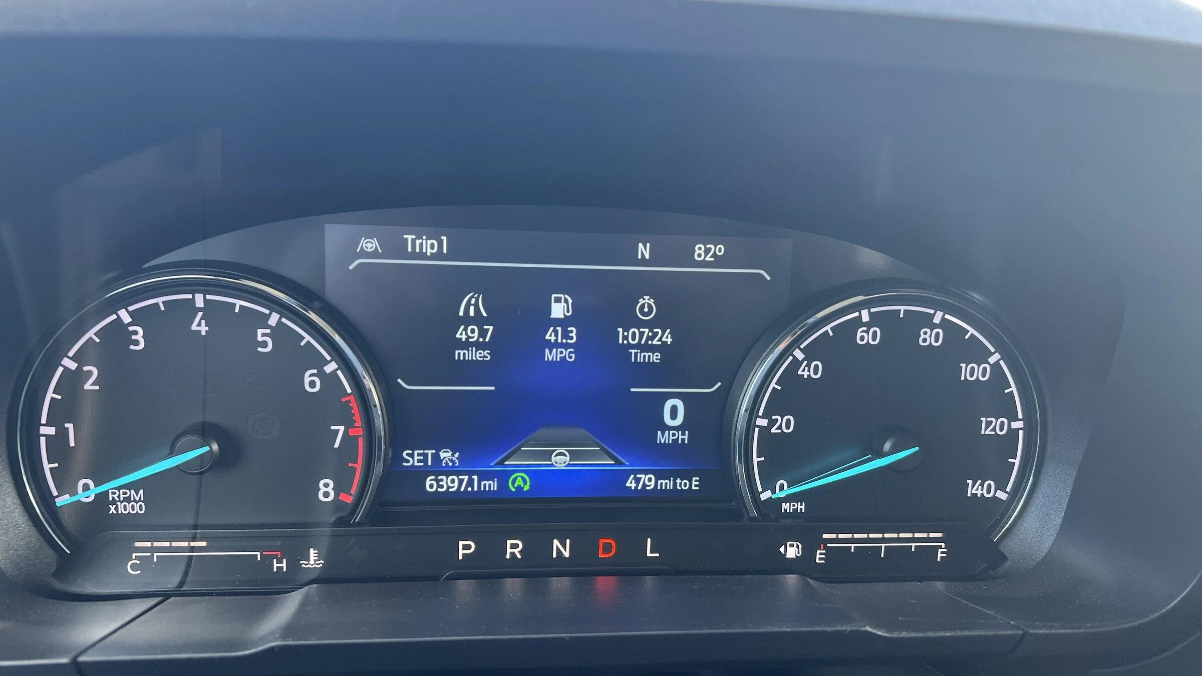

Getting great fuel mileage so far, was running 85 regular tho time. Just pasted 6300 miles. Running 45 to 60 on 2 lane.
Ford Maverick Ridiculously low Gas mileage ENOUGH already WTF is going on ? E568A699-2262-43A9-809F-06252992391E
