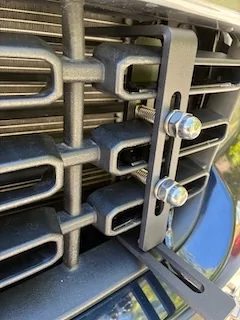

Inspired by @Darthie, I loved the look of the round driving lights mounted on his Tremor. However, I did not want to take the chance of removing the bumper only to discover the hybrid had no mounting holes for the bracket supports. Plus, the brackets were from one vendor and expensive ($60).
After much trial and error, I finally was able to develop a mounting system on the Lariat's grille. Keep in mind, the Lariat's grille is much more sturdy than the XL/XLT and I would not advise using my technique for those models. While I did not need to remove the bumper, I did need to loosen the grille assembly in order to pass through the wiring. Much less work. Also, the lights are advertised as driving/fog, but they are definitely more of driving light as there is not as much spread as you would hope for in a fog, although, they do come with yellow lens inserts. Total cost was around $100 including the lights, which included the harness and a switch. I added the brackets and used stainless steel fasteners.
I'm happy to send links to the products I used to interested parties.
Ford Maverick Retro-look driving lights installed on grille 238497-0de4ab7540c4f3c6e6bcdf3810695a74

Please send links to the products you used
Gladly.
Lights: https://www.amazon.com/dp/B0CNGG79QG?ref_=ppx_hzsearch_conn_dt_b_fed_asin_title_1
"L" brackets: https://www.amazon.com/dp/B09XM7FT9P?ref_=ppx_hzsearch_conn_dt_b_fed_asin_title_2
I used 1 5/8" 10mm (or you can use 7/16) size stainless steel carriage bolts to attach the L brackets to the grille. 'the carriage bolts eliminated the problem of trying to get a wrench behind the grille. For aesthetic purposes, I used acorn nuts on the front. And don't forget to use lock washers. All available at your local hardware store, although I favor True Value Ace for good service and selection.
I also beefed up the grille slats by gluing 4" mending brackets on them. If you look closely at the photo of the grille, you'll see where I placed them. That also evened up the rear alignment of the grille slots, so that the L brackets would seat evenly in the back.
