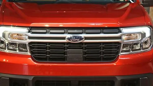

I drilled into my factory XL bumper from the backside with a 3/4" hole saw in reverse for a super clean cut and wired the Raptor style lights from the amber marker lights on the bumper.

First I want to say this looks great. I also want to say this can ONLY be done this way because the XL grill is the ONLY grill that will accommodate these lights. I kept looking at this post and knew something didn't look right. There are others who kept posting "is this a stock grill" and the OP kept posting "Yes".
Well, most all early Ford photos don't properly point out the proper XL grill and I still can't figure that one out. Maybe the Factory didn't use this grill in the early XL models or maybe it's just me? I do know by looking at SOME photos of XL models posted by actual Mavericks delivered the XL grill is unique!

Don’t understand why these lights couldn’t be installed into either XLT or Lariat. The spacing would be different but it looks like a 3/4” hole would fit either one.

I noticed the Lariat having a different grill but didn’t realize they’re all different. I want to say the Lariat has the active louvres at the top so it wouldn’t be possible

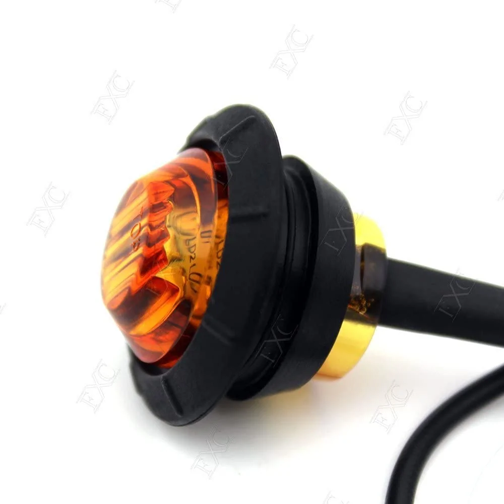

I took a close look at the photo of the back of the grill provided in the original post and I don't believe it will work. The light is bigger than 3/4 inches and I don't think there's room for the flange (seal) around the light without encroaching on raised areas of either of the other designs. The XL has such a "natural' area for these lights in the grill design.
I could be wrong -- wouldn't be a first.

Thanks for pointing this out! A lot of people asked what grille it is and it is stock! I like how mine is the only one where you can do 4 evenly spaced to make it even more unique. I haven't seen or measured an xlt or lariat grille but it could probably be done just like I did mine with however many lights they'd like!
