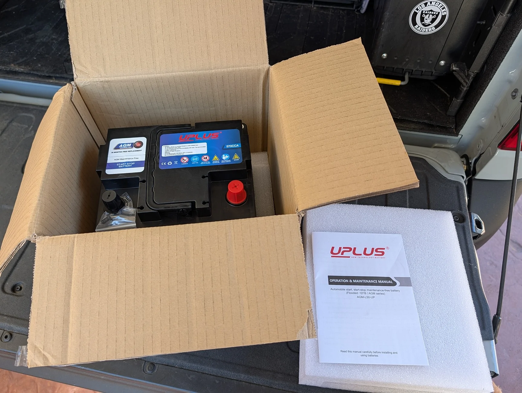

Recommend to purchase directly through www.uplusbatteries.com and try to use "Code 10UPLUS5CJ0EVH8" to see if you possibly get the 10% off the battery. Their original price was $139.99 minus $13.99 discount = cost of #126.00 with FREE shipping. Plus they offer very fast shipping and probably since buying it directly through the battery company website we hope for great warranty if needed. Good Luck BUT THIS NEW BATTERY IMMEDIATELY GOT RID OF THE DRASTIC BATTERY SLEEP MODE ISSUES!

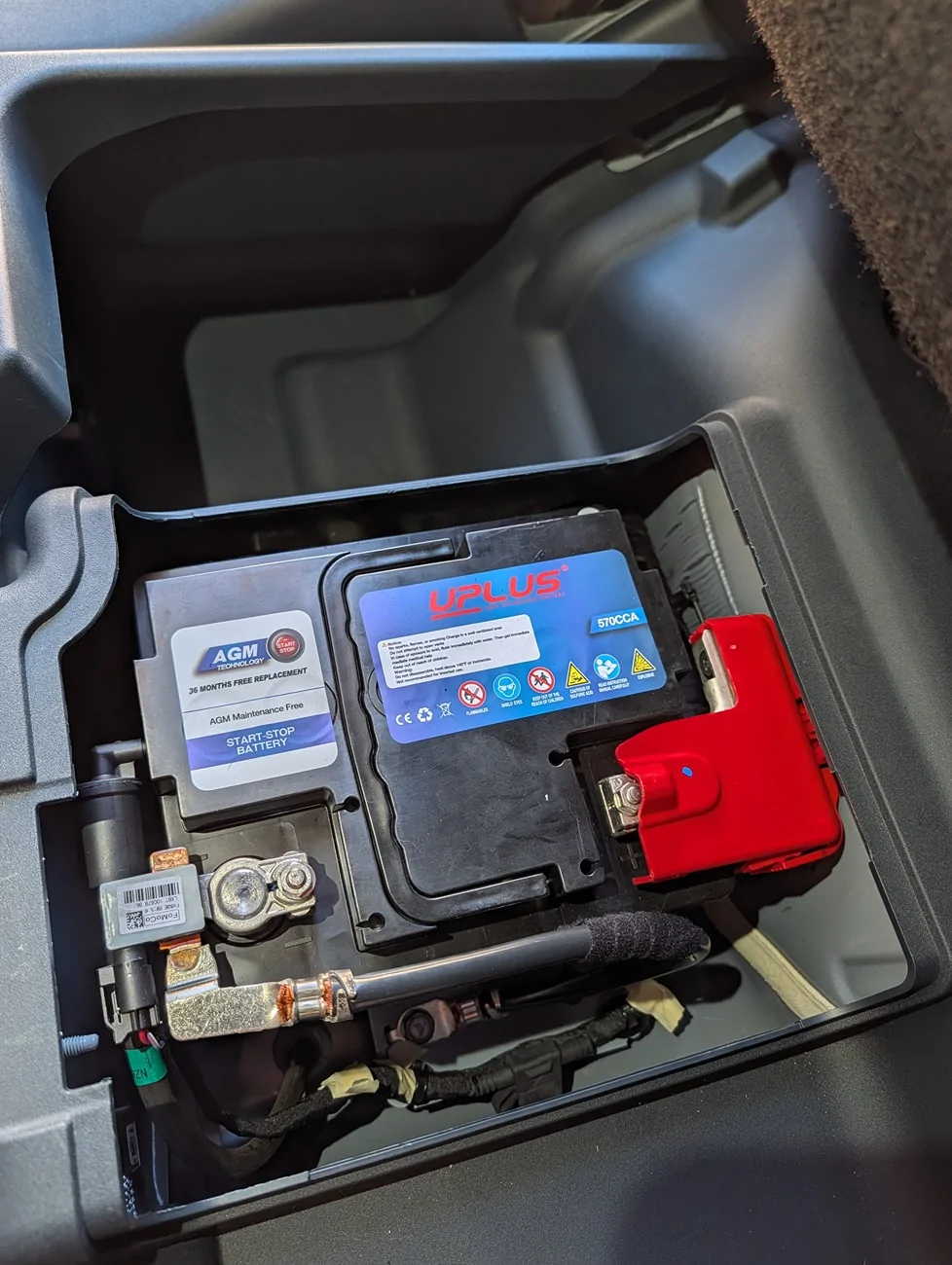

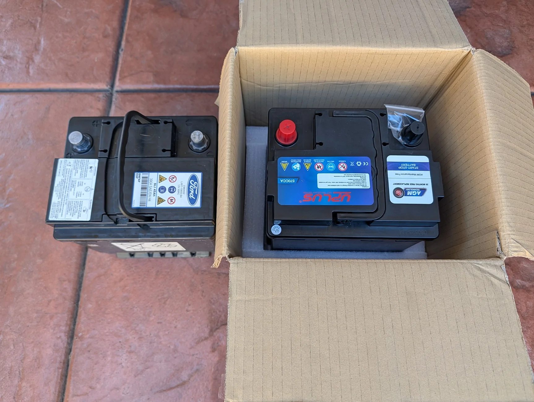

I just finished replacing the 12v battery with the one you recommended.
I got tired of the infamous, "Remote features disabled to ..." message popping up on my cell phone every single day.
I will post updates if it resolved my issues or if the gremlins continue.
But anyways, thanks for the link to the battery. It is reasonably priced compared to everywhere else.
You're very welcome! Glad to be of help. Life will be better without the annoying deep sleep issues.
