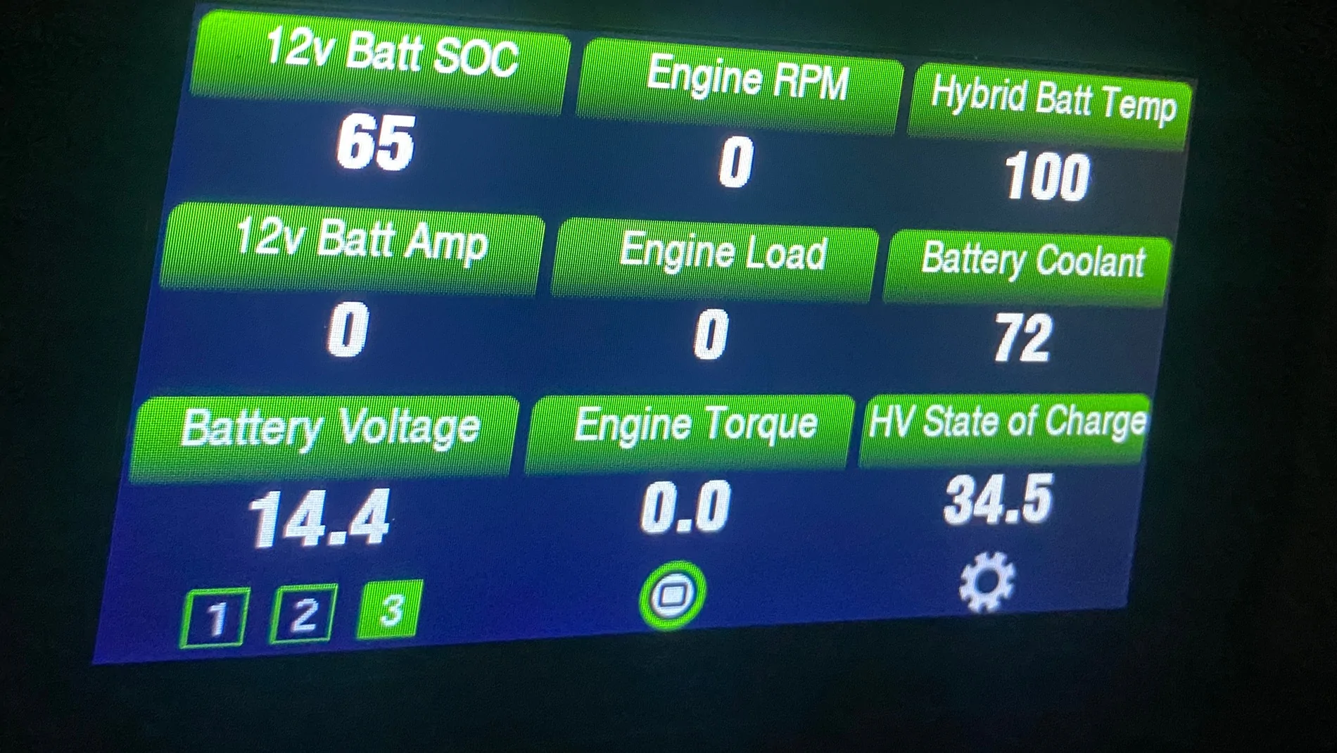

After 2 hour drive this:
Key to run in park.
Headlamps on.
65 SOC the entire drive

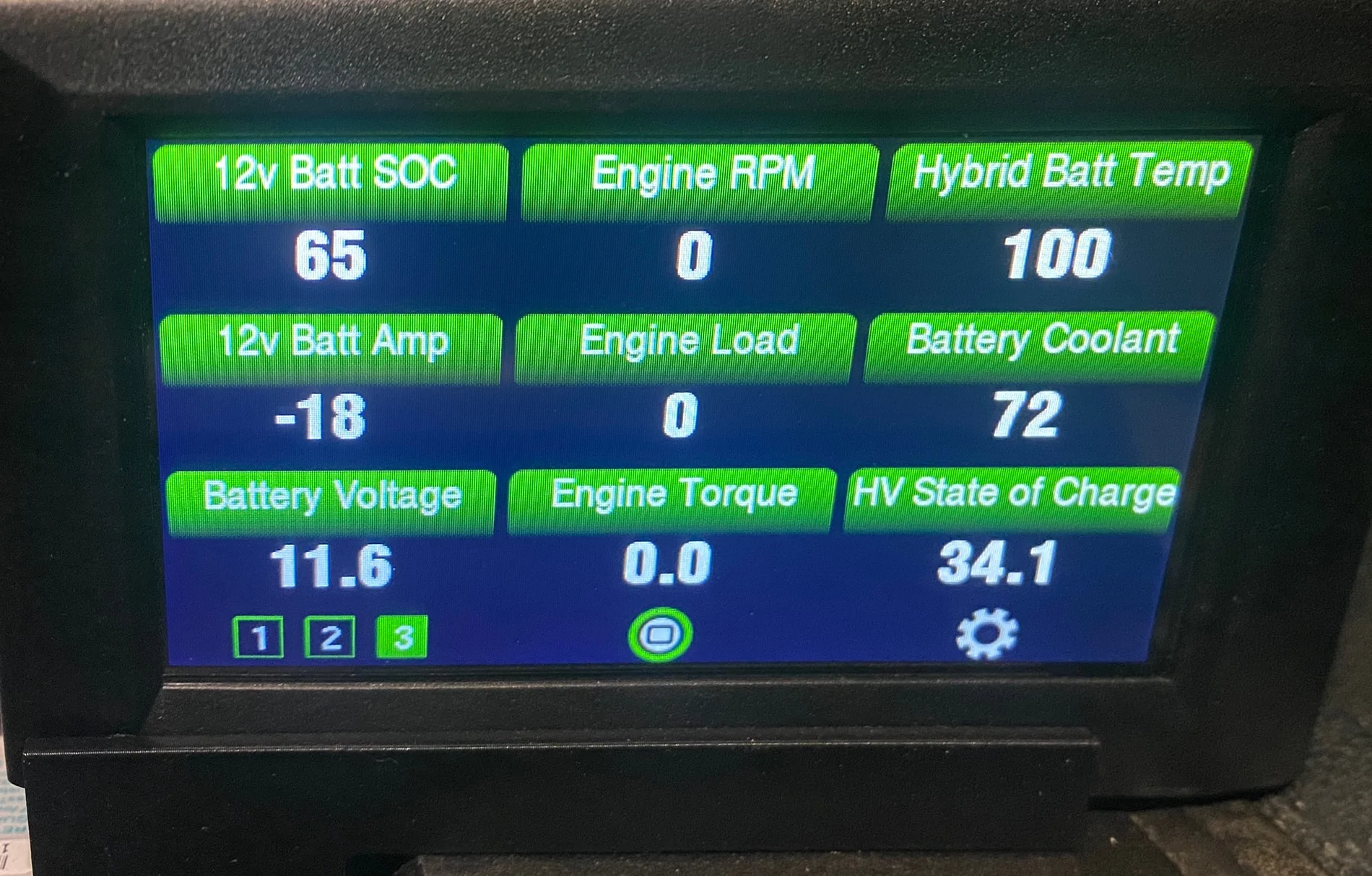

2 seconds after key is moved to off.
Headlamps on.
