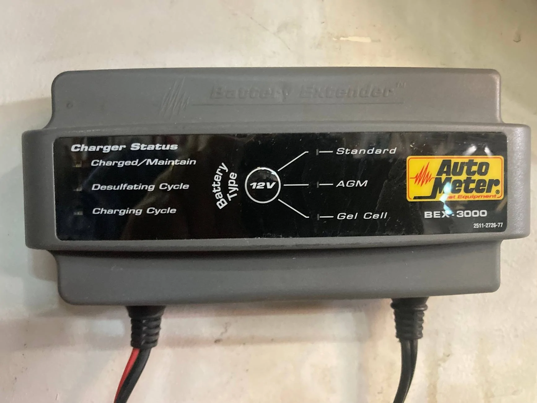

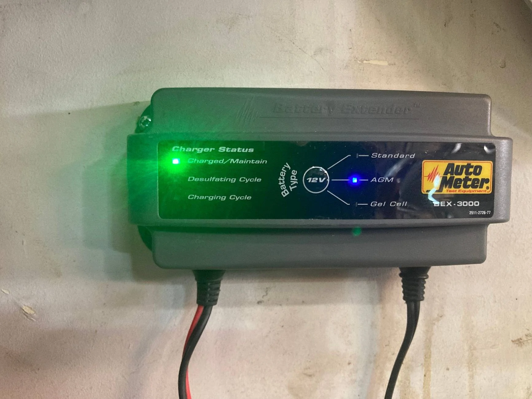

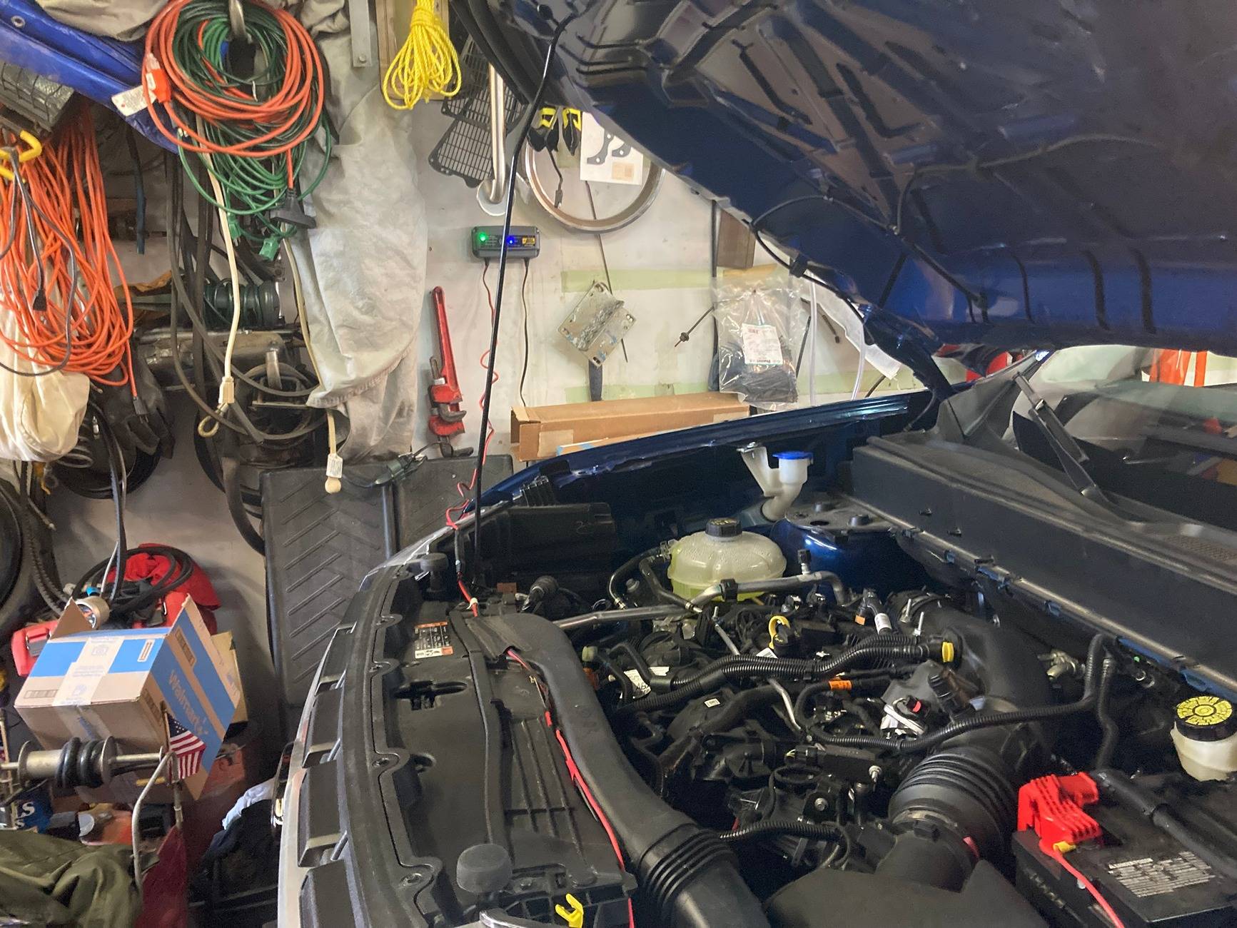

What I've done since 2013 with my F150 and now Maverick is whenever I know the truck will sit for more that a day or two I plug in a Auto Meter Battery Extender. I use them on any battery on my lawn equipment or vehicles and it has been amazing how much more life I get from the batteries. I even boutght outdated ones from when I was working for Advance Auto and one of them, 3 years old when I bought it, is still going strong with a 2012 date sticker on it! But, when I back that one in the shed, it immediately goes on the Extender!

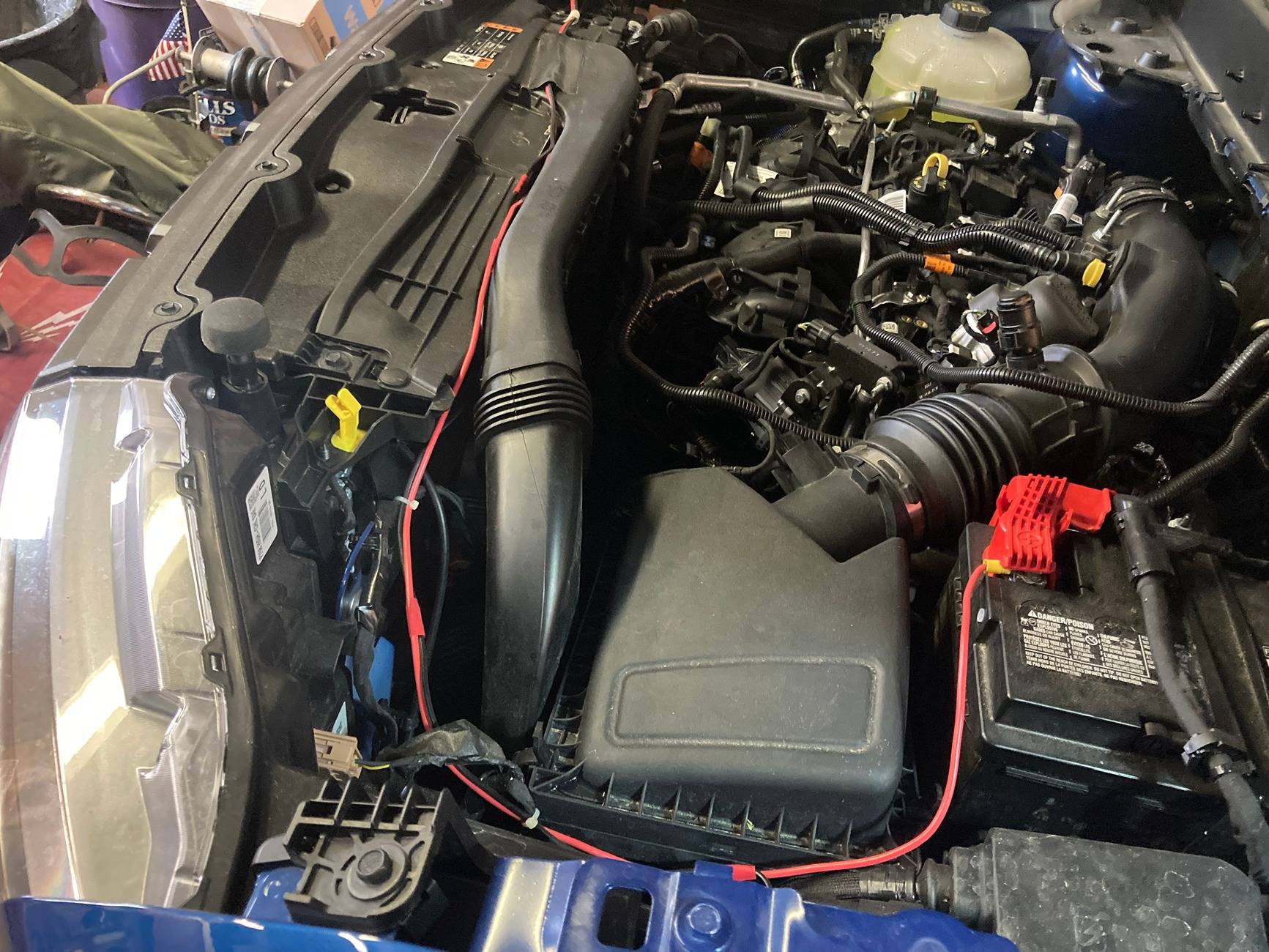

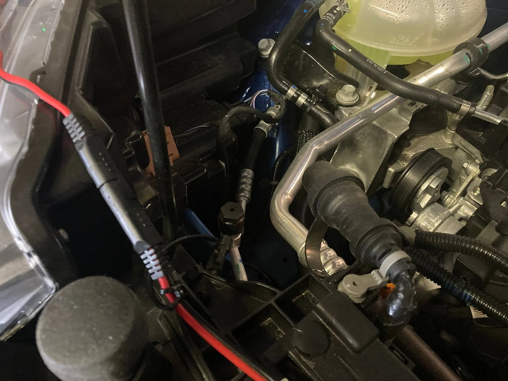

The installation is simple and the photos below show it working on my "Grabber" for you all. Model # is BEX 3000. It will charge at up to 3 amps and then maintain around 13 volts while providing any current draw the truck needs to keep the silent systems awake and running.

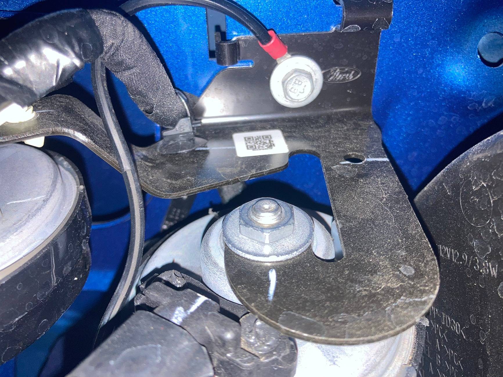

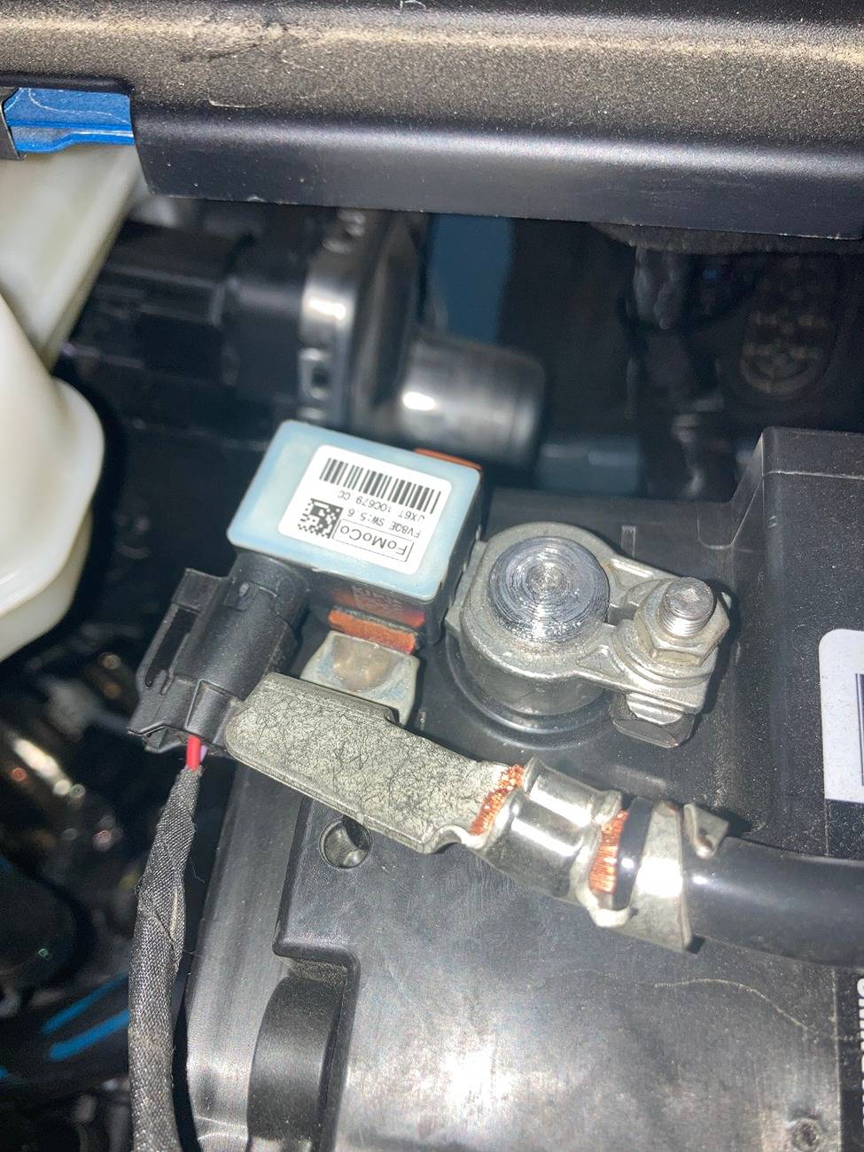

With the sensor on the negative cable, it is essential that the black wire in the harness NOT be connected at the terminal. Current flow needs to run through that sensor to enable correct battery state of charge to the PCM. It will need to be connected to a frame ground to emulate the alternator when charging and provide proper current flow. I did need to lengthen the connector harness due to where the wall mounted unit is on the side of the garage where I park.
Ran the red (+) wire to the positive battery terminal and then the black (-) to the horn mount as shown in the photos.
There is also an automatic desulfation mode that will try to rejuvenate and older battery. Works great on mildly sulfated batteries. I've had that going on with my winter tractor which has a 2008 battery. That one will probably get replaced this year as I can hear it getting a little weak while cranking that 19 horse Kohler! I traded the F150 in with a 7 year old battery that still tested at 90% capacity.
