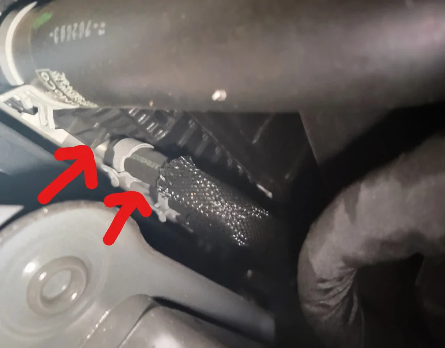

You can easily see the 2 lines running around the left side of the radiator.
Thank you for picture - I presume that is the correct Lobo radiator?
My recalled Lobo has those same hoses. I think most (all?) EB’s do?
But I thought the Lobo has a more robust transmission cooler? Do the other end of those hoses connect to a different cooler?
My build date was 3/25/2025, so i thought for sure mine was in the recall, but it does not show up when I entered my VIN on the Ford website. I still wanted to check, and someone posted the part number of the correct radiator, and mine matches that as seen in post 94 above, so I'm hoping it's the correct one?
I think you have the correct 4K towing package - but those hoses you pictured are not conclusive evidence since we all have them….even 2K folks.

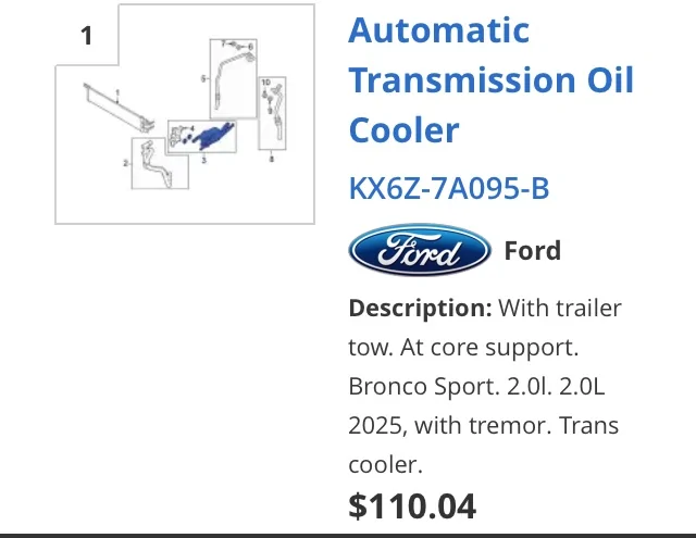

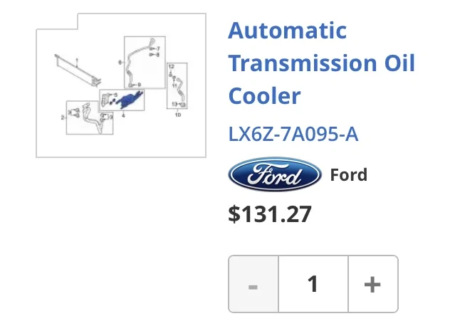

Ok - the base Lobo does not have an “upgraded” transmission cooler.
It does have the larger radiator & fan.
Below are the part# for the standard trans cooler ( -A $131) and the tow package trans cooler ( -B $110).
Base Lobo has the -A….
I've read on numerous reviews that the Lobo also had the trans cooler from the 4k tow pkg?
I read & watched those same reviews claiming the upgraded trans cooler. Now I’m beginning to think they were wrong/misled similar to the 238hp snafu.
Seems both Base & High Lobos got the larger radiator/fan. High Lobo also got Trailer Assist.
But neither got the 4k trans cooler despite the many reviews saying it did? Confusing.
