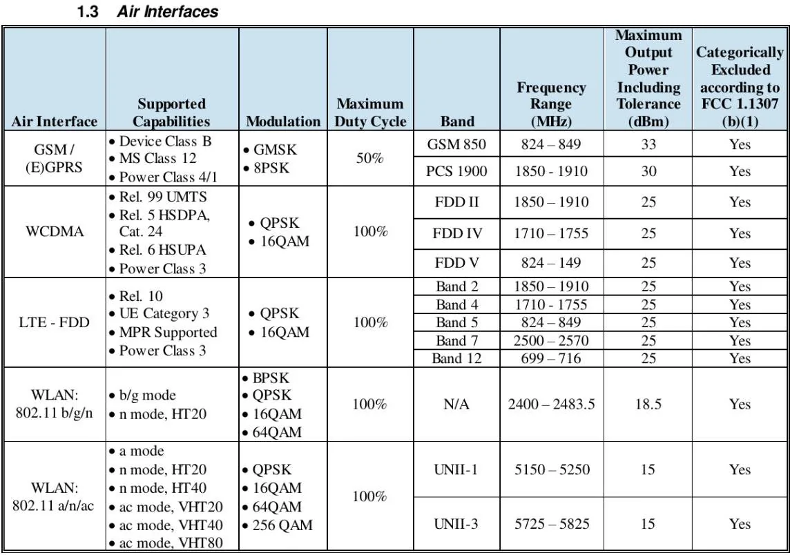

TCU FCC ID = LHJ-FB40ND1
https://fccid.io/lhj-fb40nd1
PDFs work on the site, but not the photos.
The Cellular radio transceivers, (deleted WiFi Hotspot) are in the TCU
https://fccid.io/LHJ-FB40ND1/User-Manual/FB40-ND1-Installation-Instructions-v6-4095147.pdf
https://fccid.io/LHJ-FB40ND1/RF-Exposure-Info/FCC-RF-Exposure-31854560-001-Rev2-4098281
Ford Maverick Removing the Telematics void the warranty? Continental FB40-ND1 Cell, WiFi

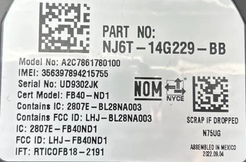

Ford TCU from ebay with same PN as my Maverick
Ford Maverick Removing the Telematics void the warranty? Ford TCU PN NJ6T-14G229-BB
