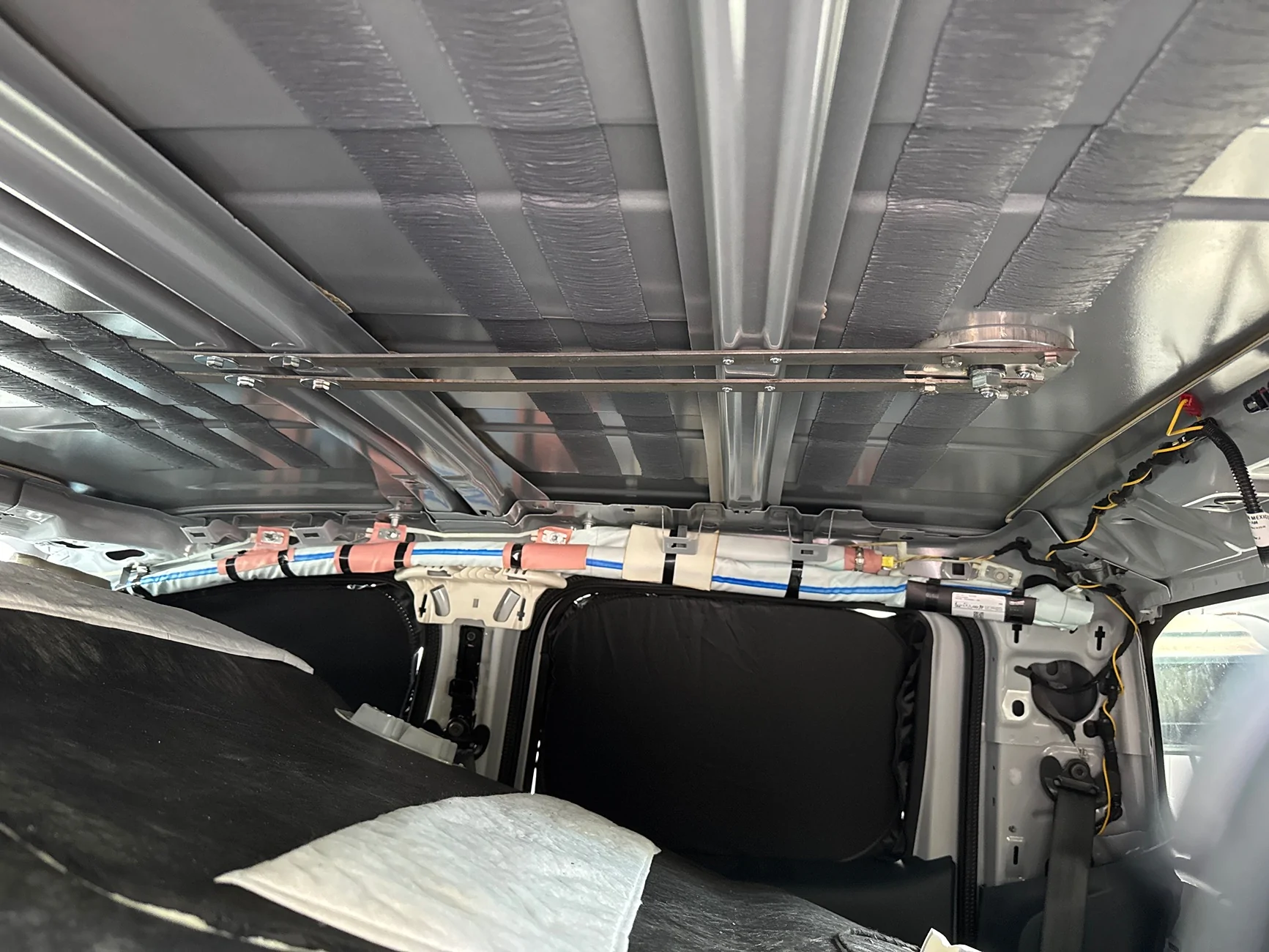

Incidental to the roof flex, here is my solution on the Maverick, and it feels rock solid. Puck in the rear, self tappers in the center, and rivnuts used on the forward attachments
