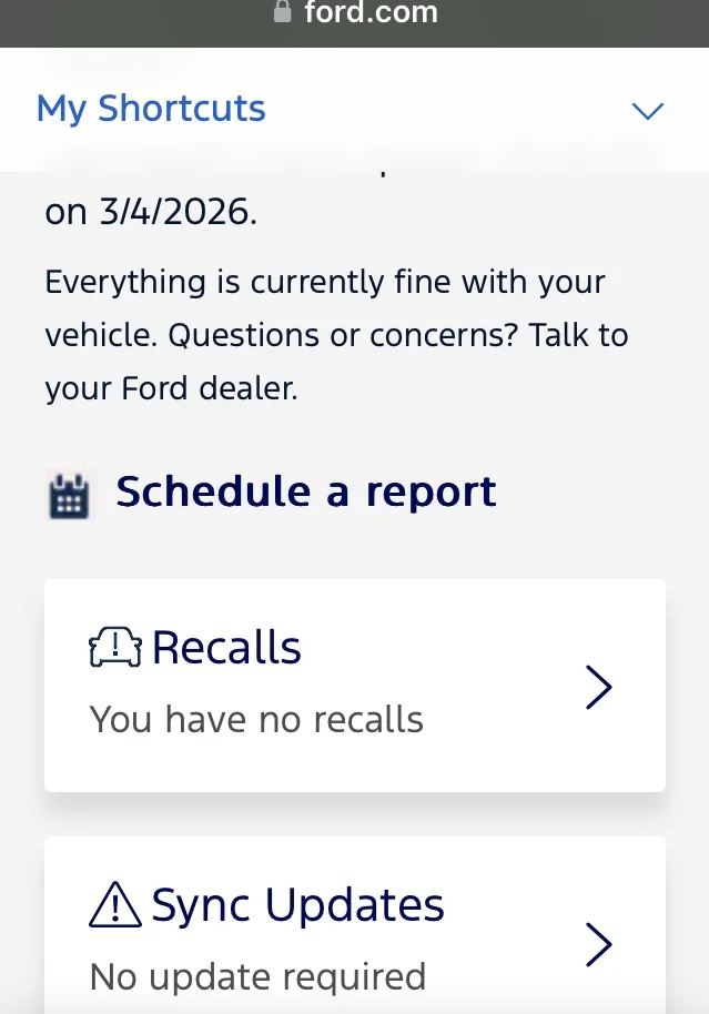

I am not connected to Ford App - but still need to pull fuse 11.
I do login to Ford.com to enter my DIY service records no problem. When I check “Vehicle Health” I get this message:
Ford Maverick Questions for those who have pulled the #11 fuse (telematics) IMG_0645
I’ll see if this changes after I pull fuse 11. I know I did not answer your question - sorry!
