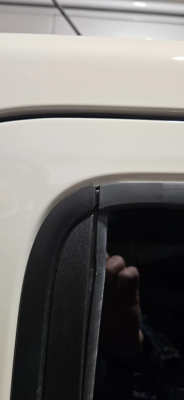

Has anyone else had the trim on the rear door windows separate, and if so how did you fix it. This has happened on both driver and passenger rear doors.

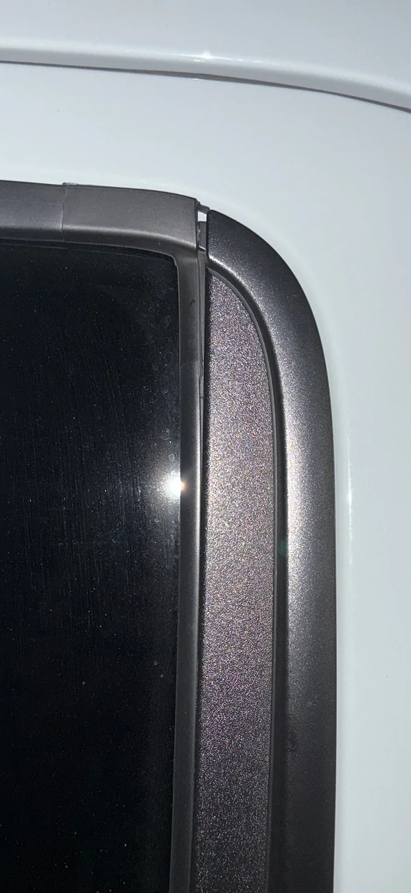

Yes. 2022. Haven't done anything.

I just took this picture.
2023 passenger side rear door.
Yep mine is separating 👇 too.🙁

Looks like you have a 2025, wouldn't this be covered under warranty?
It should be. I'll find out tomorrow as I'm taking it in for regular service and will ask then. Just wanted to see how common this is (ammo for my conversation) and what others have done if anything.

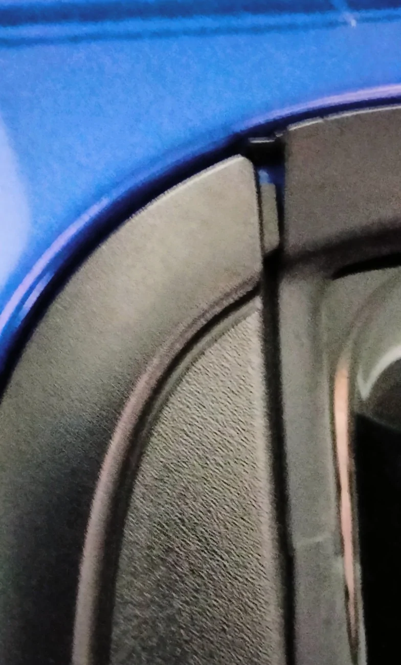

I just checked my early 2025 Lariat, same thing both sides.
I guess I will have to pop by my dealer as well.

Ford Maverick Reardoor window trim separated 20260319_205523
Ford Maverick Reardoor window trim separated 20260319_205550

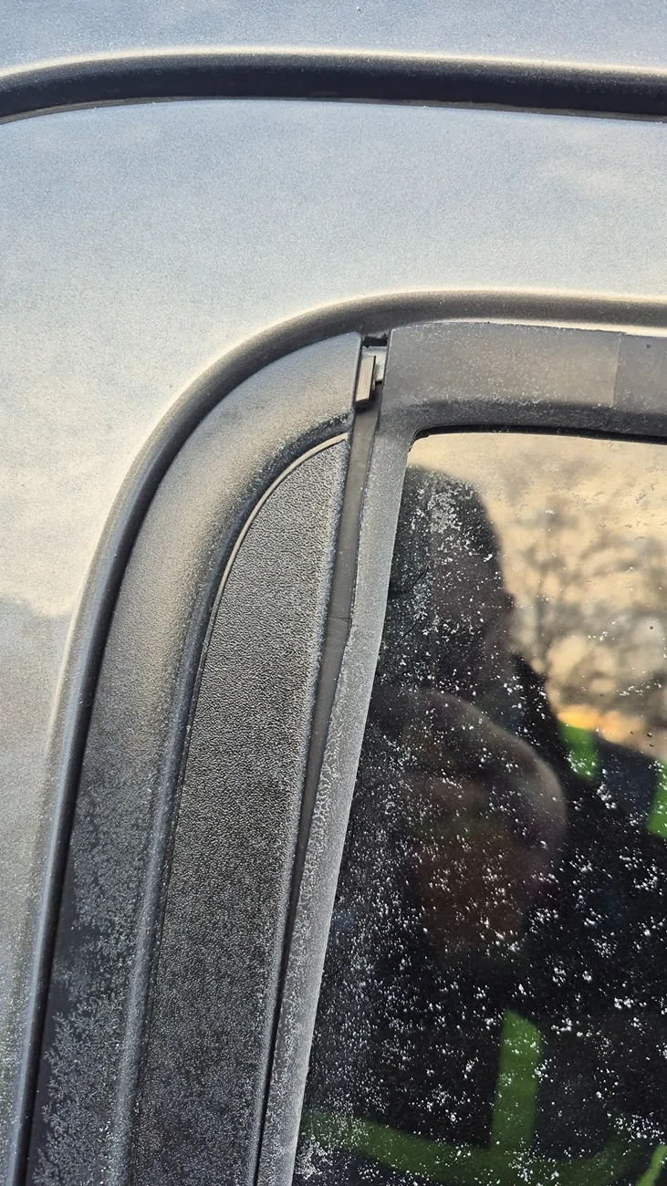

Well crap, I just went and looked at mine and it has that starting on both sides, more so on drivers side. Looks like the rubber is shrinking and pulling away.
Was going to say this, looks more like the rubber shrinking and pulling away versus the plastic trim moving.

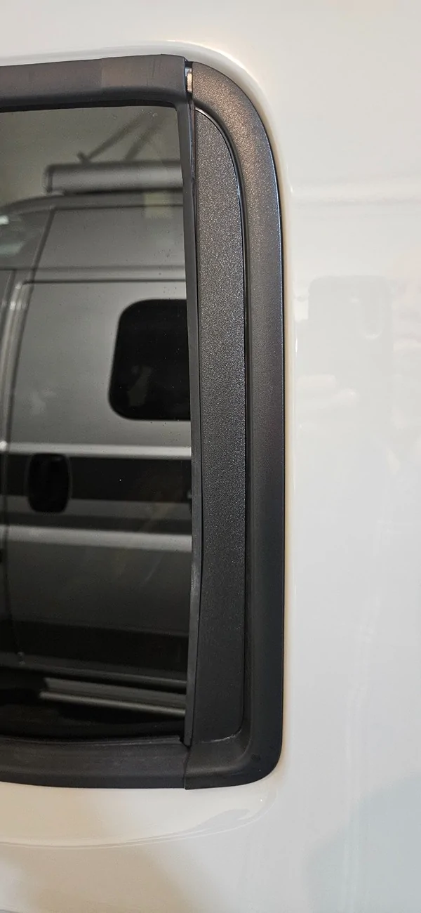

I think my in-channel visors are helping to hold these pieces together. 1/16" driver, zero on passenger side.
Went to dealership today. Parts on order. All covered under warranty.
