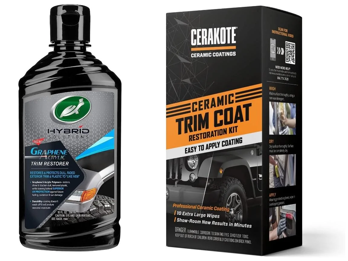

Not on those spots yet,but yes on the black plastic cladding on the bottom of the vehicle. I treated it with a turtle wax refinisher product and it helped.our vehicle is parked outside in Michigan.

Cerakote, amazing stuff.
CERAKOTE® Ceramic Trim Coat Kit - Quick Plastic Trim Restorer - Ceramic Coating Black Trim Restoration to Last Over 200 Washes – A Ceramic Coating, Not a Dressing https://a.co/d/0fU1ktk
