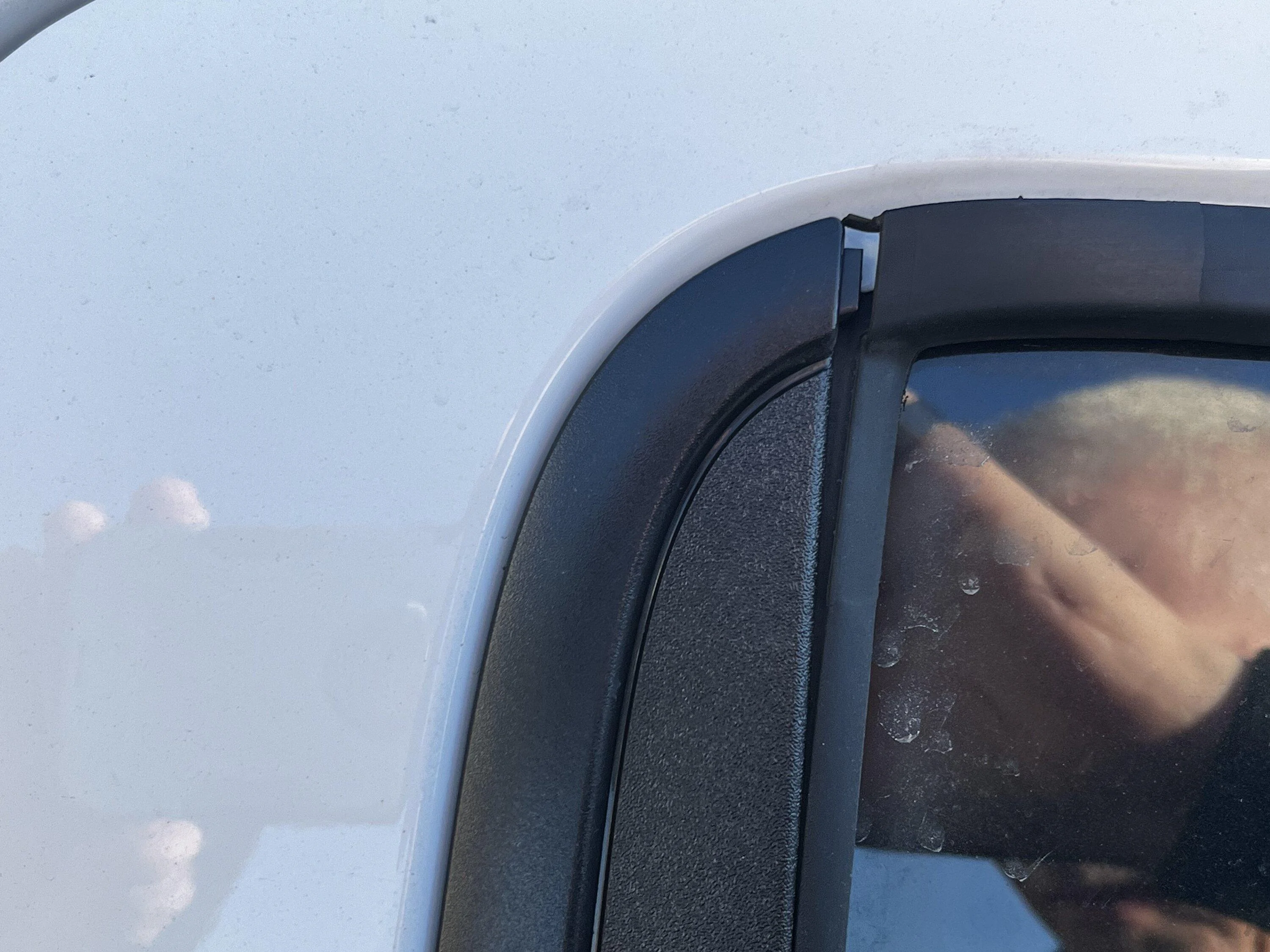

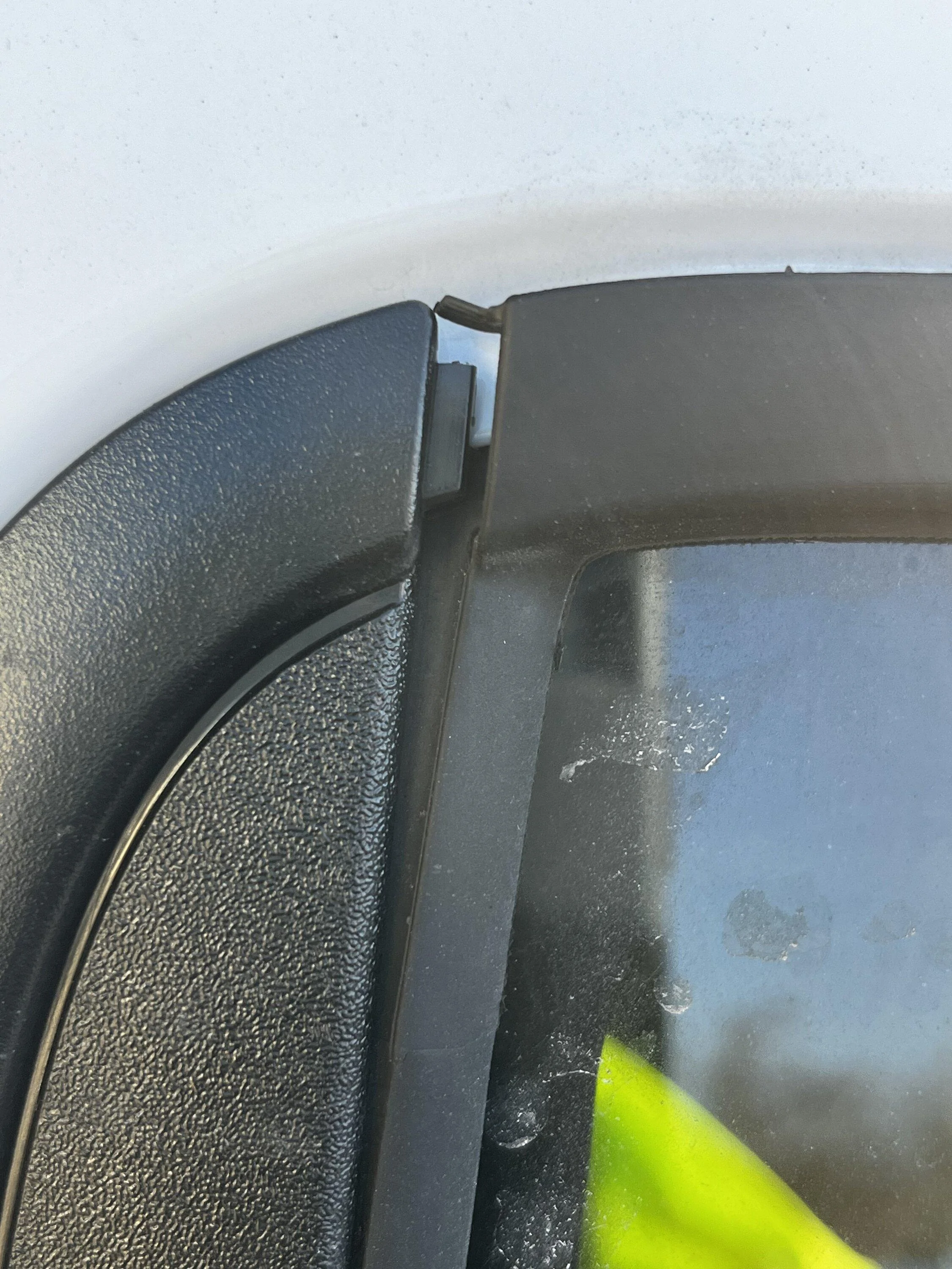

Has anyone else noticed that the window trim is separating, specifically on the rear windows? It almost looks like it is shrinking . . .
I'm going to point it out the next time I bring the truck in for an oil change - I will keep you posted.

Year, Trim, and Mileage? Do you garage it, or store it outside? Additional information would help.
2022 Lariat EB with 22,000 kilometres, stored outside in Ontario Canada.

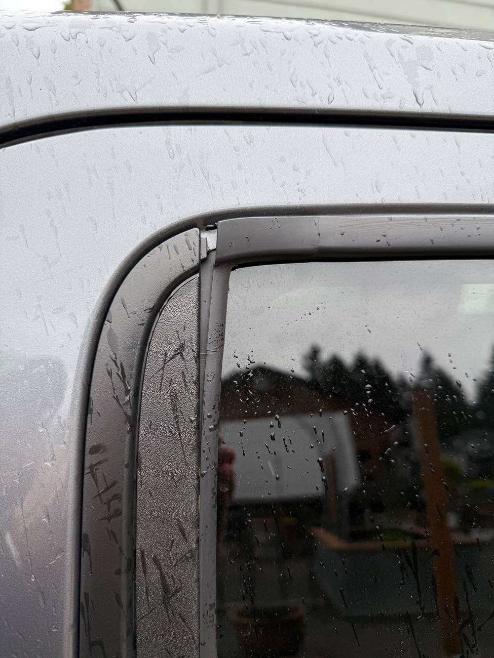

I just noticed today I am having the same issue on my '22 (20K miles).
Anyone else? If so, any experience getting it fixed under bumper to bumper warranty?

I don't have this issue but you should be able to roll the window down and with your fingers tuck that window trim back into its channel. If it won't go in time to go to the dealer.

That looks exactly like mine did (OP)
Dealership order new window rubbers and replaced them free-of-charge - but it is a day-long job as the entire door needs to come apart in order to replace them. Make sure that you double-check everything when you pick up your truck - my rear door-locks did not work afterwards, so it was another trip to the dealership for me, lol.
Kudos to them, they made it right by giving me a $200 detailing package to be used at my discretion.
Thank you for the follow up and the tip. I will need to think about it.
I am leery of them fixing anything (same reason I haven't had the airbag recall done) that requires much disassembly.

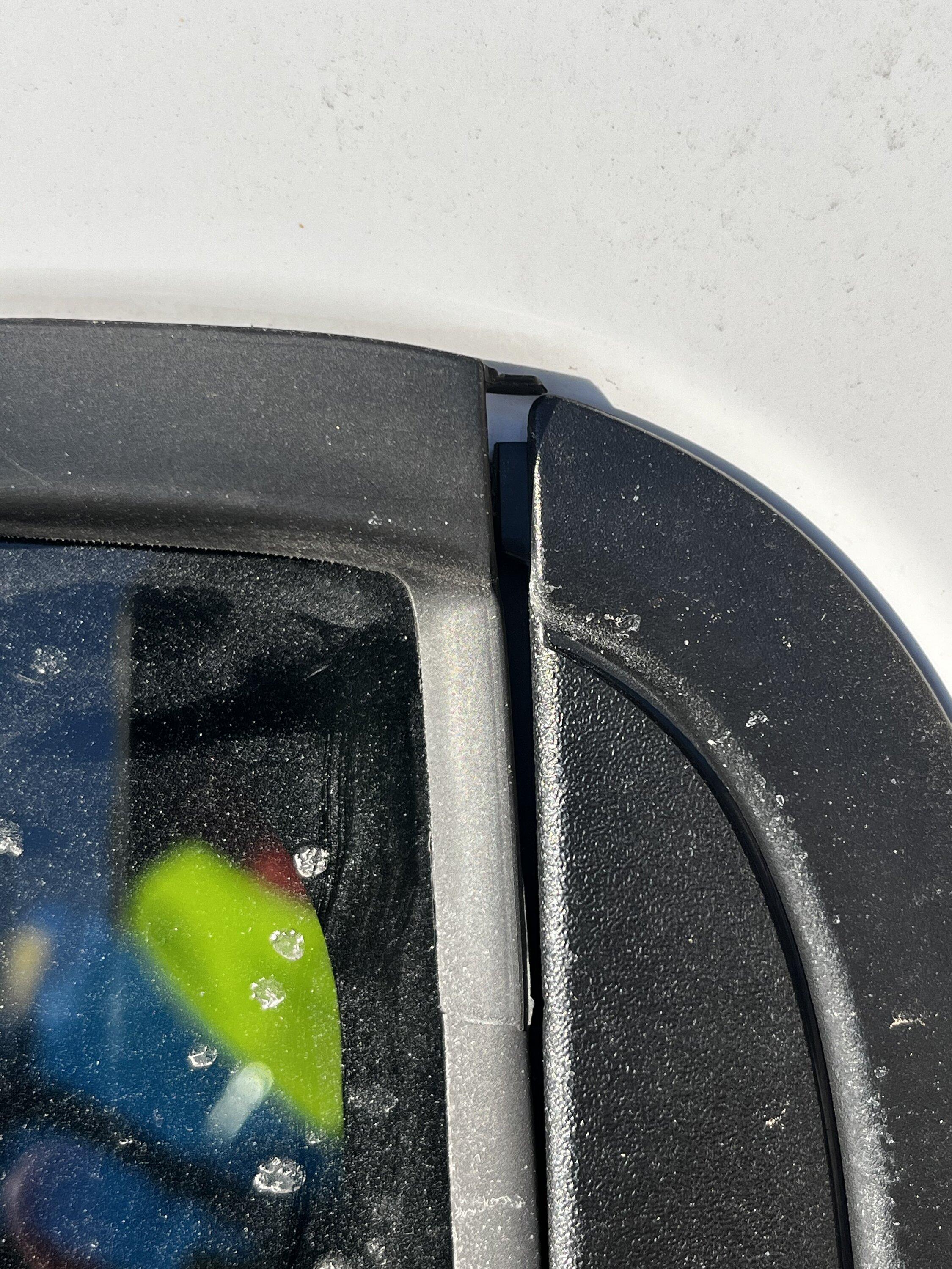

Happening on both of my rear windows. 56k Miles so beyond the bumper to bumper warranty. Does anyone think Ford will cover this since it is a common problem? If you had it fixed, did it last or did they use the same parts? Has anyone been successful with another fix?

Decided to try and fix it. In the warm sun I pushed it/slid my fingers along the length of the window toward the gap and it stretched and closed up. Looks good now. I think I will keep it treated with 303 protectant to help keep it pliable and maybe reduce shrinkage and see how it goes.
