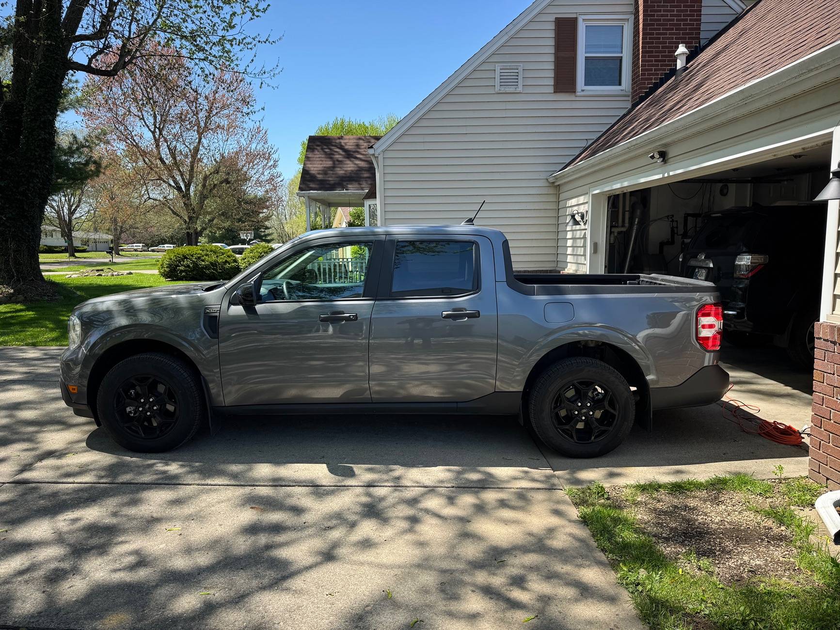

Installed the lobo rear springs today and removed the fx4 stickers. Changing the rear springs lower it about an
1 “.
1 “.
Did it change your driving confort or handling. Usualy they match the front and rear spring rates for better balance and manuverability

What did this cost? I'm assuming that it would cause warranty issues if they could blame the change in springs? I really like the even look though!
samandsuzy
SAM
Apr 14, 2025
Crawfordsville, Indiana
2024 XLT. FX4
Depends on the dealer. I think I paid 150 for both springs
I did not notice any difference
it is hard to tell in the pic. The back is only 1” higher than the front now

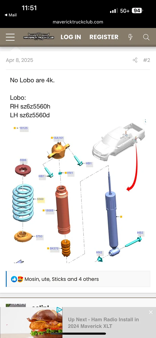

I also do not like the raked look on these trucks. I’m a bigger fan of the level look but don’t want to chew up CVs just for a look. I was wondering if you could provide the part numbers for the LOBO springs. Appreciate it. Truck looks great
