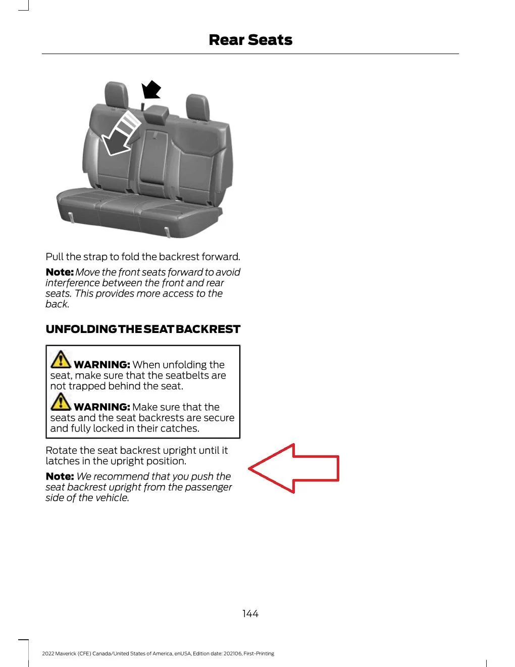

Mine was doing the same thing I did with the manual said how I finally fixed it was I followed another person's idea I just took the two screws out put two small washers behind the bolt screwed it back in and it latches fine now It only moved it out about a 16th of an inch and that's all it took.

All I did is took somebody else's recommendation put two small washers behind the screws and now it works just fine.
