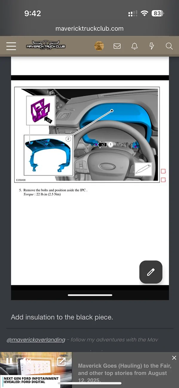

I have this vibration buzzing all day every day regardless of temperature in the cowl above the instrument cluster… see attached video with volume way up… and the young Ford mechanic said he couldn’t hear it LoL. There are several posts about it but it doesn’t appear to be a TSB yet. I am going to the dealership because it should be a TSB by now. I also attached pics of the cowl removal, but it doesn’t say what to put inside it once it’s off to stop the buzzing.

Not sure if it's the same issue, but I had a vibrating rattle in the area depicted.
It was fixed with a shim. See photo.
