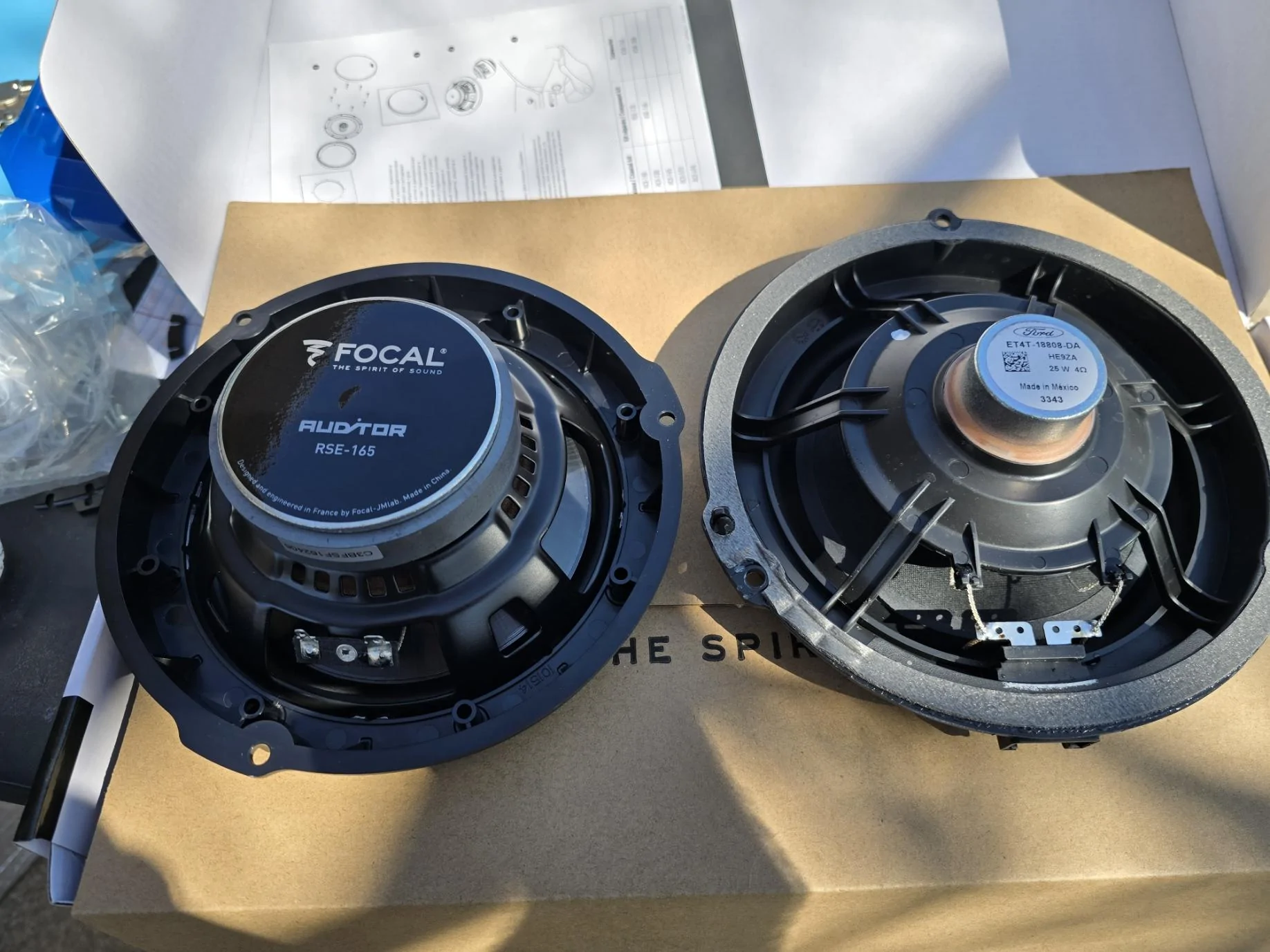

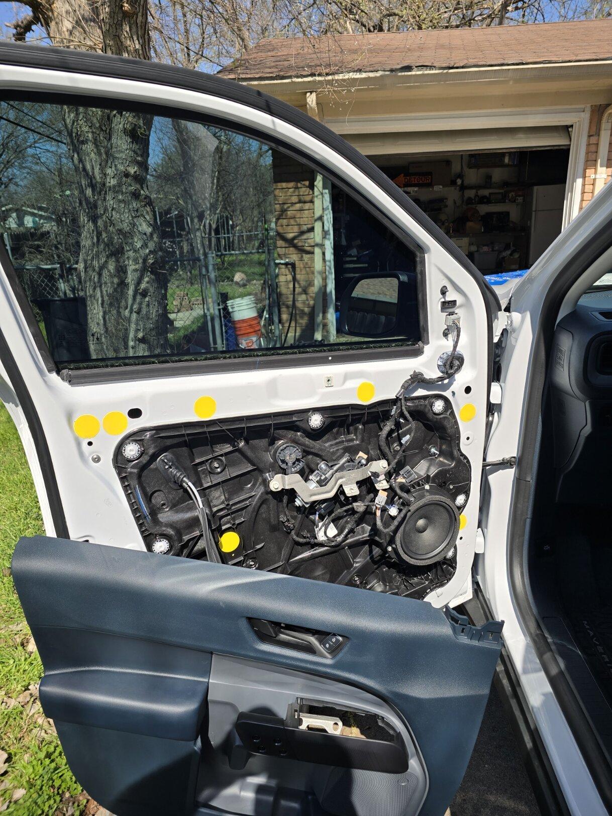

Got the speakers put in last week. BIG upgrade, even without the DSP. With the wiring harness and mounting adapters from crutchfield, this was super simple and everything dropped right in.

The tweeters were a different story. The harness that Crutchfield send for the tweeters did not work, so I ended up having to cut off the factory plug to wire in the crossovers. Not really a big deal. The aftermarket tweeters were slightly larger than factory, so I had to use a dremel to widen the opening a few mm. But after that, they dropped right in and they sounded much better.

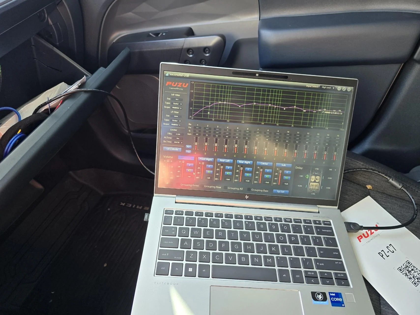

The Puzu DSP came in this week and I got that installed and WOW. Another huge difference. Haven't messed with the tuning too much in the Puzu software, but even with the default tuning, it sounds incredible.
Ford Maverick Question about upgrading audio and adding a subwoofer. puzu

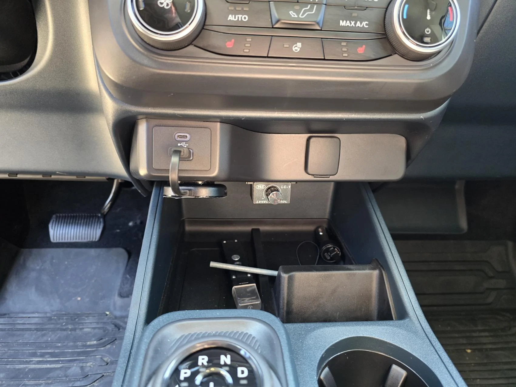

Puzu included the harness adapter so that install was also a breeze. Popped off the climate control panel, wired in the harness, and it was good to go. For now, the Puzu is just sitting in my glove box. When I run the wires for the Sub/amp, I'll tuck it up behind the glove box. Since I had the dash open already, I went ahead and ran the wires for my bass knob. It's not connected to anything yet, but I shouldn't have to open the dash anymore.
I'm a bit confused by this sentence. The RSE-165 are a component set with an outboard crossover. Are you saying you placed the crossovers in the dash and tapped the OEM tweeter wiring to feed the crossovers, then ran new speaker wire from the crossover to the woofer and tweeter? Nothing wrong with that; I just assumed there wasn't really room in the dash for that and most people were mounting crossovers in the doors, tapping the woofer OEM wiring.
