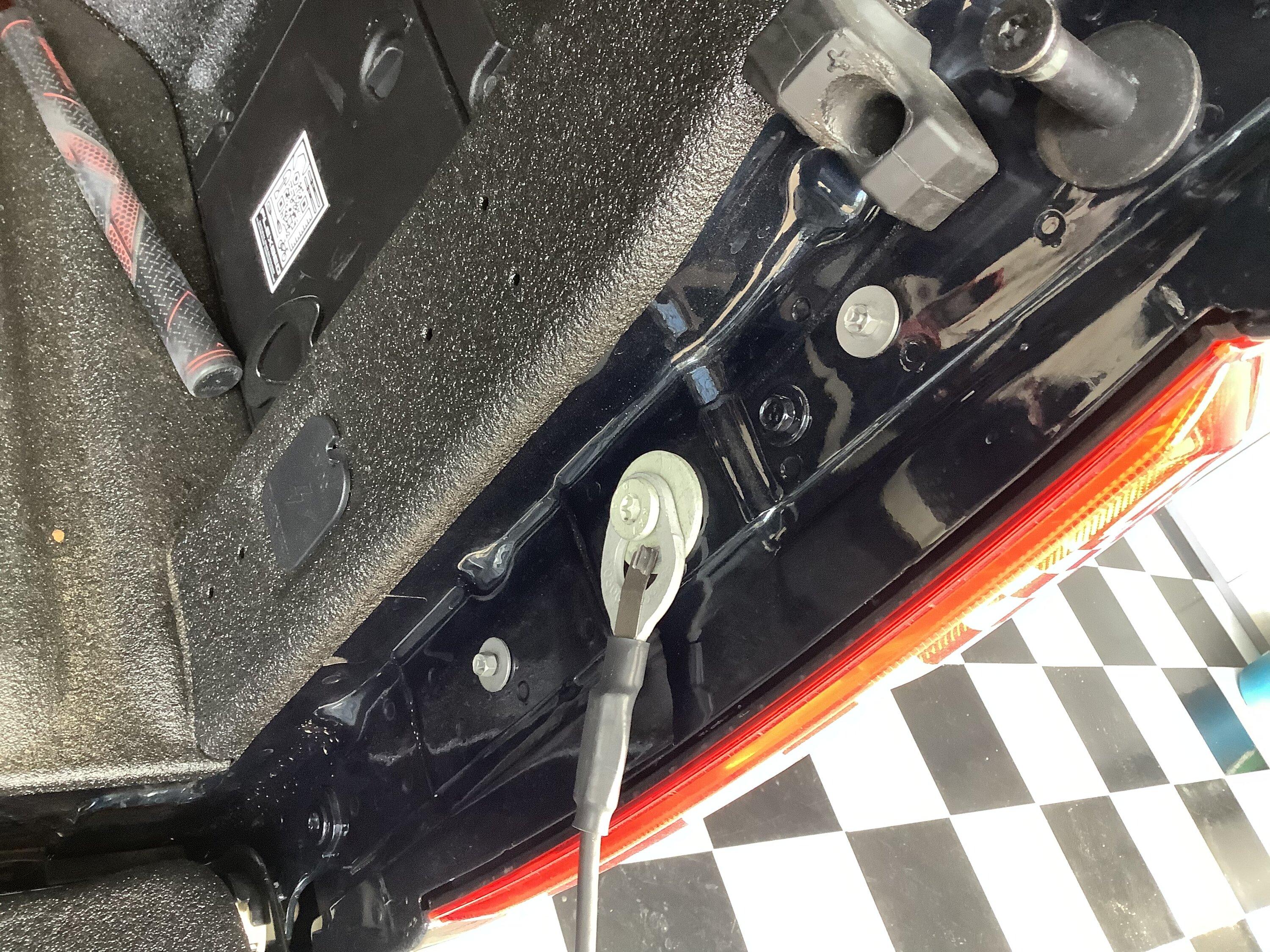

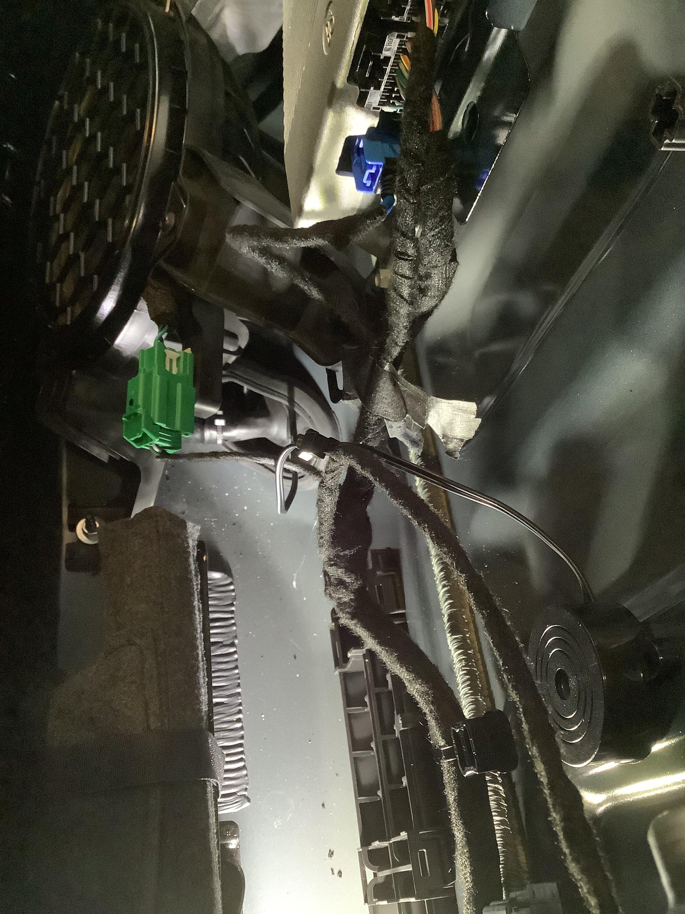

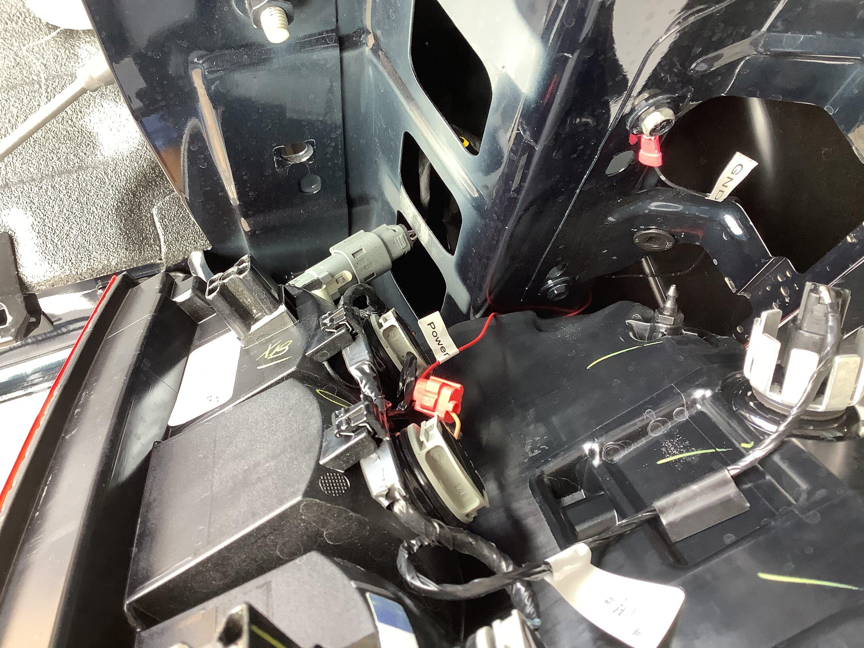

I added reverse sensors and used the tail light on the passenger side. This is on a lariat eco boost. Pretty easy to remove., drop the tailgate and remove the two silver bolts on the sidewall. The light pops out, power wire is kinda yellow, the other two are black. I ran the line under the left side of the truck behind the rear seat. Seemed to be the easiest route. That’s where I put the chime. Hope the photos help

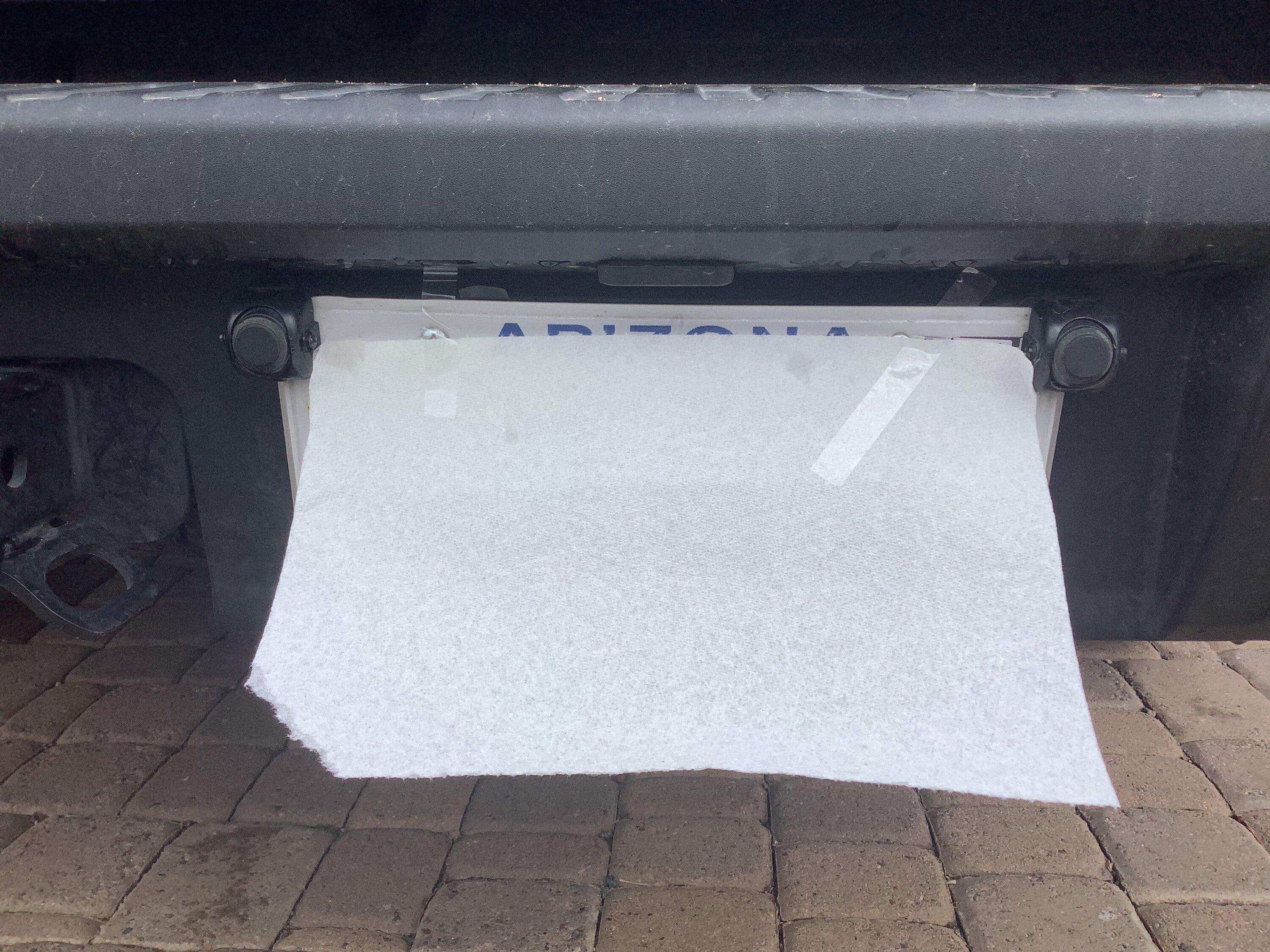

Sorry, I did not place sensors in the bumper. I went with a license plate sensor setup.
Hopkins 60100VA nvision backup sensor system. (Amazon)
This was gonna be a temporary solution and I planned on putting in the bumper sensors later. Haven’t got around to it yet, but this system works pretty good. I don’t think you have to remove the bumper, check for some other posts that have added bumper sensors.
How did you route indicator/ speaker up front to cab?
