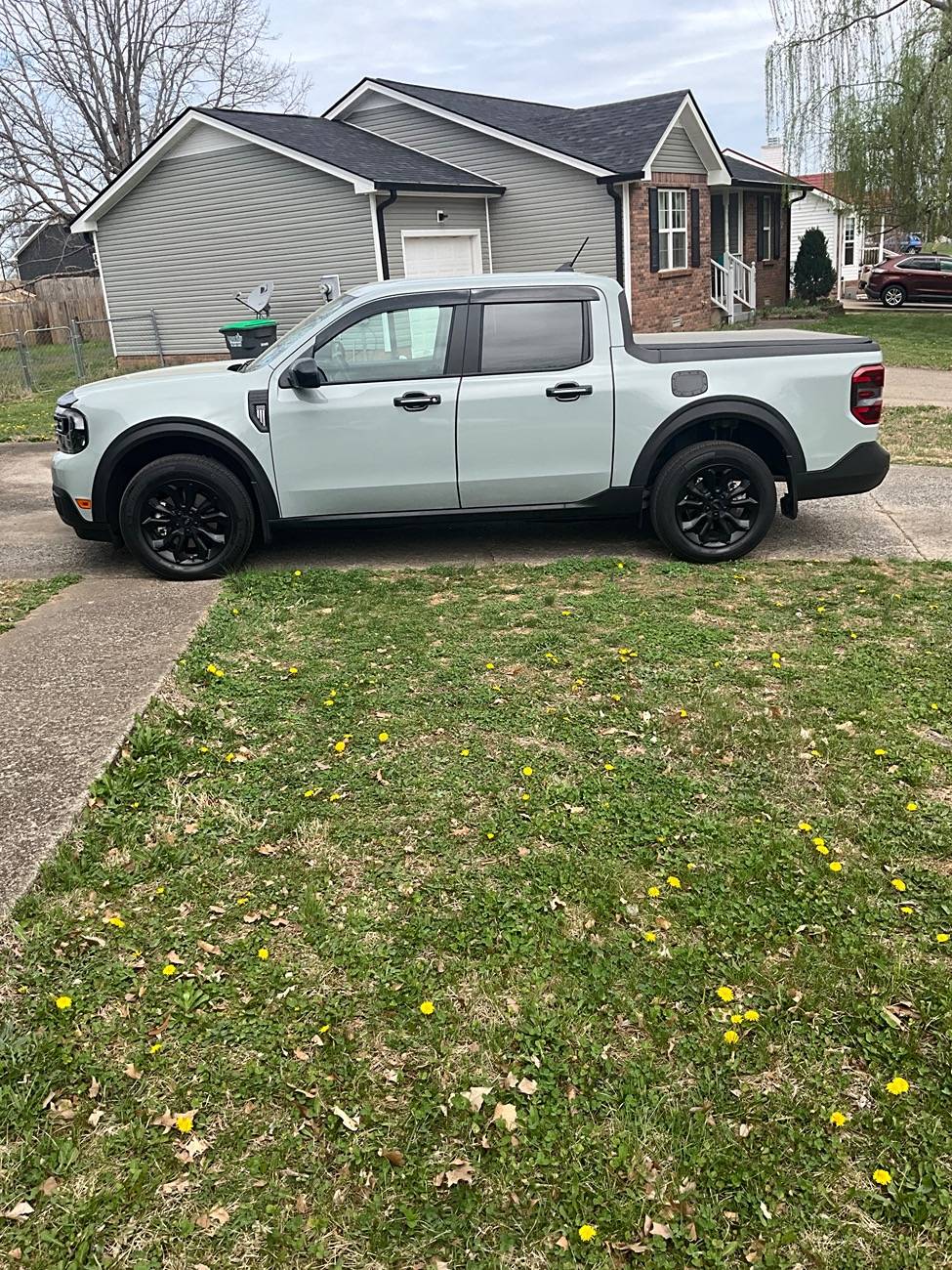

Gorilla is what I have had ford dealership put them at tire rotation didn’t cost anything and got the old ones back

Just to be clear.
You bought the black Gorilla lug nuts online?
Then you handed them to Ford when you had your tires rotated as a replacement for the OEM original chrome ones. Then Ford gave you your original lug nuts back to you?

Yes I still have them there mine I paid for them just ask for them if there is a problem ford put them on
