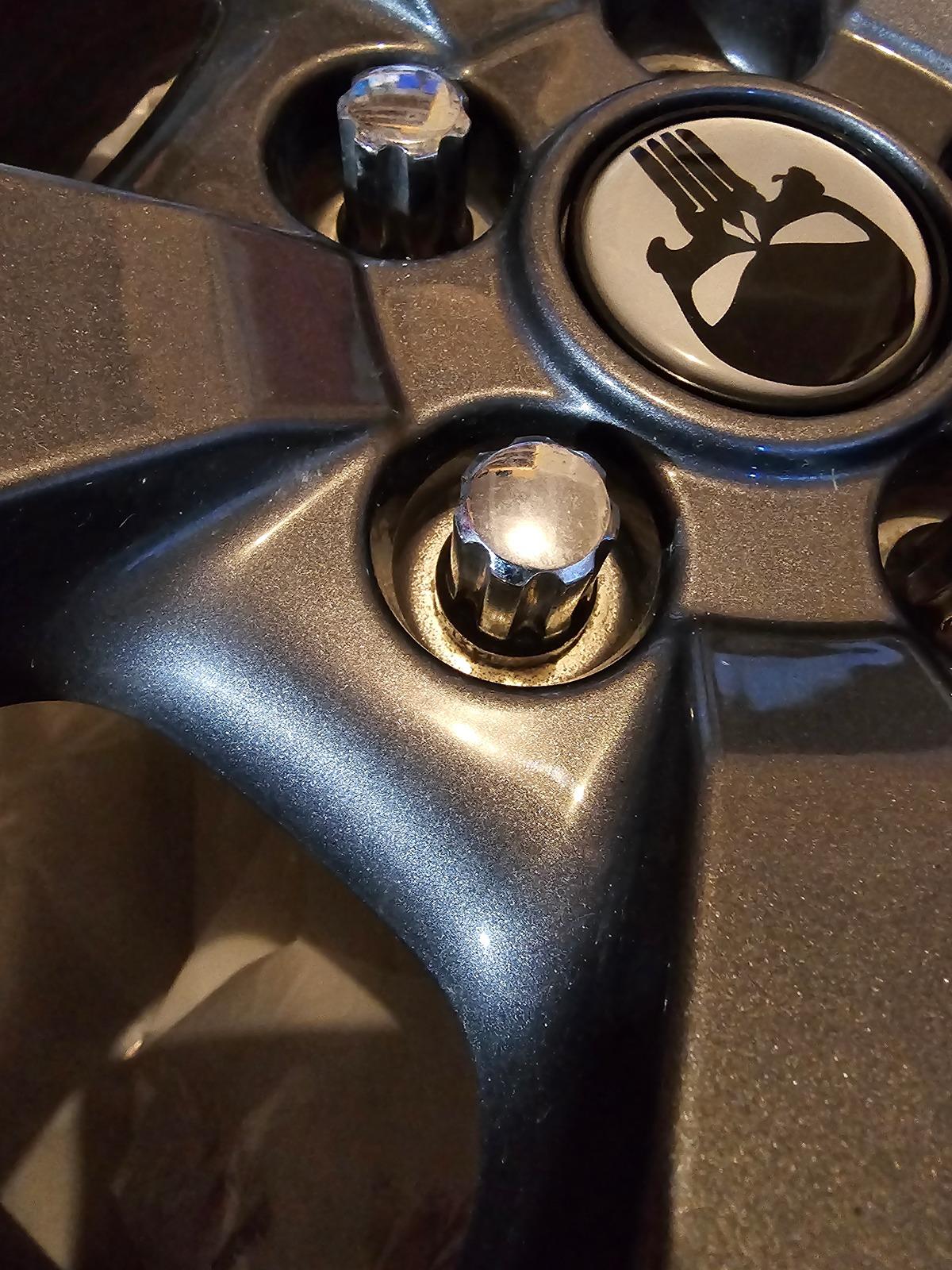

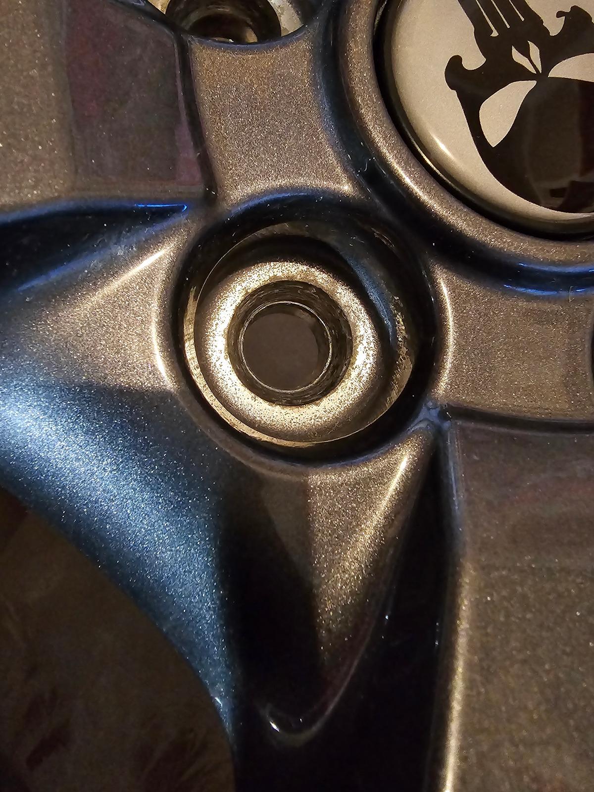

I know the steel wheels have there own following but they gotta go!
I plan to use them for the winter so it's win win.
Picked up a set of Bronco Sport Wheels

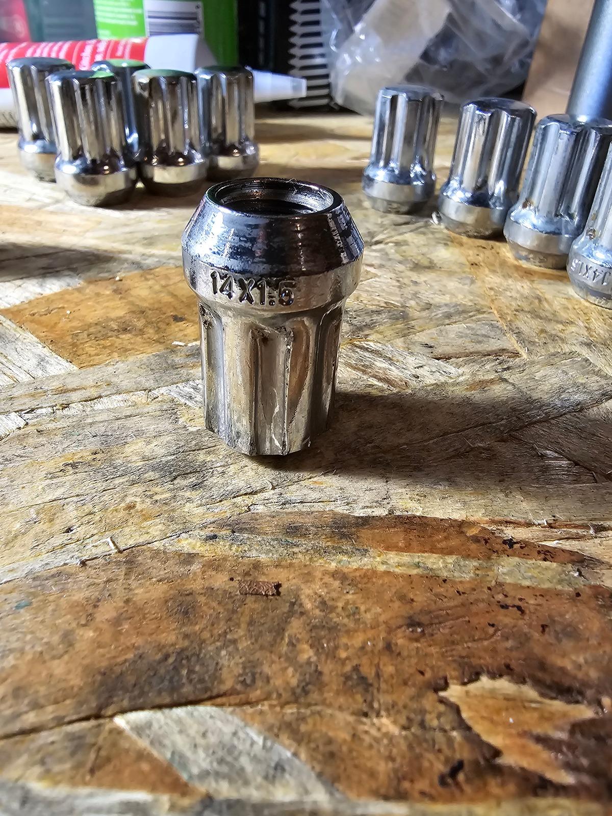

I was about to order some lugs for them but came across these in the garage from my old Charger and figured if I can use them why not
They are 14x1.5
Appreciate the help guys

Yep, they look good. You have the right threads and the same 30° seat. I like the fact that they are spline drive too.

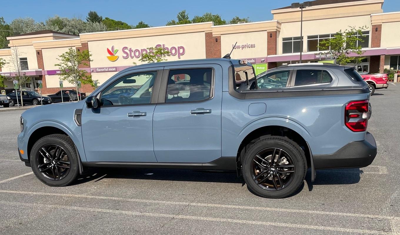

2013-2020 Ford Fusion wheels too. I had these BBS 19" wheels on my old fusion. Of course the Fusion tires are too short. I'm using 245/55R19 tires.
