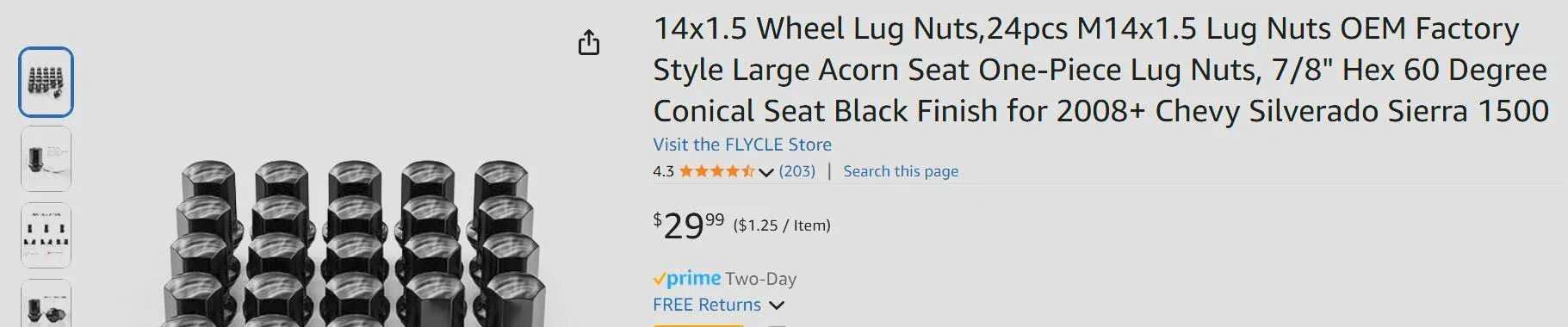

Mine is a 2025 AWD Hybrid with the 4K towing and the factory lugs are 13/16” outside hex with m14x1.5 inside threads. My factory lug wrench is also 13/16”.
If you got lugs that were too small they were probably m12 rather than m14. The m12 lug nuts are used on several Ford models that use the same bolt pattern as Mavericks (5x108)
If I had done my homework before ordering the set I did, I would have ordered these.
https://a.co/d/fqoZG0v
No, they were the right bolt / thread size, but the conical seat was too small.. could tell immediately they were not right.

M14x1.5 Large Acorn Seat Lug Nuts, 7/8" Hex 60 Degree Conical Seat
Acorn seat and conical seat are two different designs, it would be one *OR* the other, not both.
I haven't received my Mav yet but what I've read on here suggests they're conical seat ...
Well, you can thank the Amazon vendor for their awesome title.. ;)
