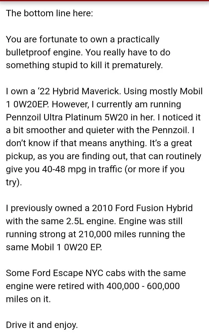

it is not the same 2.5
Other sources, including other people on this site and others are stating it's the same engine, as is the common consensus. I'm curious what your evidence to the contrary is.
Ford themselves have dubbed their hybrid systems gen 1, 1.5, 2, etc. while the engine itself is fairly true to its core there have been incremental changes to it over the years.
True, but we're on gen 4 of the coyote and basically all of the changes they made were smaller, and made the engine better. It stands to reason the same applies to the 2.5 in the maverick. I have no idea what generation of 2.5 this is, but Ford tends to make small adjustments and improvements to it's motors rather than massive engineering adjustments. So this is still a 2.5 duratec, just improved and modernized a bit.
