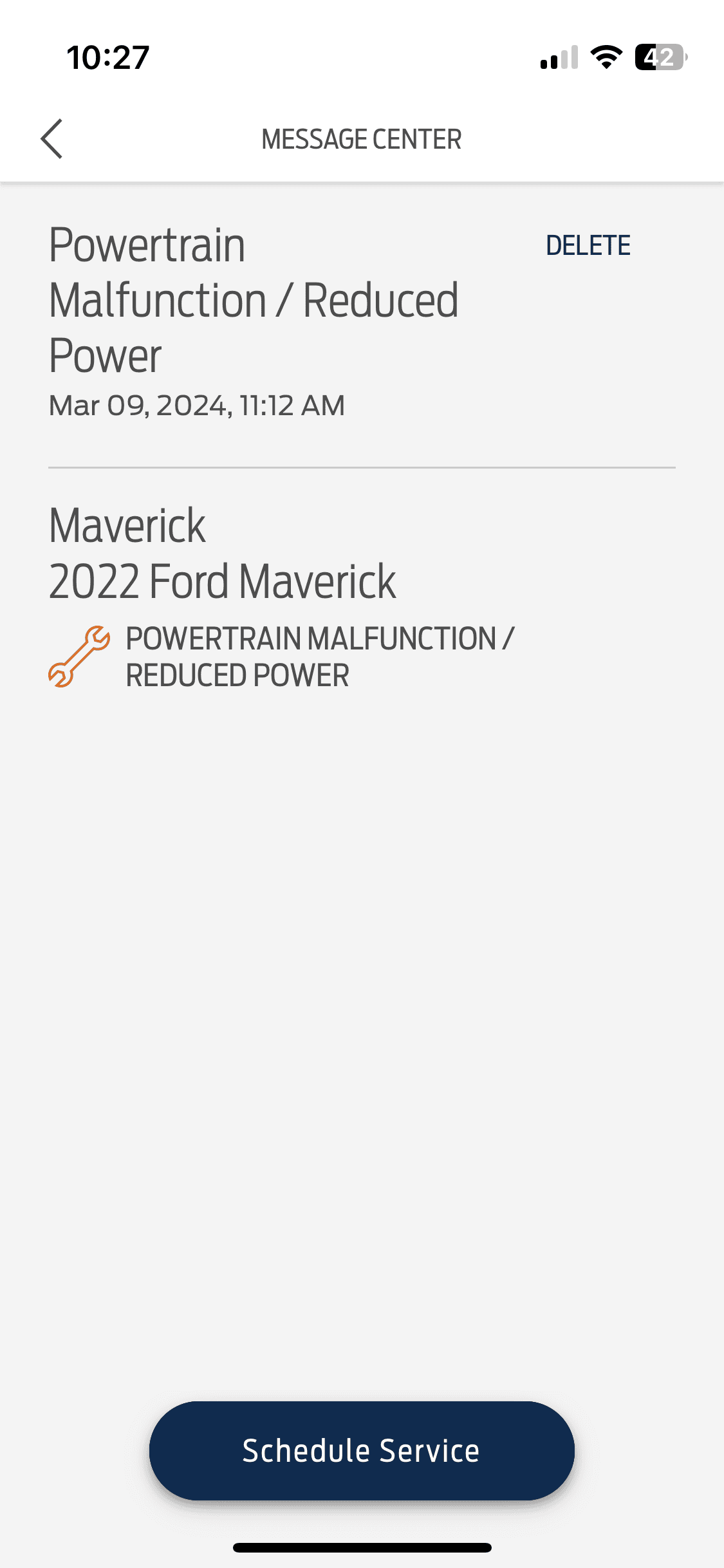

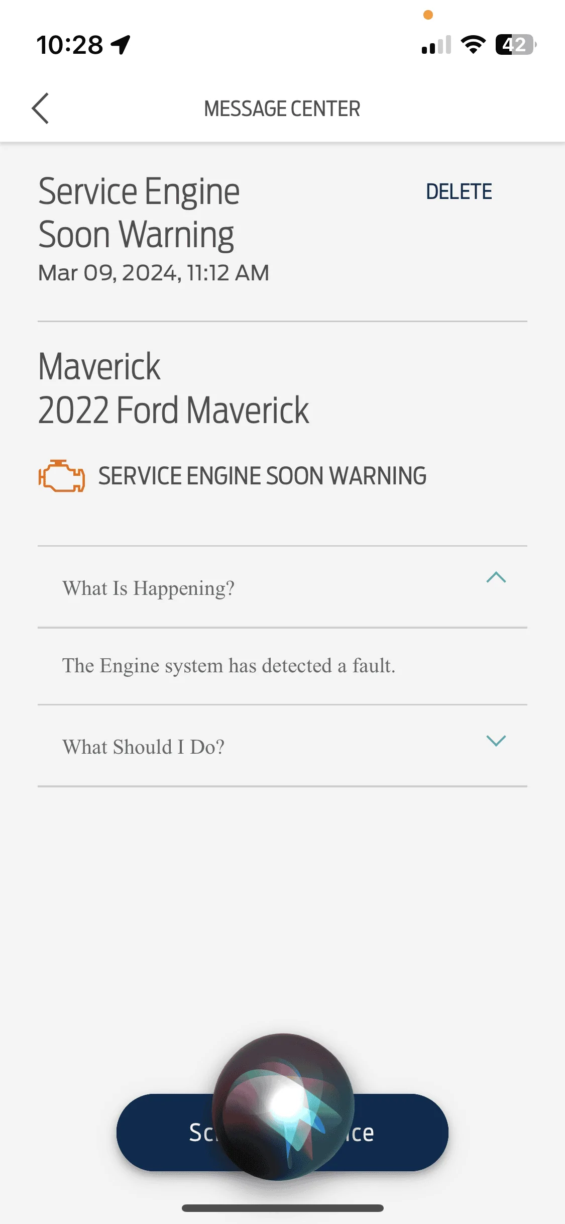

I just got a text from my dealership stating they found the issue and that it turns out to be the shifter module. Part due 4-5 days. This last time I tried to leave all the indications of the problem and hopefully all the codes remained and not in history. When I pulled over the last time I left it on and it wasn't shutoff until the tow truck driver drove it on the tow truck and then shut it off and also gave them some pictures. Whether this helped them or not I don't know. Will see if it is fixed in a week or so.

So got my truck back on Monday afternoon after they replaced the GSM and the HVAC module. Drove to and from work a day and half and the second half after pulling out of the parking lot at work got a message Service engine soon with a wrench but not all the other bells and whistles like it was on the highway the first couple of times. Drove it to the dealership and said here you go. Kept it on when I pulled in to make sure they could pull all the codes that they needed instead of history. The code said GSM again so not sure where they are going with it this time.
